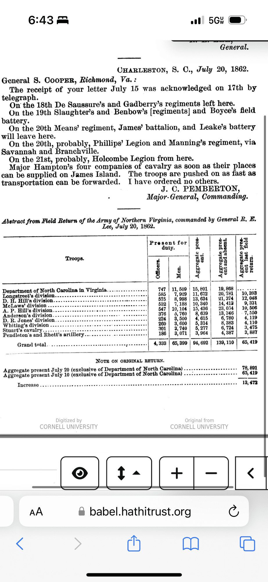

As you know, officers were included in Confederate PFD figures. Below is the July 20th return, for instance.

The War of the Rebellion : a compilation of the official records of the Union and Confederate armies. / Pub. under the direction of the ... Secretary of War ... ser.1:v.21:Operations.

Regarding Cedar Mountain, we were talking in terms of PFD strength, which would be relative to Confederate PFD strength. If what you were saying was correct, then the U.S. Army would have fielded 6,600 men at Cedar Mountain relative to the Confederate force in the same category, which is obviously not the case.
I continue to be amazed at how you slide between terms in order to obfuscate, as well. You tell us that Confederate PFD strengths were really "effective" strengths and hence we need to implement "conversions" in order to add officers, which were already included, as has been shown to you many times already. How you can take PFD returns which explicitly include officers and then tell us that they are really effective returns and consequently need to be "converted' in order to include officers, is simply astounding. The whole point of Newton was to convert actual effectives returns to PFD returns, which I object to regardless whenever it can be avoided, but you then are telling us that you want to take PFD returns and "convert" them on top yet again. It is bizarre because sometimes you cite accurate figures, but when it suits a narrative which you need to push, you seem to reverse course again and go back to this silliness regarding Confederate figures. What you are attempting to do regarding U.S. figures is simply fraudulent.
Regarding the April of '64 returns, you are simply not right, as has been shown to you above and you are not even being consistent on the issue, as I have previously discussed, as well.
