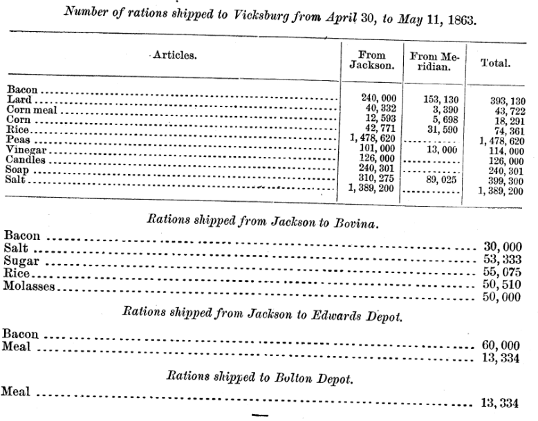

I recall reading one author, don't remember who, asserted that a Confederate depot was at Raymond and that was one of the tasks McPherson was ordered to accomplish on 5/12. But I think that author was inferring too much from Grant's order to vacuum up the supplies "there and in the vicinity" (or words to that effect). Otherwise, I've seen no other reference to a depot in Raymond. So if you have one that would explain much of it.
I've never seen any evidence that Pemberton had a supply depot established at Raymond. The OR lists rations shipped to depots nearby (corn at Bolton, corn and bacon at Edwards) And Pemberton's belated realization that Raymond was a critical defensive position belies any such foresight. Remember, Gregg's brigade wasn't the first brigade of reinforcements to arrive from elsewhere.
Pemberton makes direct mention of Raymond's depot in one of his May 10 messages to W. Adams.
Pemberton had ordered three days rations carried, implying he needed a unit with combat power that could sustain itself in the field for some time (3-4 days) and he had a right to know that his order had been complied with (or not). If he had discovered Gregg had no rations and only one days ordnance, would he have kept Gregg in Raymond?
I get that. I'm just wondering if it would matter to your analysis whether the issue of Gregg's movement without rations was resolved by the availability of Walker or presence of a depot in Raymond. We are forced to make assumptions in order to suss out the truth in some of this. It's the nature of the game. But sometimes we get caught up in weighing in on certain assumptions while ignoring others, especially if we already have a conclusion in mind that needs reaching. I'm just trying to help tighten up the reasoning process here, for I too am interested in this question that you have brought to the table. You have a great eye for spotting these things and it is refreshing. And, of course, I'm being fruitfully lazy, I guess, drawing largely off memory and just commenting here and there from the peanut gallery—which is easy to do. I do look forward to reading whatever you put together about all this. Your doing a great job!
