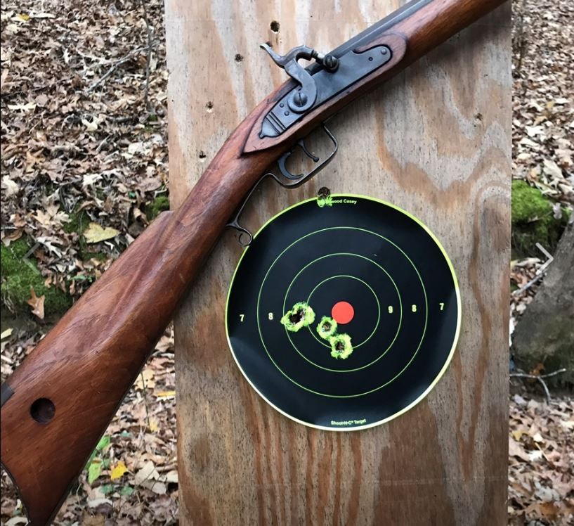

I agree. This is my experience with a .58 caliber rifle.
I bought a .58 caliber Zouave rifle off of a co-worker years ago and bought all his ammo and powder and primers. I tried a patched ball and it was extremely tight, especially after some fowling had built up. I almost had to hammer it down the barrel. The Minie' ball was much easier but I tend to believe it was too loose.
The previous owner had installed a vernier peep sight mounted further back on the wood grip. I used the production sights but never worked up a load to get a good grouping. So I just fired it to see what damage it could do. I never even really tried to get the peep sight to work.
I sold it less than a year later as it was just a waste of too much lead and too much powder with litter return on the fun of shooting it. I recently had the opportunity to purchase another one at an estate sale but I didn't even think about it.
Instead, I bought this Dixie Gun Works .50 caliber long rifle. It isn't pretty---which makes me think it was a kit build --- but it is fun to shoot.

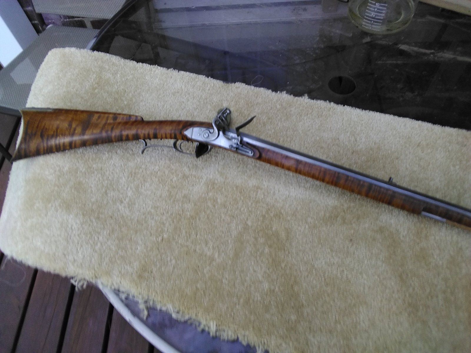

Here's a picture of the rifle I put together from a Jim Kilbler kit.
It's a copy of a southern mountain rifle made in the early half of the 19th century by a N. C. Gunmaker by the name of Bean.
46 inch, .36 caliber swampted barrel, and all iron furniture, which I supposed to be more historically accurate, I should have browned, but I thought the gun would be too dark if I did. The stock is Tiger-striped maple, and is a little lighter in color than what the picture shows. Again, to be more historically correct, the stock should be more dark, and of very plain wood. These were working man's guns with nothing fancy to raise the price.
I hunted for years with a rifle I put together from a CVA kit. I even have a revolver I built from a kit. They are not that hard if you take your time and they will be as historically accurate as you make them.

That looks like the Dixie Gun Works mountain rifle . I bought one in .32 cal. flintlock years ago for small game . Mine is a very good shooter but the small caliber means the bore fowls more quickly .
To keep this meandering topic in the direction of the ACW, I will say that the old Dixie Tenn. Mountain Rifle, among other things, is representative of the civilian rifles that were carried by many Confederate militia troops in the early days of the ACW. As for the Dixie Tenn. rifle being accurate to shoot, you bet it is! It was actually made for Dixie in Japan by the famous arms manufacturer Miroku. The Miroku arms company also made reproductions of Civil War Springfields, which are highly valued today for their accuracy not only in shooting, but overall appearance.

I've seen and held @Booner's rifle when it was in pieces in an open box and after he completed it. He didn't need to do any inletting, but he did choose to polish the barrel flats and he had to drill some pin holes. He finished the stock from raw maple, too. He did just as good a job as the photo suggests! My point here is that you can probably build a fun shooter from a kit and you can probably find lots of instructional video on youtube which will help you. I built a flintlock pistol kit decades ago. Some of these kit firearms are simpler than others and some will produce a finer looking piece than others, but all are fun. If you follow instructions, I believe you can make a safe shooter and have lots of fun in the process.

I have a .36 caliber, 44-inch long barrel. I don't worry about fowling but then I do try to swab it after every 2nd or 3rd shot.
I never consider fowling as being a factor of the caliber. What type powder do you shoot? After some testing, I shoot Pyrodex Pistol powder in my small caliber rifle.
