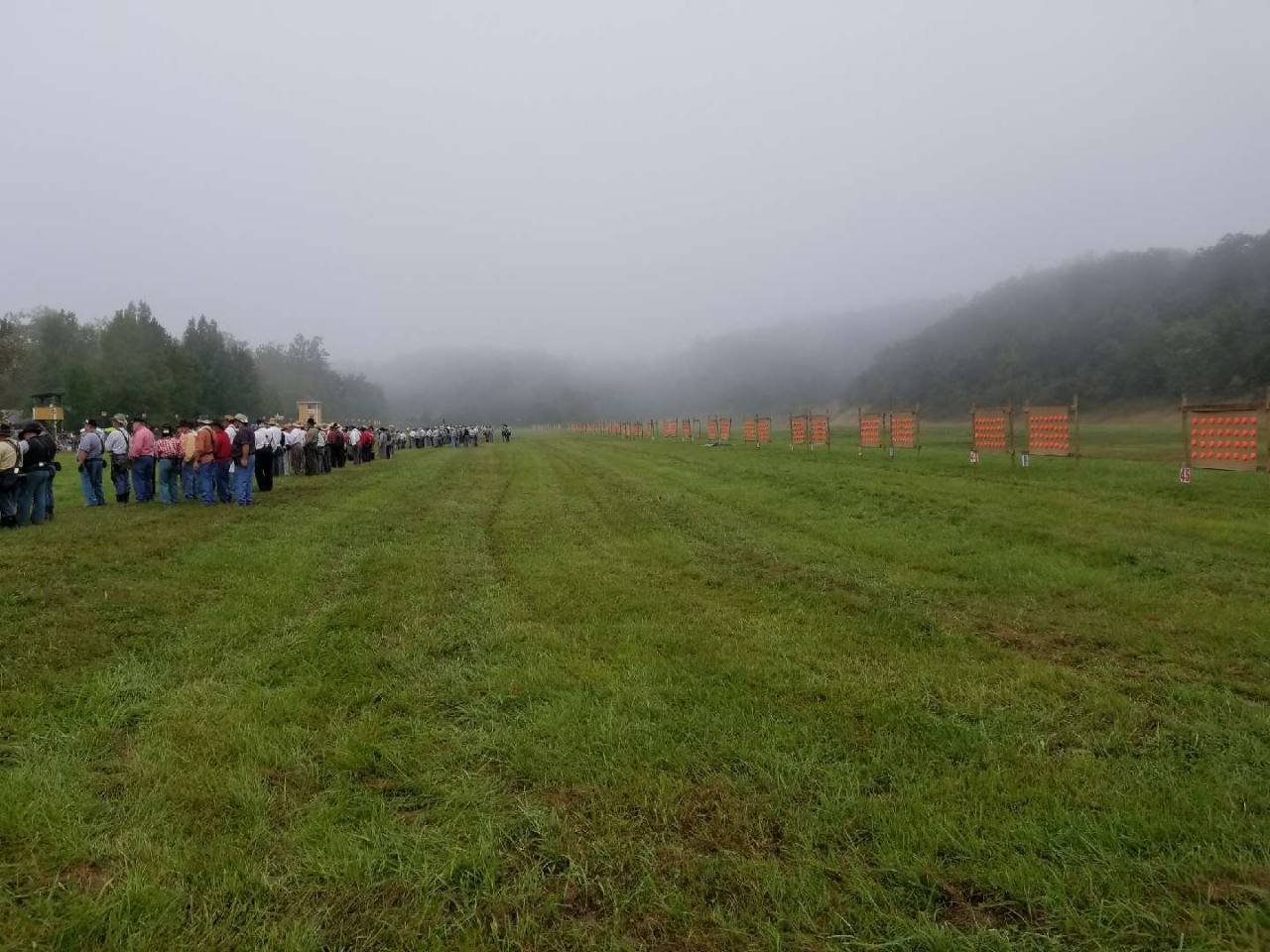

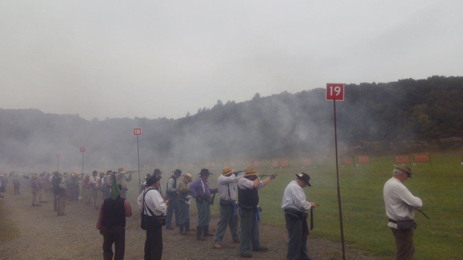

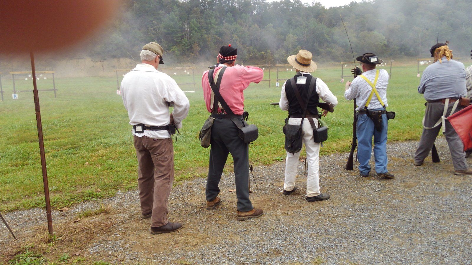

JP- I'm with the Palmetto Sharpshooters. Smoothbore match today!
While I'm not a fan of Lee molds, they did have a pretty good knockoff of the Rapine trash can. It shoots great in my musketoon and Parker Hale. I got it off a junk table at Nationals and wanted a spare after I found how good it shoots in my guns BUT Lee has discontinued it.
Nice!!!! Would love to be up there with my '42!!! Have fun!!! Perfect weather for skirmishing, quiet and still, no wind/rain/ bright sunshine/hot humid conditions today and tomorrow. Sunday may be back in the 80's and sunny. Post some pics when you get a chance!!!!
