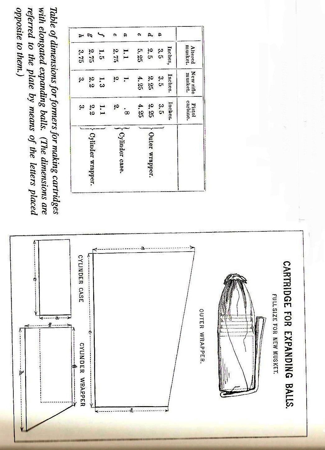

Post number 3 I give instructions, here is the template size per regulations...

Awesome, I missed that post in my searching, I will get some cardstock today. What about lube, am I overthinking it? I use 50% beeswax 40% crisco and 10% lanolin in my trapdoor, I'm just worried about it leeching into the paper over months.

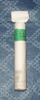

What are you using for a forming rod? I found (since I have no machining equipment) I could take a 1/2" wood dowel, wrap typing paper around it till I get whatever diameter I need to form cartridges. (See photos of a .69 forming rod I was developing.) I have one I formed up 15 years ago, still use it today!
