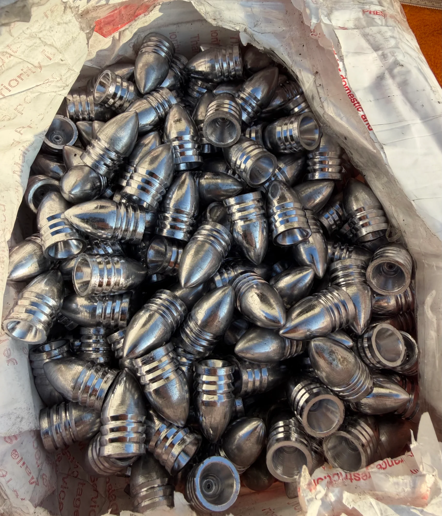

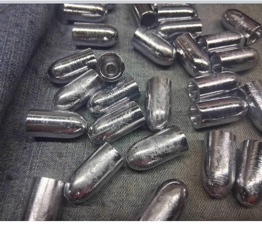

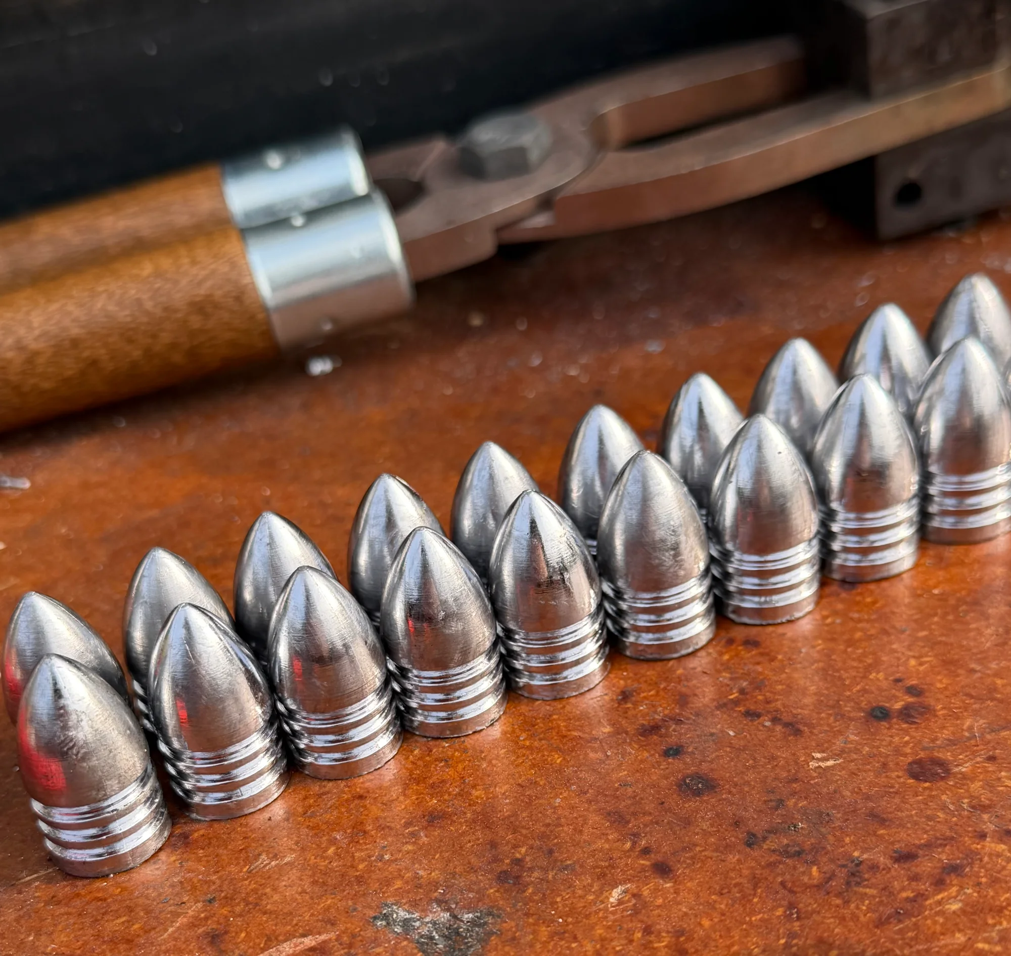

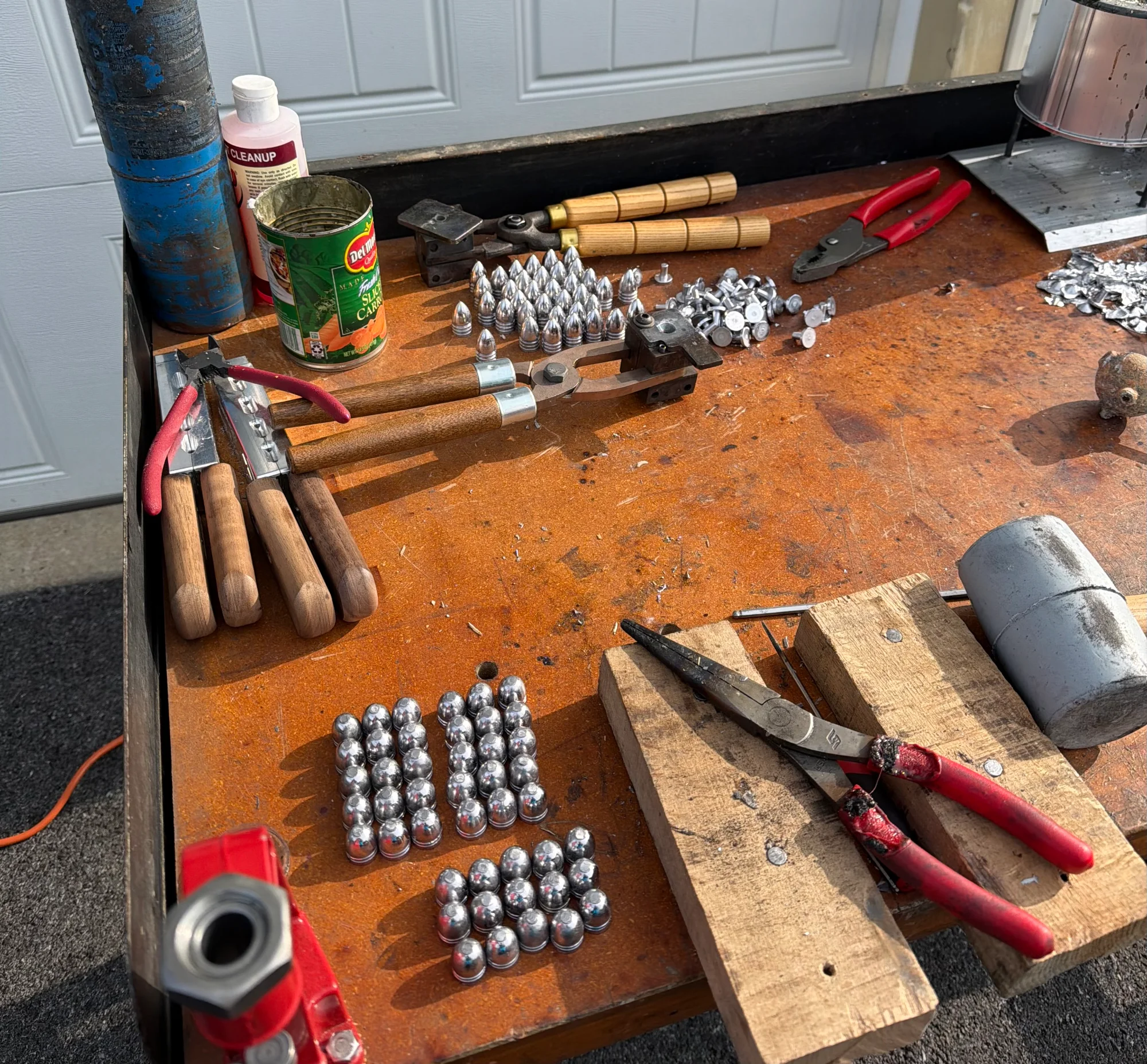

Making some confederate .5778 teats and .574 Williams type 3 today cannot wait for my mold to arrive so I can make Gardner bullets!!
Nice looking bullets. Casting is one of my favorite pastimes. Whose molds are you using? What alloy are you using for casting the Williams' bases? Are you using zinc washers with them ?
Brooks molds and I use a hard lead for the plunger works just as good as zinc plus zinc is too expensive
The hard lead is just mixed with tin I have it special mixed to match the consistency too zinc

Always cast 2-3 thousandths of a inch below bore size and smoke the inside of your mold with a lighter
You have to keep your lead at 900-1000 degrease and keep your mold hot
