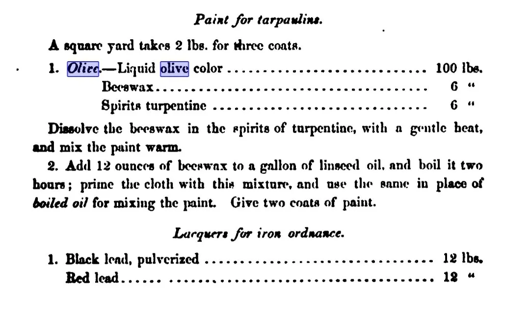

Again not entirely what your asking but here is the recipe for era correct (1864) Olive paint. Stenciling is also discussed in the regulation. Link below.

That's awesome! As much as I strive for accuracy I cannot mix these in my apartment. I was hoping to find a Behr or SW paint that matches. So far I have:
Behr Cavalry Brown N220-7d
Sherman Williams Garden Path SW2929
