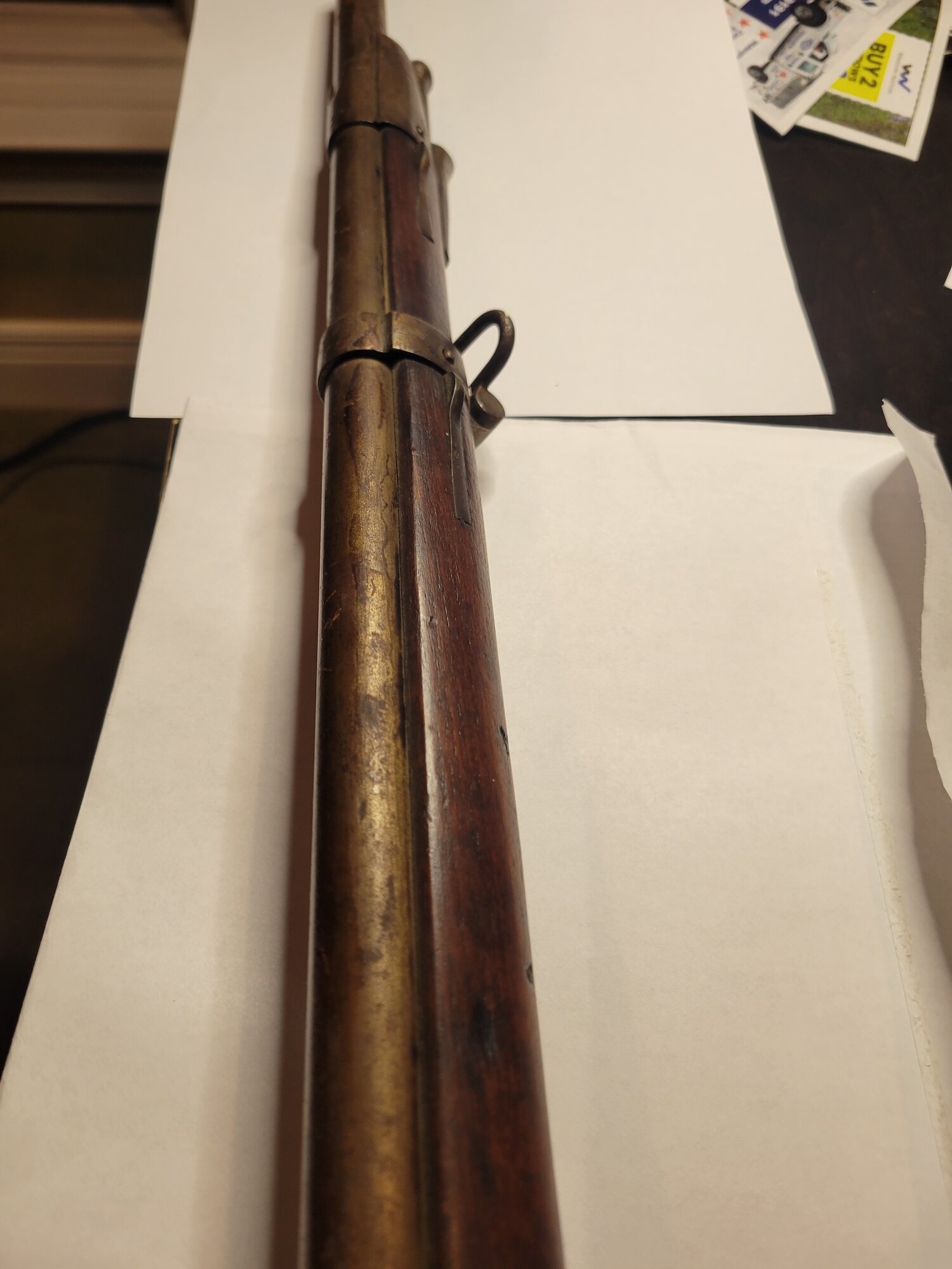

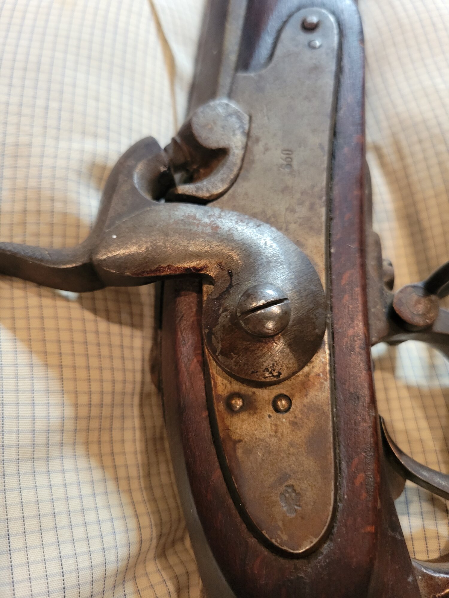

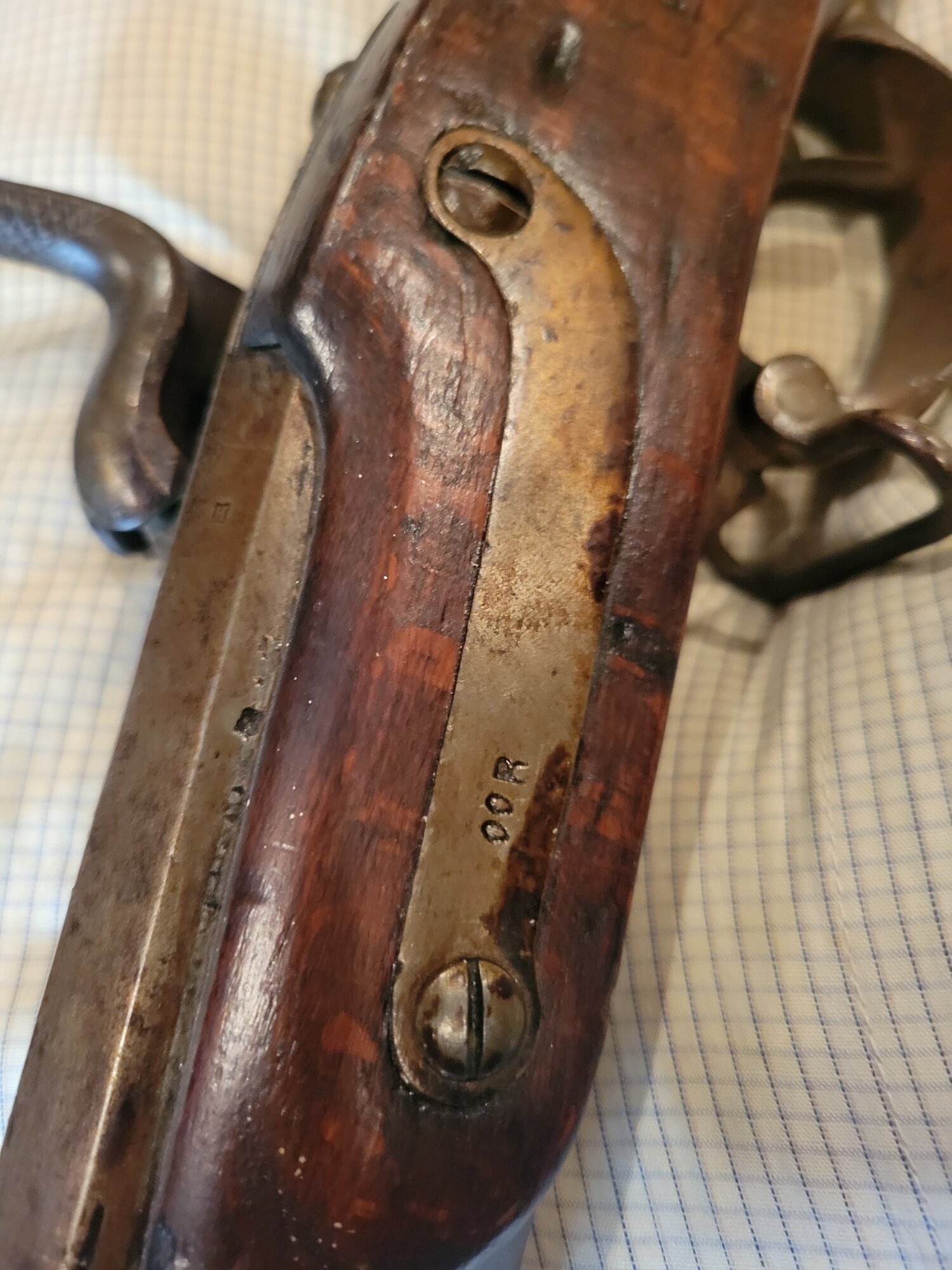

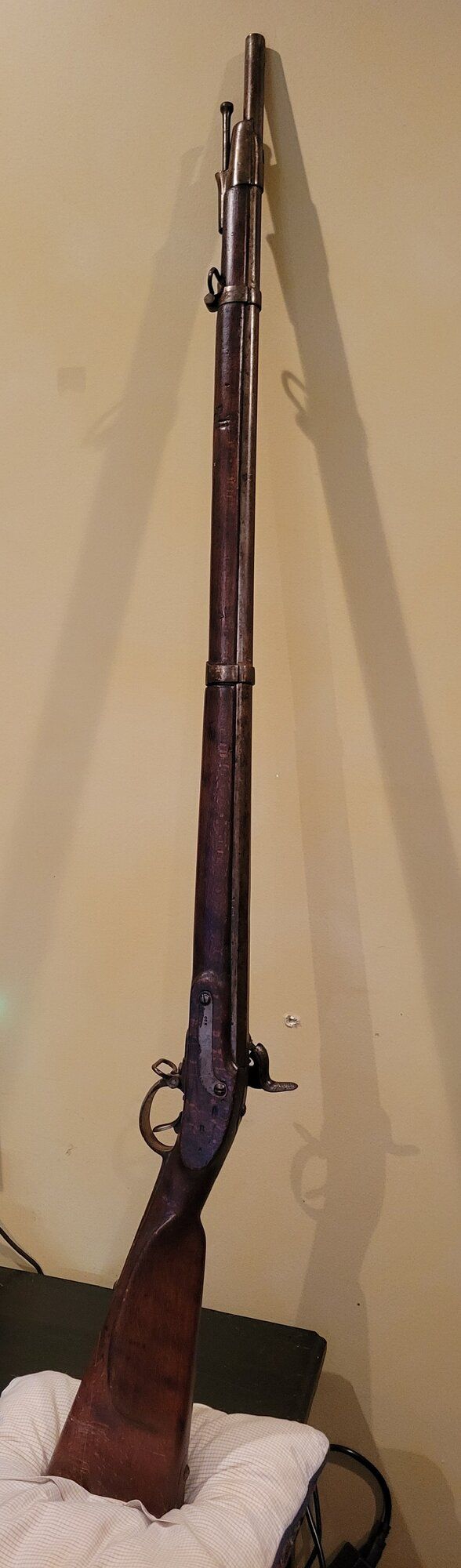

I acquired an 1854 Lorenz from an online auction. It appears someone tried to stain it and the stain is also on the metal parts of the rifle as well. I only wanted it for display purposes. But as far as value goes. Is it better to just leave it or should I try to remove the stain from the metal or have the entire rifle redone? I paid $600 for it.
Altering any civil war piece lowers its value but it's already been altered with new stain so I think it would be ok to clean the metal part. If not, the metal and stained area will age differently than the rest of the parts. Pictures will help to see just how much restoration was done.

I don't think it's been restained, I think someone covered the whole gun with a shellac or laquer at some point. It could be BLO too. You'd have to proceed with caution while removing it so as not to remove any patina that might be under it. Whatever you do don't make the metal shiney again! The stock doesn't look too bad from the pics.
The lock is dated 1860, gives you an idea when it was manufactured. Does it have a fixed rear sight, or a folding one? Does it have a cheekpiece? This will determine if it's a Type 1 or Type 2, and if it was Austrian military, or made for export. It's a nice looking gun.
I'd wipe it down with some Kramers Best and leave it alone.

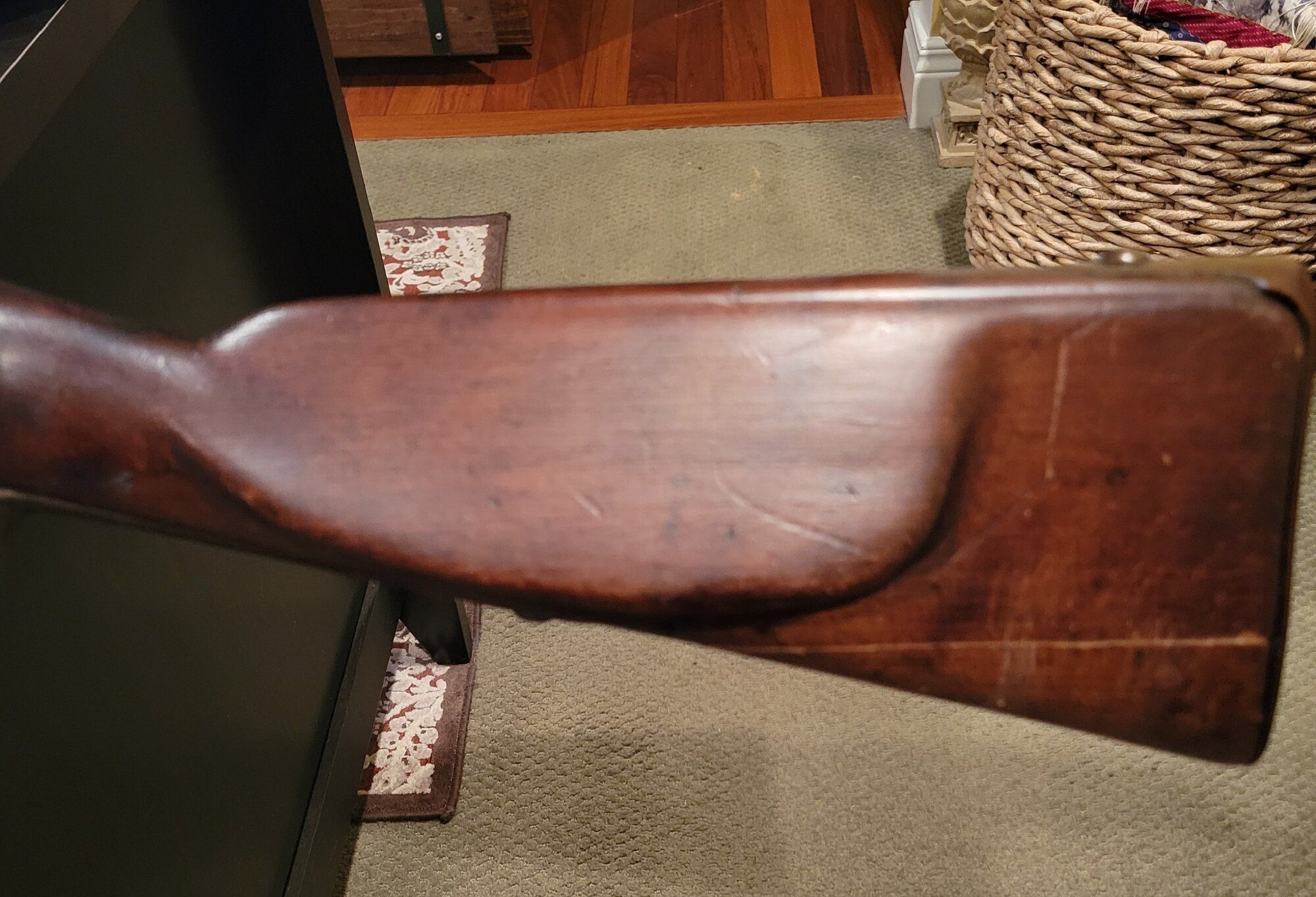

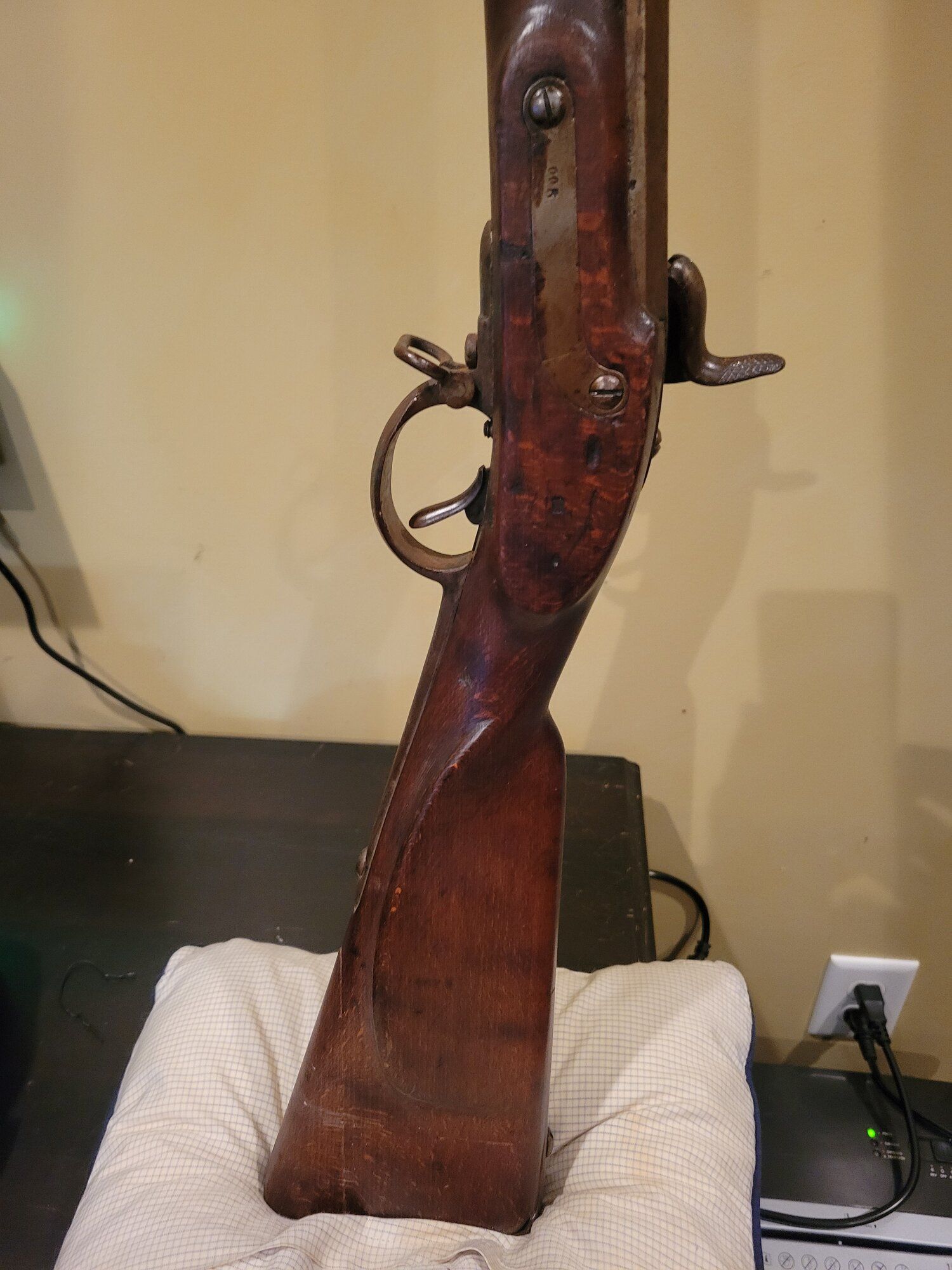

It has no rear or front sight or front for that matter. Here are 3 more pictures. As you can see its also cracked where the screw went into Butt Plate.

Has the dovetail been filled in for the rear sight? Is it rifled still? Really if it's just gonna be a display piece, I'd get the appropriate ramrod and like scooter748driver said, hit it with some Kramer's and hang her up. It's not a bad example, but incorrect ramrod and no sights will effect its value. As will the removal of the rifling which was commonly done after the war when these guns were sold off as surplus. Originally it was Austrian military.

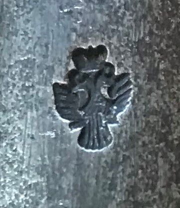

Your musket was a Muster 1854 System Lorenz rifle musket. The Austrian Kaiser's double headed eagle on the lockplate ["bird"] is an Austrian Army [k.k. Army] acceptance - not inspection - stamp. K.K. Army weapons are liberally marked with assembly and inpection markings, but there is no known crib sheet for them. I don't see a k.k. Army unit mark on your limited photographs. The cheek piece on the left buttstock indicates that it was manufactured to k.k. Army standards, so I wouldn't necessarily be surprised if it was sold to the Federals or Confederates from k.k. Army war reserve stocks. The ramrod is not a k.k. Army ramrod. Cracking in the European red beech used in the stocks of these guns is common as the wood aged.
Since it is missing its sights, I can't tell if it was a Type I [block rear sight] or Type II [flip-up long range rear sight] variant. It was sold as surplus after the Civil War and transformed into a fowling piece [i.e., it was bored smooth, the sights were removed, and the rear sight slot was filled]. The saving grace was that the "sporterization" was fairly minimal, since often the stock and barrel were also shortened in transformation.
What to do with it? At this point it has no value to a knowledgeable collector as a Civil War or k.k. Army weapon, although it is worth more as parts than what you paid for it if you elected to part it out. You can clean it up, get a proper ramrod [good reproductions are available for less than $100], and hang it on the wall. Or, you can restore it as a shooter. I'm a shooter, so I would probably have the barrel relined to .58 caliber. Bobby Hoyt is one of the folks who does that type of work. He can also put a correct, although taller front sight on it, and I would see if he could remove the filler from the rear sight slot. Original Type I rear sights are available, as are good reproduction Type II rear sights.
Have fun with it.
Regards,
Don Dixon
I concur with previous comments and since this will most likely be an attractive wall hanger, I would very carefully take the weapon apart, being especially aware of not buggering the slots in screws. There are many tricks to loosening screws that are stubborn and patience is a virtue and key. I will oil the offending screw and let sit, then cloaking the screw driver head with a thick cloth work it loose. What you think of as stain is most likely a heavy lacquer/ varnish and would remove from metal parts with the appropriate light stripping agent. I would not go beyond that as the patina is what helps to make the piece more attractive as a wall hanger. Do not use any abrasives on the metal, let the stripper work and wipe clean with a soft cloth. You may get a little ambitious and strip the wood, but that is a bit more involved and may be best to leave as is.
I have two of these, both CS attributed and as Don has explained this wood tends to dry and crack. Another anomaly I have found with this weapon or run of weapons, was a casting/boring flaw where lead would build up about 1/2-3/4 down the barrel rendering the weapon ineffective. I can only make this statement through personal observation of five such weapons, one in my possession attributed to the 12th VA another found on the field of Williamsburg and three where I put the rammer down the barrel at various gunshows. My 12th VA piece actually had the lock partially blown out as a result of the back pressure created by the protrusion and the subsequent lead build up. I keep promising myself to have the barrel X-Rayed to see what may be there.
You have done very well and have a nice displayable piece.
