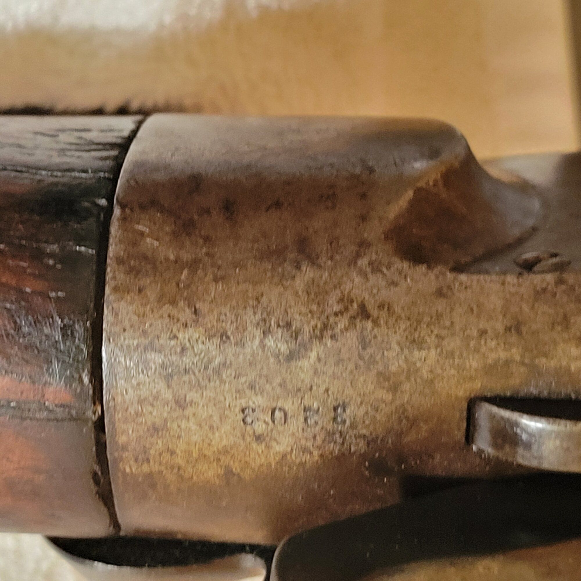

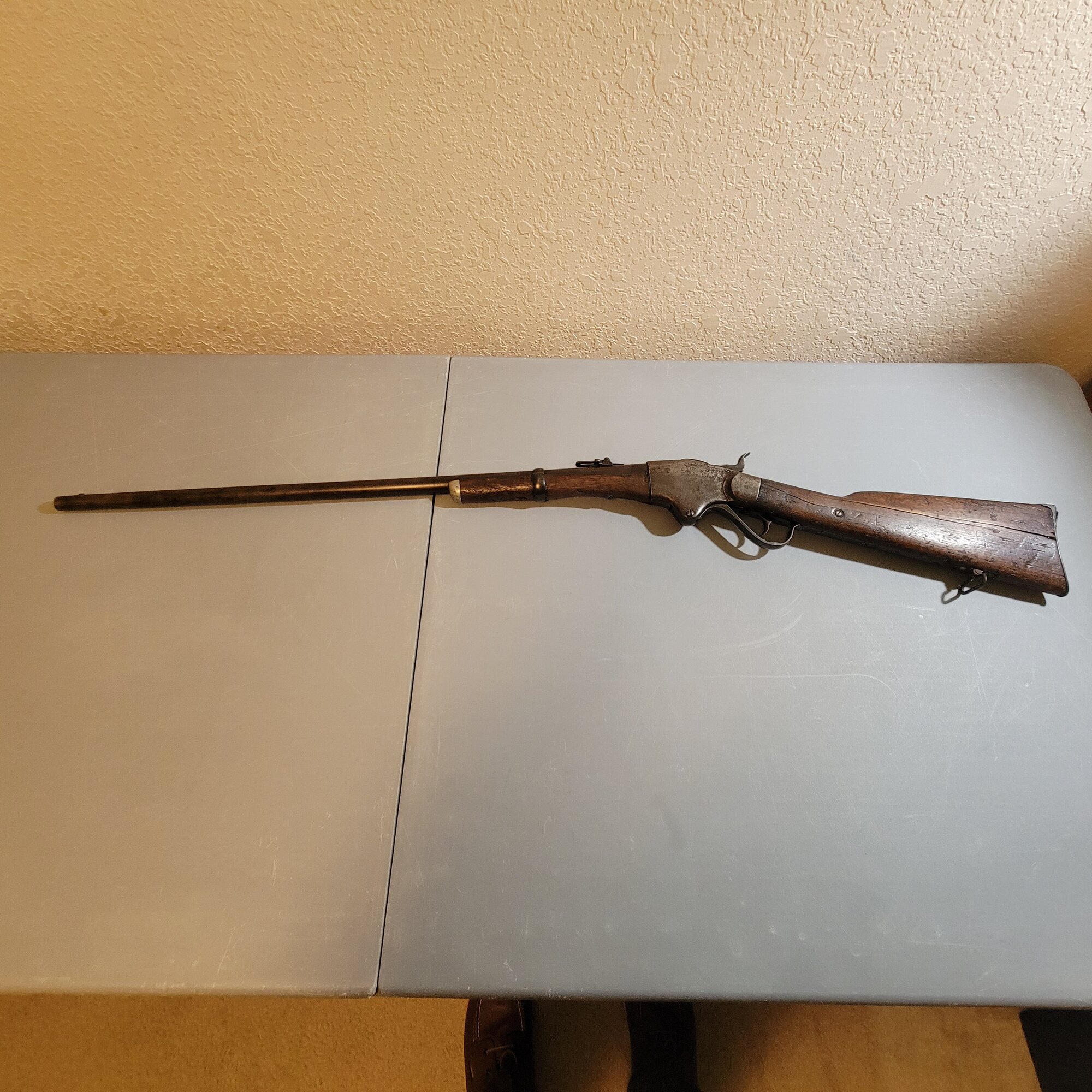

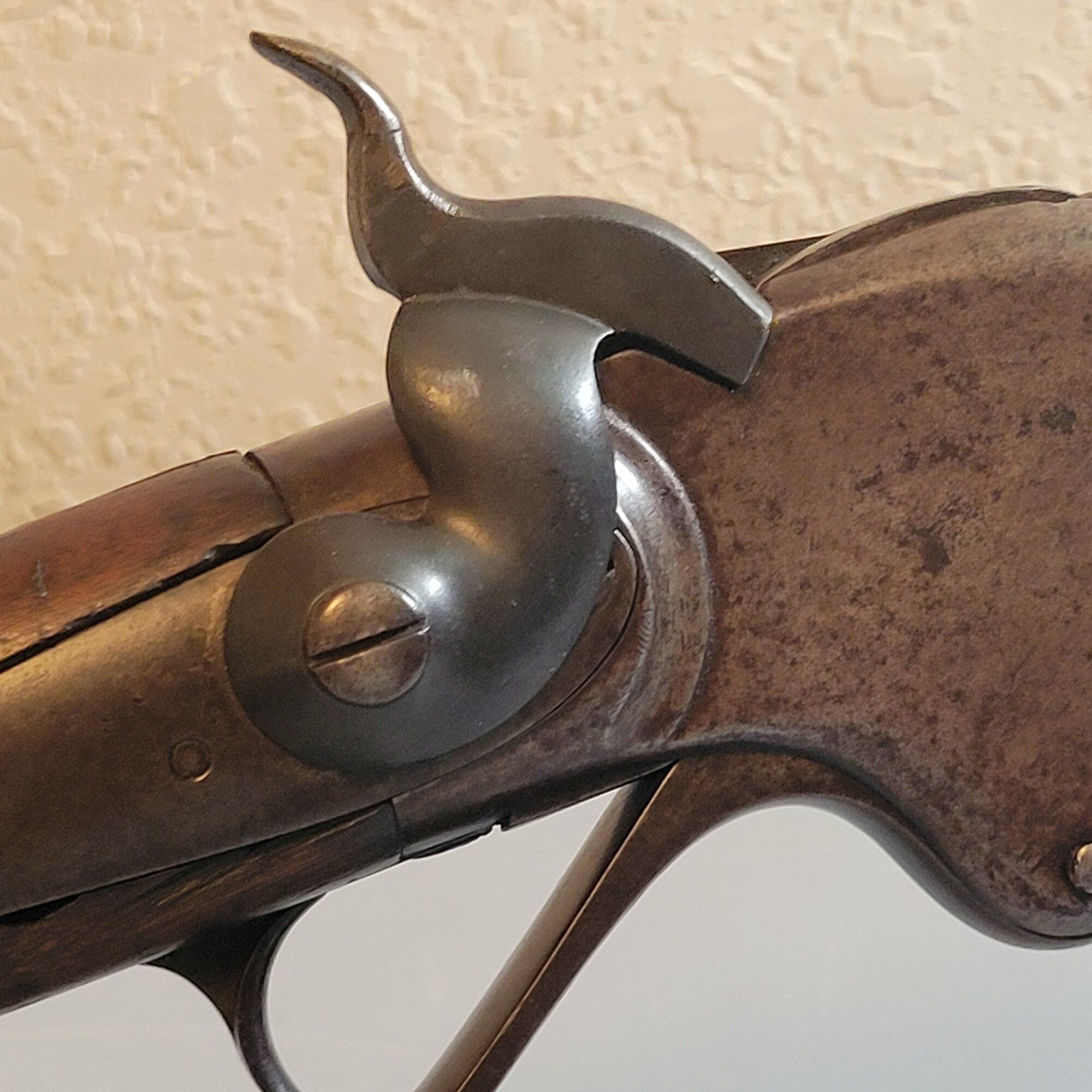

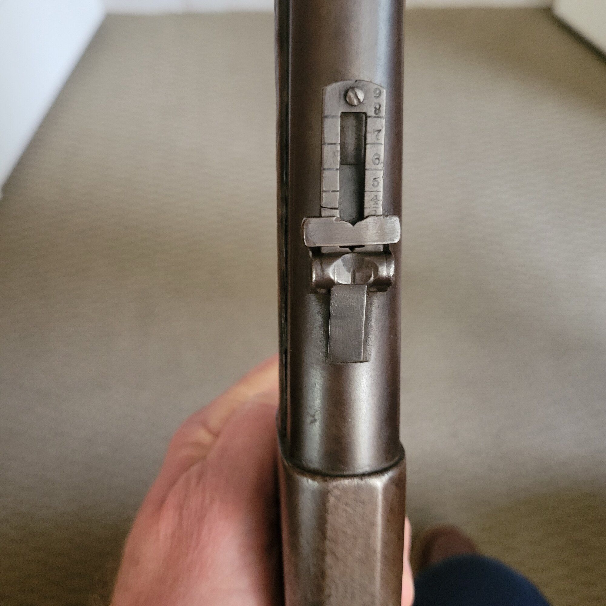

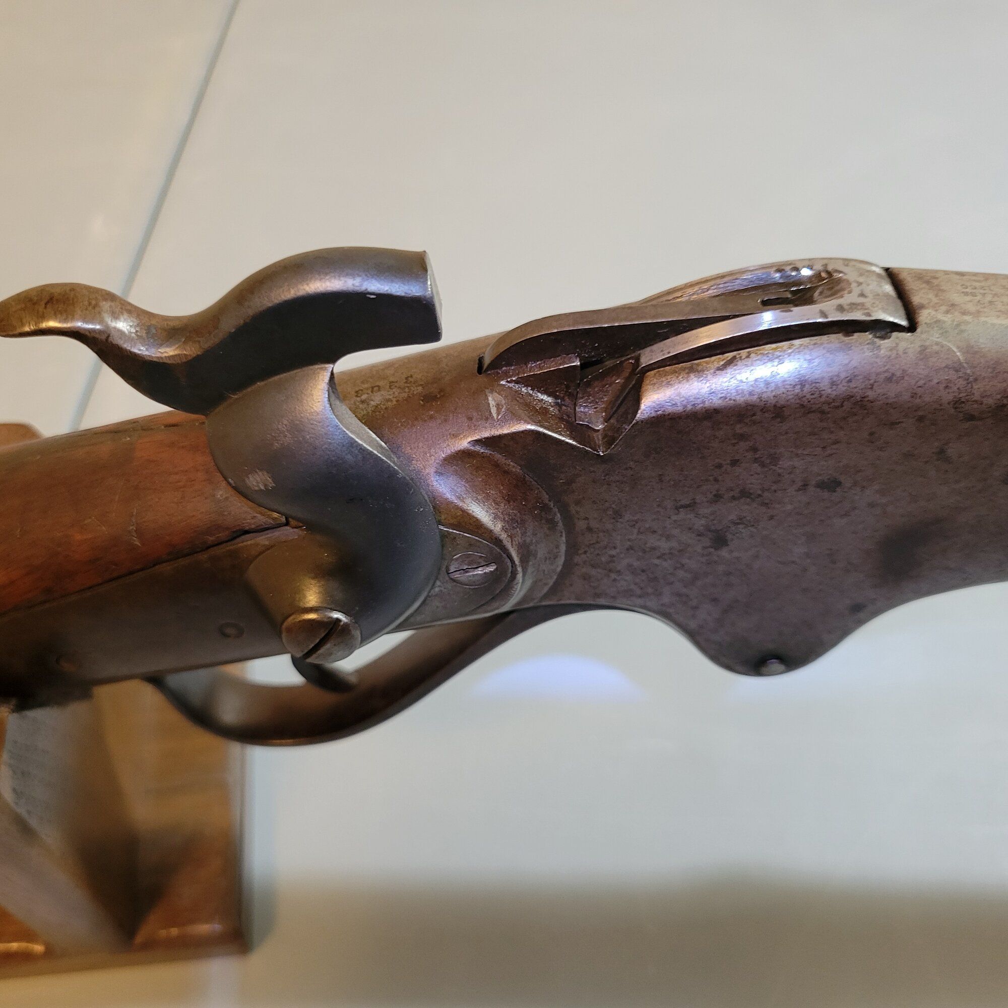

Howdy! Just joined the forum and interested in learning more about a gun my father passed down to me. It is a Spencer rifle, and there are no inspection or cartouche marks to be found anywhere. It is a Spencer, not a Burnside, and the serial number is 3203. I read that some of the early Spencers were purchased by the solders themselves. Any suggestions on how I could find some historical references to this firearm?
There's some great saddle wear to that forestock!

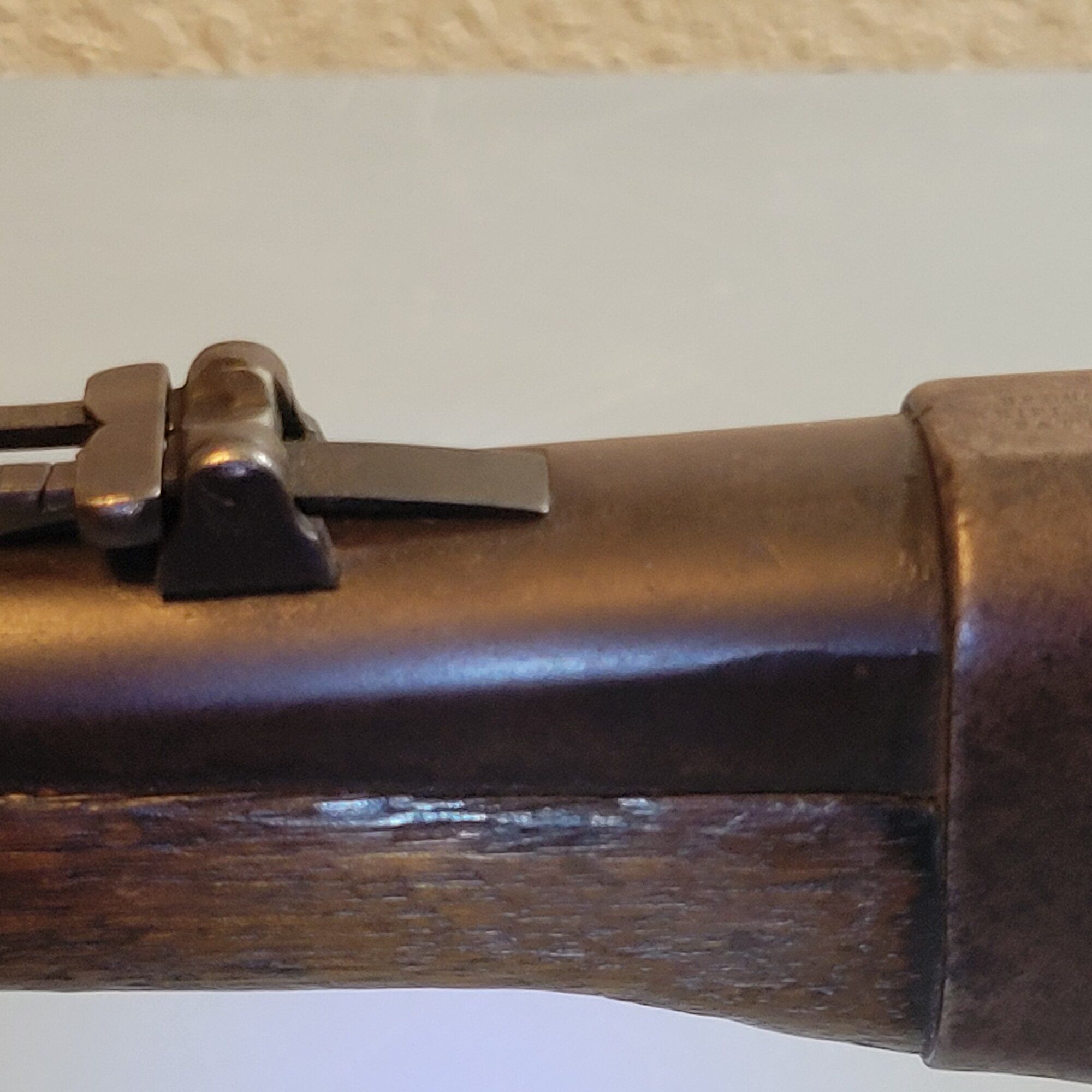

That said, the rear sight is a Model 1865 sight and not a Model 1860 sight.
There are three Spencer Models with serial 3023 ( the Model 1860, the Model 1865 and the Burnside Model 1865) and if you want to identity what model you have, lots more photos would be a start to identification.
It is difficult to know how much of this was changed or modified over the years, but lots of photos might get you some good info. The parts of these various models interchange and these Spencers were used for decades after the War and the users modified them to suit their wishes and they used what parts they had available to keep them in working order!

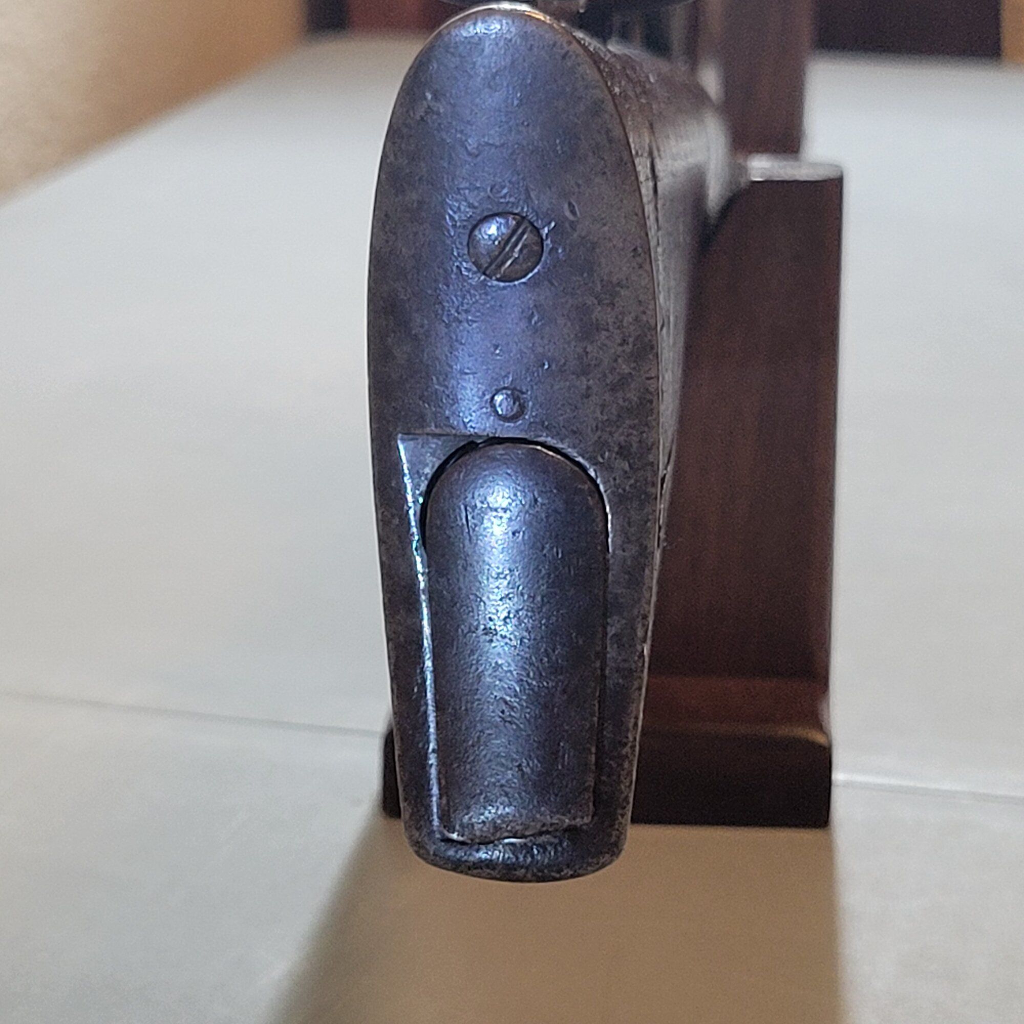

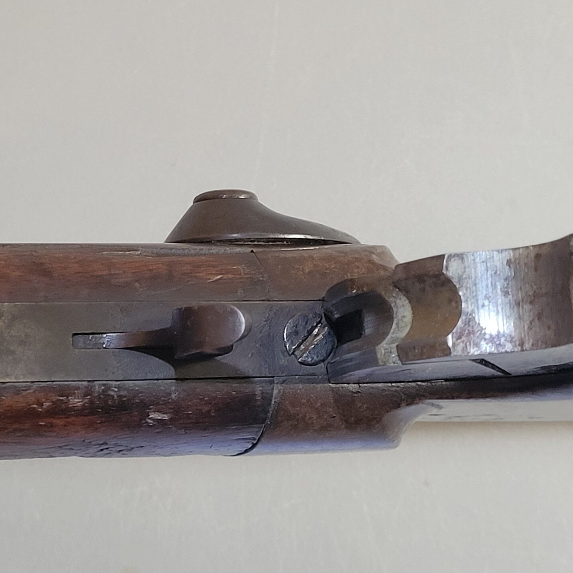

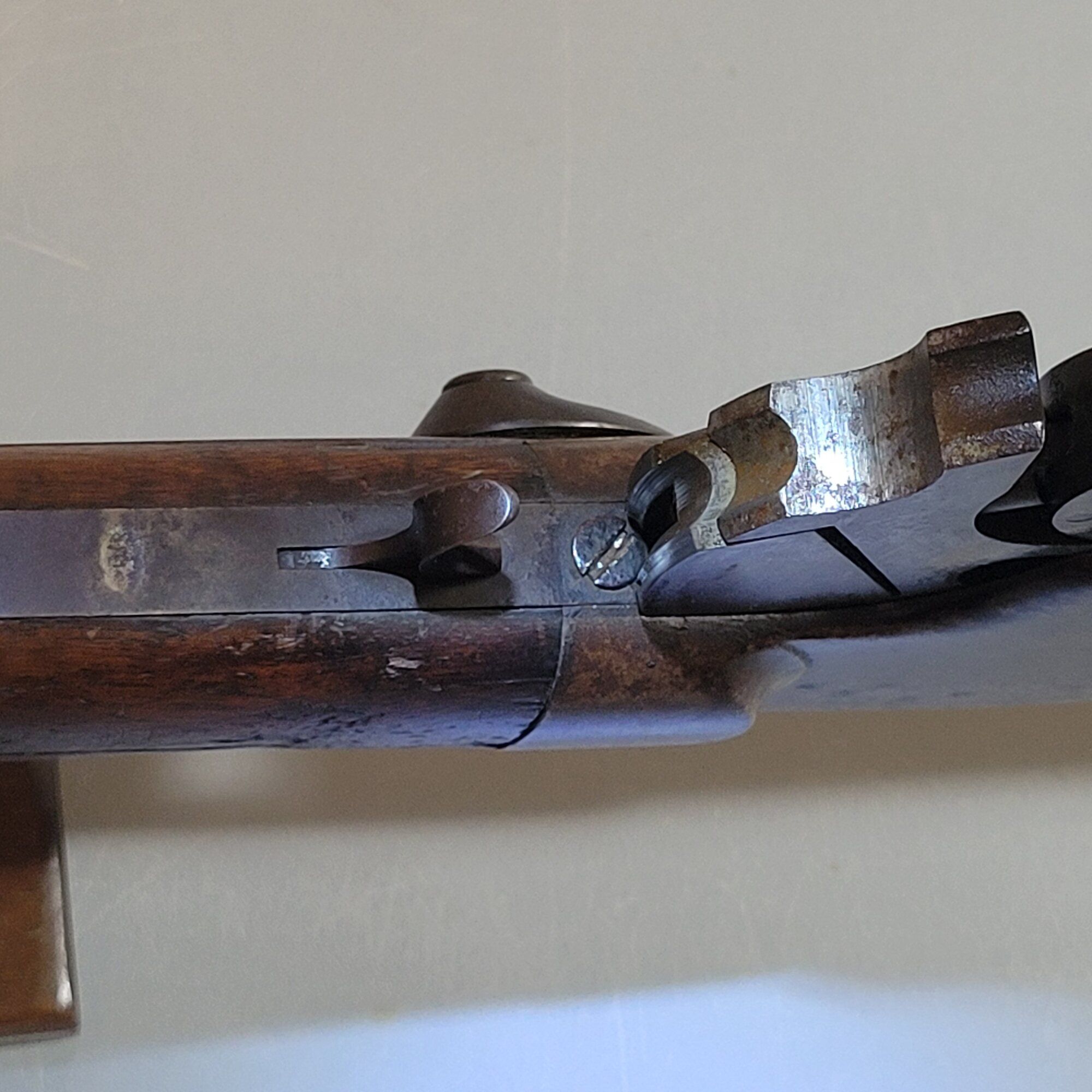

Since it is a Spencer Rifle that appears to have the front stock cut down (too bad as that hurts the value to collectors) for that serial number I think we only have 2 options, the Model 1860 and Model 1865 rifles. The other rifles would have higher serial numbers according to Flayderman. If a Model 1860 it would have been issued early enough to have possibly seen considerable action in the Civil War. If a Model 1865 it would have seen no Civil War use. Photos of the top of the barrel where it meets the receiver, of the hammer where it meets the receiver, of the magazine cover in the butt stock, and the area in front of the trigger would be most helpful in identifying which model it is.

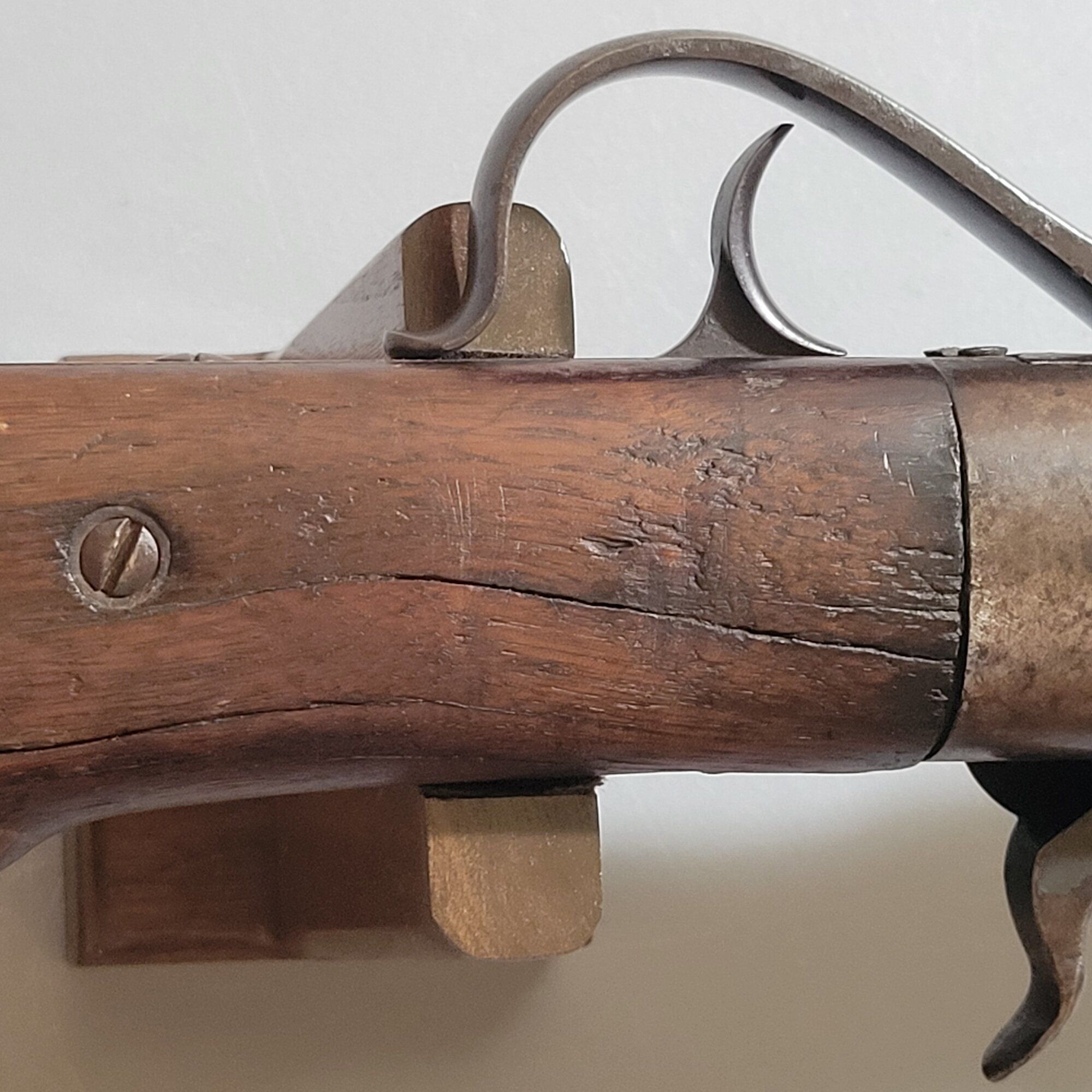

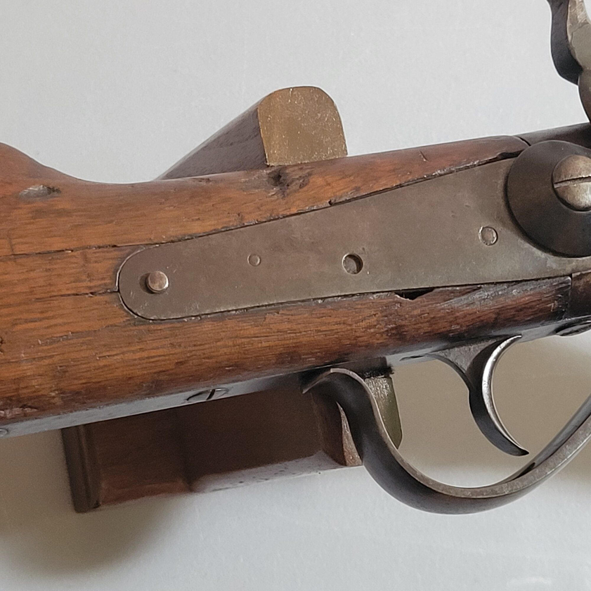

The cartouche would be on the left side of the wrist above the trigger guard. It's likely worn. These were very heavily used so to me one in stellar condition is a warning sign.

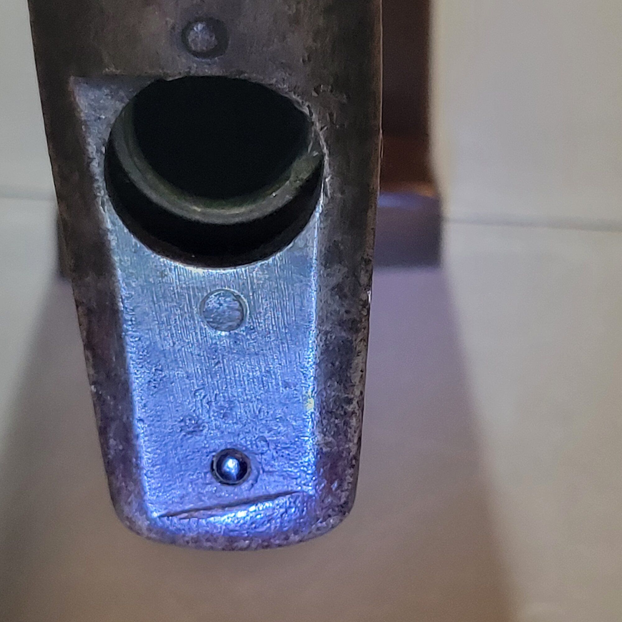

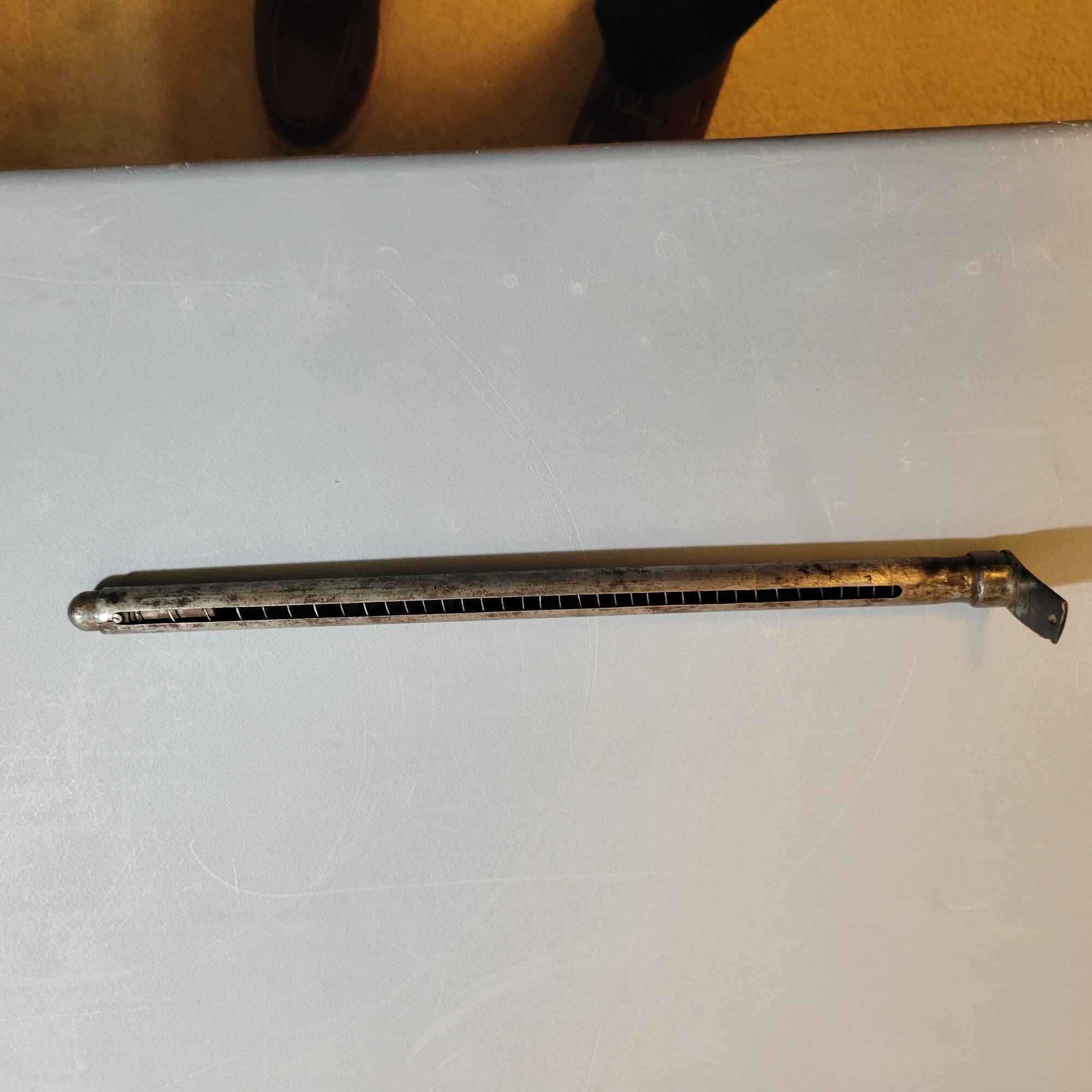

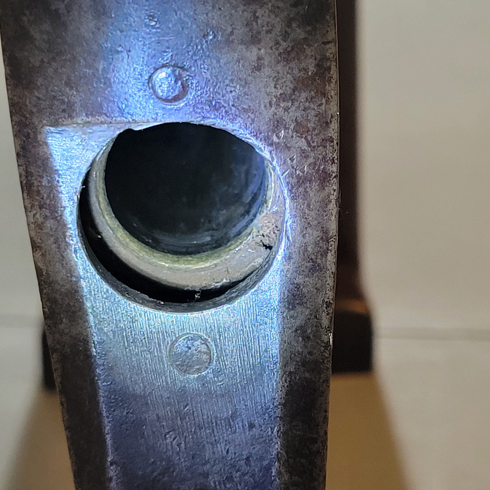

Remove the magazine follower and look at the tube inside the stock, if it's Brass you indeed have an early one. If not she's a little later manufacture. Mine is S/N 2787.

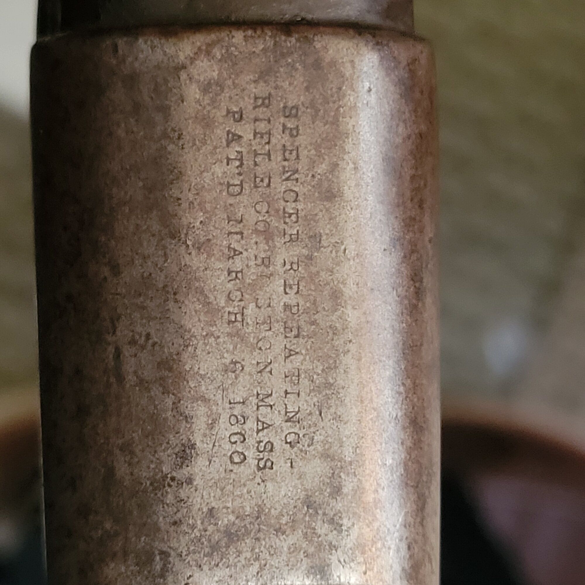

I shot some more pictures and it is an 1860 Spencer. Looked high and low and could not find any inspection or cartouches, the gun has definitely seen some wear and tear. Attached are the latest pics. I did take a look at the tube inside the stock and you can still see that brass color.

Your gun is not listed in the SRS database. The closest listed serial numbers on either side are 3183 and 3213, both issued to Co B 9th Michigan Cavalry. This does does not mean that yours also was issued to them, as the first Spencer rifle listed to Co B 9th Michigan Cavalry is serial number 2288. That's a range of almost a thousand guns, so most of them went elsewhere, we just don't know where.
Sad a victim of a lot of Spencers, a long crack in the buttstock. Had one many years ago I got for $1000. Thanks to Ken Burns ACW special coming out I sold it for $2000. Not too shabby. Heard a Rev War documentary by him is coming out in November. Hope Rev War items sky rocket in $. Wife wants me to rid myself of many of them items.
Thank you for checking the serial number. I had my hopes up that there might be a way to track it to a company, battalion or regiment but I had heard the records could be pretty difficult to trace. This information does seem to confirm that it was smack in the number range of rifles from the early days of Spencers being issued to the field. And how it ended up out on the Great Plains in the Dakotas is another mystery that will not be solved. I am speculating that it may have taken its fair share of buffalo in that country as well.
