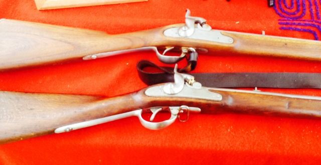

I attended a small reenactment in Temple, Texas this past weekend. I had a table set up to peddle my Civil War novels and had my reproduction Austrian Lorenz musket laid on the table as a "hook" to attract spectators to stop and chat.
A fellow walked up with a musket, which I quickly recognized as looking like mine that was on the table. He passed it to me and said it was an original Austrian Lorenz and was looking to sell it for $1,500.
I handled it and laid it next to my reproduction model on the table. At ten feet they look the same, at five feet only a sharp-eye would pick up the variances. At three feet I could note this detail and that detail as being different.
So, here's your test: Which one is the real 160 year old musket and which is the 7 year old reproduction?

Who made your repo?
No trick question. The bottom one is the original. I posted the photo just because I was surprised and pleased at how close the reproduction appears next to the original. Thanks to you guys who tossed out a reply.
The most immediate giveaway from any distance is the so-called "handle" or wrist of the gun stock. The Loyalist reproduction made that area of the stock too long and thin, the original Lorenz is noticeably shorter through the area where the comb meets the wrist. It's one of the problems with attempts at defarbing the Loyalist M1854 Lorenz...you can take wood away but how do you add it where it needs to be?
For what it's worth, I don't know anything about rifles/muskets. The two guns looked quite different, so it was mostly a matter of figuring out which matched an original. I googled images of original Lorenzes and immediately saw that the hammer going straight up and the pointed angle on the trigger guard were the original.
