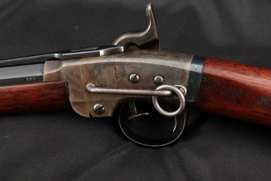

I can't claim to be an expert on Smith's, but have been collecting for a long time and nothing about this jumps out at me as being wrong.
The wood is quite proud of the metal, and the letters have excellent edges, so no evidence of sanding. The letters in the middle of the address are somewhat weak, but the ones around the outside are strong so I tend to think it more likely to be due to a poor strike, or weak die rather than recent polishing. I understand why you think it looks too new, but I have seen any number of old guns that were never used and have been well cared for that look like this.
I would bet that someone here will know the dealer. That would be key to me. If it is someone with good credibility and the experience to judge the gun, then I think it is an excellent example. Having it in hand is usually worth a lot more than photos.
This gun looks like it never saw any action. Actually looks TOO good.

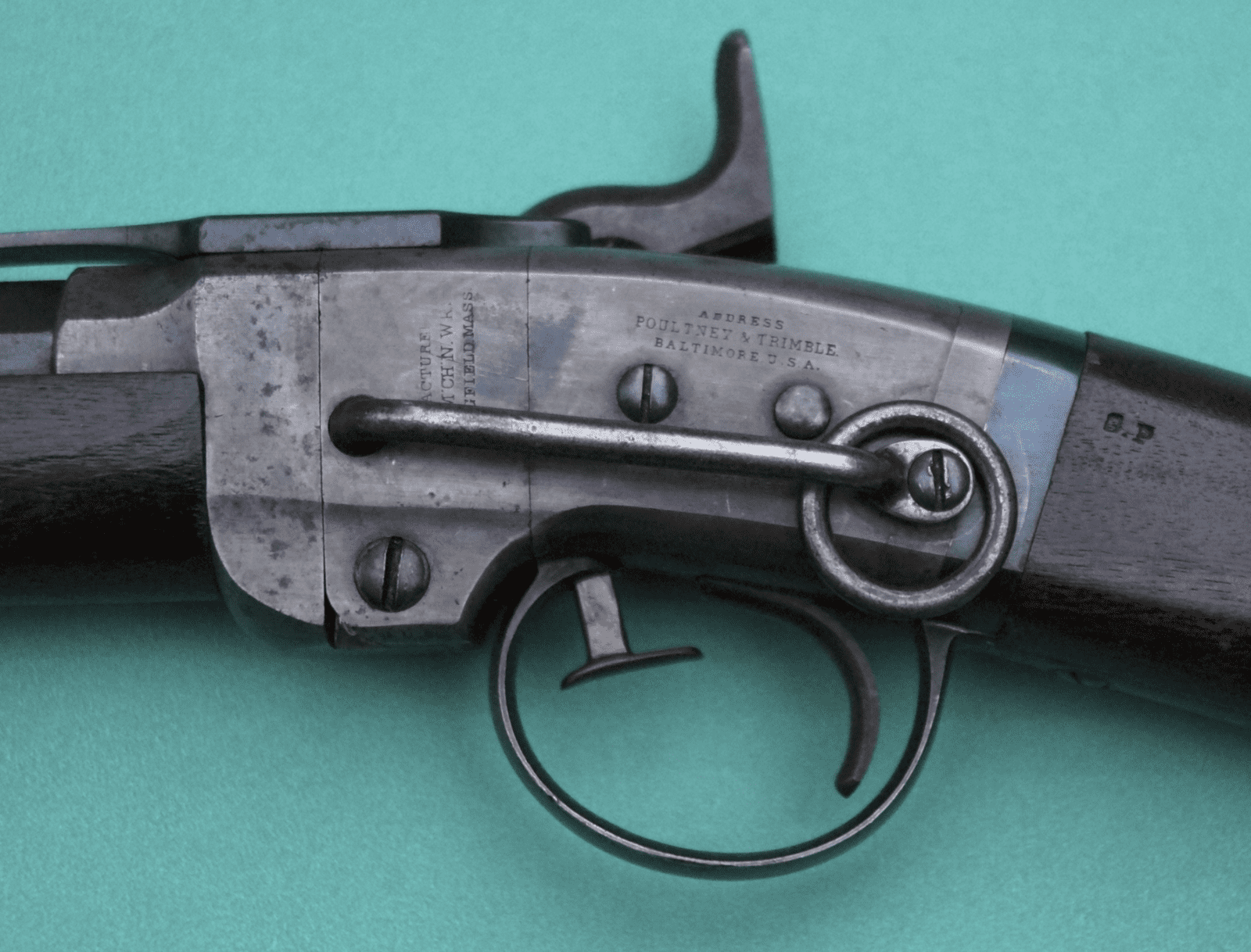

The full serial number for this Smith carbine is 4443. See photo. Any additional comments/info would be appreciated.
GP are the initials attributed to George Palmer. I wold not classify it it as not seeing action. See attached
Was George palmer an inspector? What rifle are you showing here? Below is a photo of the GP stamp on the rifle I am interested in. So, you think the rifle I am interested in, did indeed see action? The early serial number (4443) would support that assumption.

George Palmer was an inspector. In looking at the photos I don't see many dents, dings and bumps you would see on an issued cavalry carbine. They took a beating and there should be wear on the sling ring.

I guess I'm confused. At first, I thought you said the following about the gun I'm I interested in. ...."I would not classify it it as not seeing action". Now you seem to say that you don't see dents, dings and bumps, implying that you don't believe it saw action. Help me out. Which is it?
ucvrelics,
That was John that said that not me.
The photo I attached was for comparison of mine they I highly doubt was issued. I'm just saying I believe the one you are looking at was issued, but handled with care and may have seen little usage. It didn't sit in an arsenal. INHO
Thanks for clearing that up for me. So, you do think mine was issued, but used very little. I get it now.
