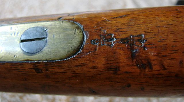

There are many different inspector's stamps with a crown over top of some letters or numbers, and they are to identify the viewer who inspected the arm, such as crown over SHC for Sinclair Hamilton, crown over B for Barnett, crown over FP for Francis Preston, but I've never heard such a mark was ever used to mark a second quality enfield.
One question is whether that is really a 2 on its side, or whether that bottom base of the two is just grain in the wood, and the mark is something else.
I just blew it up and I agree it could be something else, as you say the base of the 2 looks to be part of the grain, but still may be a 2, as to 2nd quality Enfields I will always defer to Tim and the Enfield guru (Lanyard Puller). Tim has handled thousands of Enfields and is one of those responsible for getting the "English Connection" published. @Lanyard Puller has the most incredible Enfield collection I have ever seen and they all are Confederate, many of which are in the afore mentioned tome. Unfortunately Corky is no longer around to ask, so Tim is the go-to guy. Many of the Enfield markings that we now know more about, are as a result of a small group, who rescued the Caleb Huse papers, Tim & Puller among them.

Well, none of the exterior markings in the wood are clear, one would expect to see the round Birmingham Trade marking on the stock and as far as 2nd quality Enfields I'll go with what Tim Prince says, if he says he has seen a 2 and it stands for 2nd Quality on Enfields well...…..
Its definitely a 2, trust me on that (download the picture I posted on page 1 of this thread, then zoom in on it). It's quite clear when you are looking at it with your own eyes. The font style is distinct and wouldn't be mimicked by the wood grain (its not a wonky 2, it has a very sharp transition at the base of the 2 that simply could not be a wood grain effect...its a distinctive font style).

Since your 2 is perpendicular to the usual markings and obviously not the same stamp and Tim has seen these before, I would go with 2nd quality. Again, it is not a knock against your arm, as previously stated, 2nd Quality Whitworths were fully functional, just stock finish was lacking.
