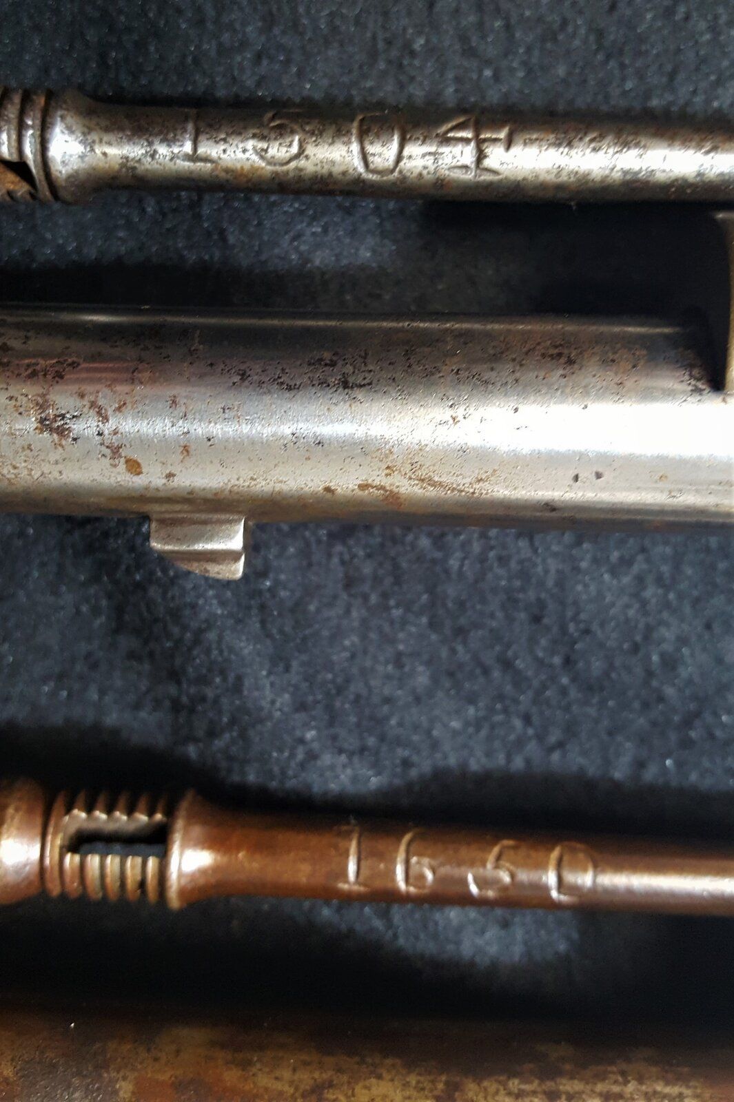

As for the ram rod question. It was numbered {engraved not stamped} to match the number on the butt plate. Bayonets were also numbered.
Enfield P53 rods are not hard to find, BUT !!
These guns were hand finished to fit, not machine made and therefore the parts are not interchangeable. My best example is a P56 carbine without a hammer.... so far I've tried 9 hammers...none of which are even close.
You would have to have the gun with you and try the rod, or else you will become a Confederate ram rod collector ! finding the rod that matches is highly unlikely. The same holds true for bayonets... hand finished to fit.

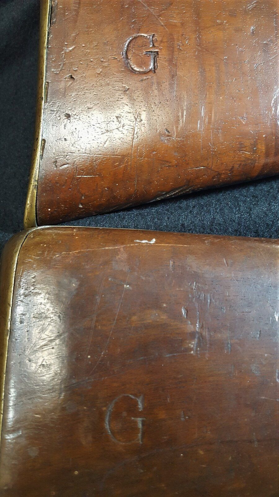

here's what they looked like {2 Georgia P53's}
Georgia and a few other states marked their shipping crates, bayonets and guns, as the CS government sometimes would take what they wanted at dock side.
Show off, with all those G stamps, but I say this only because I have some envy!!!!
