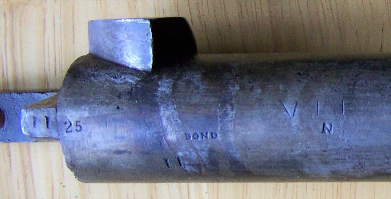

The way that the civilian British arms industry worked was rather different to the US one. The name on the plate was the name of the gunMAKER - who did not 'make' the gun! The 'maker' was the guy who organised the making of the gun - the man with the money - the contractor, who may have made some of the parts. Each maker had a number of smaller sub contractors who made the individual parts, so the stockmaker's name may be found in the barrel or ramrod channel, stamped into the wood. The lockmakers name will be on the INSIDE of the lock plate and the barrelmakers name on the underside of the barrel. Names were sometimes replaced with initials. Brass accessories, bands and ramrods will be made by other firms who may stamp their initals on them.
These parts were brought together in one place to be assembled. There were no serial numbers on any P53s, they were just used on patented arms. Each part would be stamped with an 'assembler's mark' to aid reassembly. This was made with a flat blade and took the form of a series of | , \ , /, X or V on the underside of the barrel, in the barrel channel, on the edge of the lock plate and even on screws and other components - but always out of direct sight.
The | | on barrel and breech plug are the barrel assembler's mark, completed before the rifle assembly.
Unlike military and Enfield-produced weapons there were no inspector's marks although some lock parts may bear them as they were using up stock. The barrels were civilian proofed in London or Birmingham (in this case London) together with the bore. (25-bore = .577").
