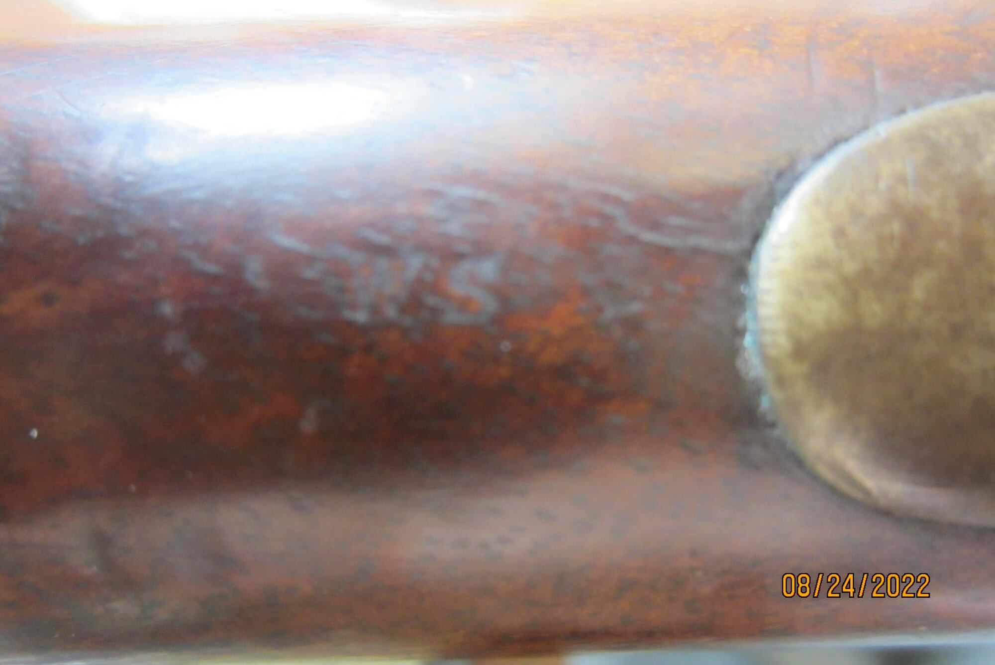

It is my understanding that Barnett was a leading, if not the primary, provider of British small arms to the Confederate States. I have read that Inspectors or Agents for the Confederate States viewed each rifle prior to acceptance and shipping and placed their view mark, which consists of initials in an oval, on the comb immediately ahead of the butt plate extension. My rifle has such a mark, which measures approximately 1/2" across on the long side. In this case, it is a "T.S" in an oval. It is possible the "T" is a stylized "P" with a tail, but I am quite certain it is a "T". The view mark appears to me to be identical to other accepted Confederate view marks I have seen on this and other sites, but with different initials.
My questions are two fold:
- Does such a view mark indicate ownership of this rifle by the CSA?
- Did any other entity of the period employ a similar, and similarly located, view mark?

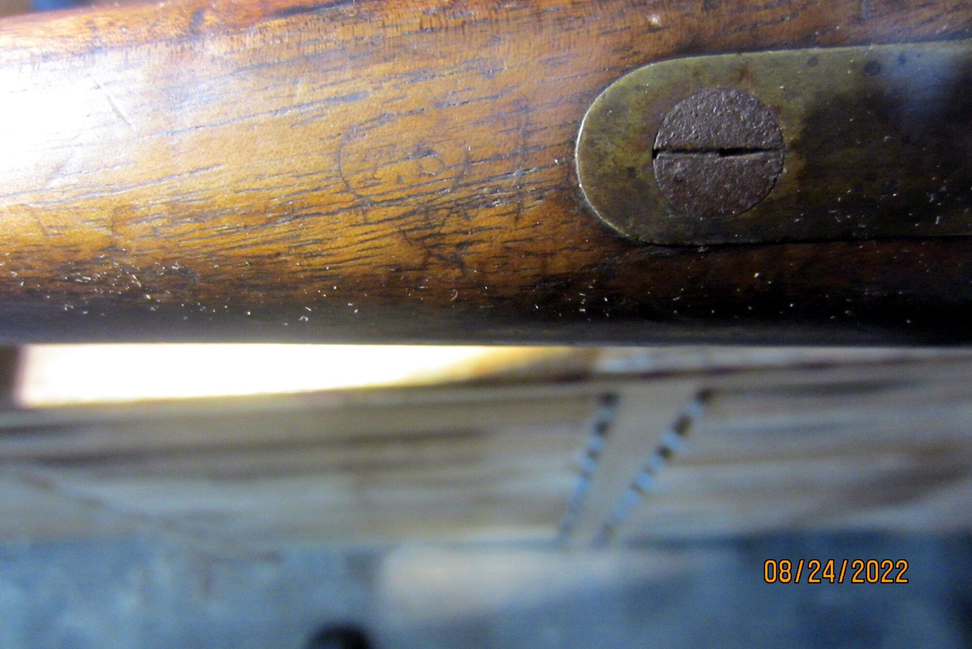

I also understand the Confederacy confiscated Union arms and collected Confederate arms from the battlefelds and ran them through a Repair Depot prior to placing them back in service. I believe this is referred to as their C&C Program and I understand such arms were marked with a letter designation on the underside of the stock ahead of the trigger guard. My rifle has the letter "X" prominently stamped on the underside of the stock directly under the forward lock bolt.
Does that reliably indicate passage through a Confederate Repair Depot and would it further support the belief of Confederate ownership?

That is encouraging. I was not aware the view marks were placed anywhere other than on the comb. Then again, I know next to nothing on the subject. Does your view mark look as though it was struck with the same die? I wonder if it is known whose initials they are.
That is very cool. I have the book "Captured and Collected" It does not mention an X, It does say "Identification of all currently known markings: A,F, Q(most common), T, and Z. But others may exist. Your X has the serifs the other letters have. So interpret from that what you will. Would love to see more pics.
I discovered another thread on this site with a photo showing the same "X" on the forestock of another rifle.

Initials in circles or ovals on the top comb of the stock just ahead of the buttplate tang are considered confederate viewer's marks. A viewer's mark would be the mark showing the newly completed gun had been examined ("viewed") and accepted as meeting the contract specifications. These were private inspectors hired by - well, maybe a state, maybe the CSA, maybe a seller who wanted a seal of quality approval stamped on his wares. But these would have been inspected and stamped in England, not here.
The X on the belly of your stock (is it about two inches of so ahead of the triggerplate?) is one of those marks recently mentioned as likely a mark put on during the rifles service to show it was examined and approved after some sort of repair.
Thanks for the reply.
Yes, the "X" is approximately 2" ahead of the forward extension of the trigger guard. It is pretty much directly under the forward lock bolt.

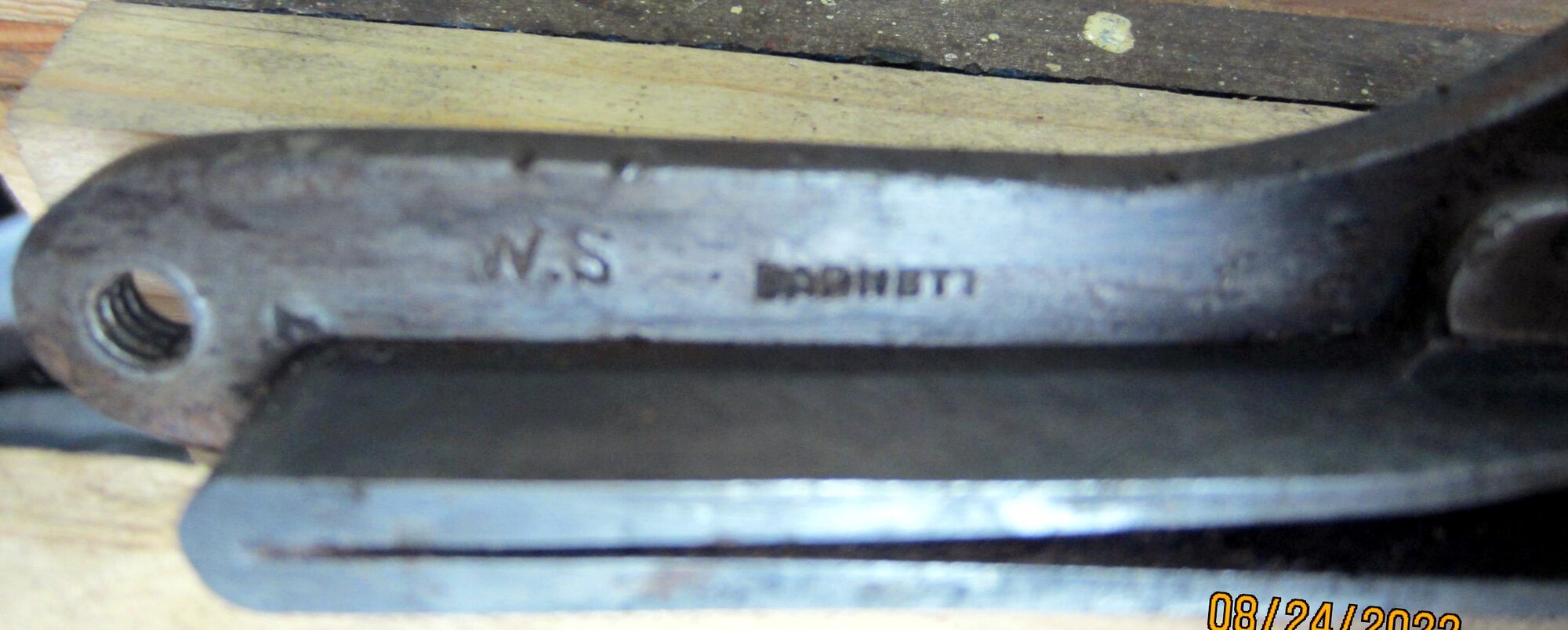

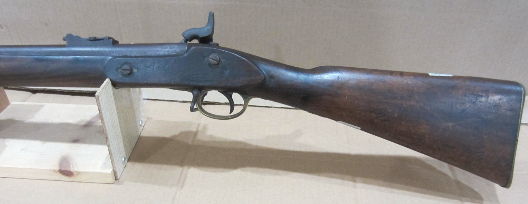

Here are the overall pics. Clearer pics of all stamps are available in earlier posts. When received, the "ramrod" was a brass rod with a hex nut brazed onto the end and it had that totally inappropriate screw holding the hammer on. I will find an appropriate ramrod and find or make a correct screw.
Please let me know if you would like additional pics or info.

A fairly typical Type 3 with some unusual marks. The 'Tower' under the crown is not often seen. The TOWER is usually on the lock above the date on London and Birmingham contract guns (parts sourced from sub-contractors) and the ones with the gunmakers name normally have the crown without anything. Having said that, it seems to be a Barnett theme - there was one marked exactly the same offered for sale from College Hill Arsenal. Also check another thread from 2019: https://civilwartalk.com/threads/help-identifying-enfield-barnett-rifle.157110/

'WS' may well be the assembler's mark. The hammer screw is not original. There may be a '25' on top of the muzzle (25-bore)

The acceptance stamp is usually JS but ...

The 'WS' is unusual since most assemblers in GB and Liege used the old 'line' method (\ / l l), the initials we not used for another few years in GB. I too do a lot of restoration - but most of my old long arms and pistols are hardly good display items - but you learn a lot of old gunsmithing skills!

I misspoke with regard to the assembler's mark. I should have said I assumed 'WS' was the assembler's initials. The assembly mark on this gun is "l l". The gun appears to be all-matching right down to the lock and tang bolts. Also, I looked for markings in the vicinity of the front sight and muzzle. There are none. I was more than a little pleased to find all three band screws still have their retainers.
