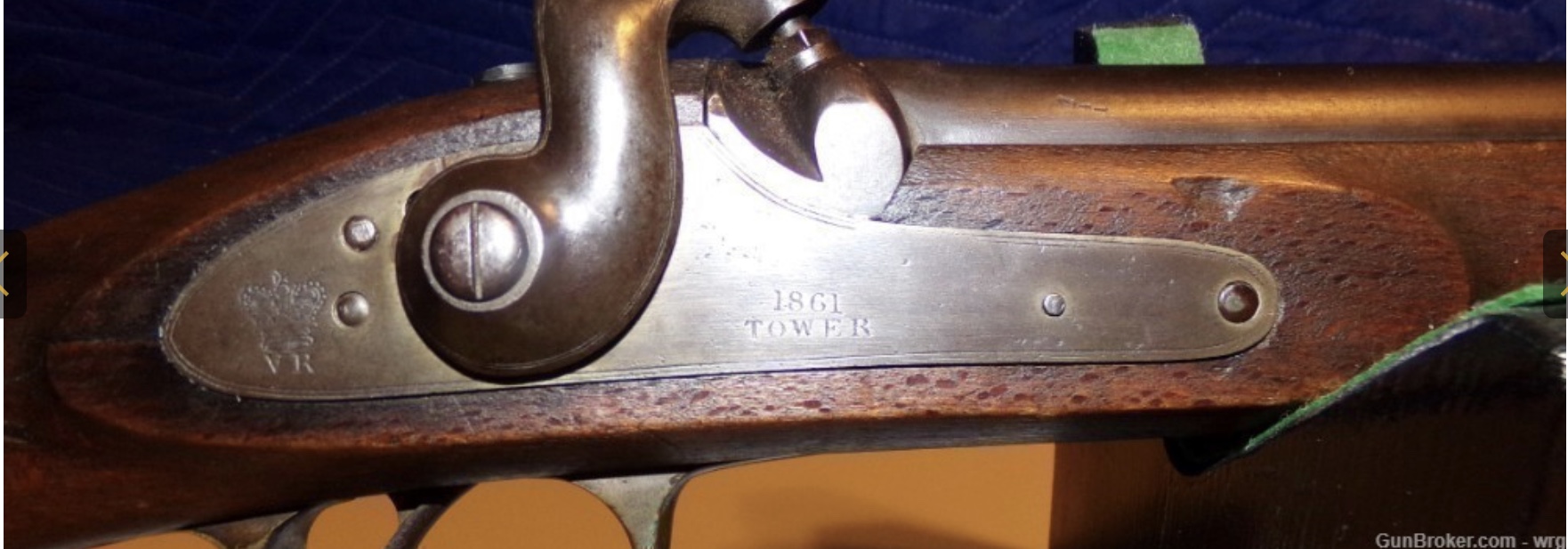

The Short Rifle shown in Figure 11 illustrates what was perhaps a sign of change in the political and military climate in India by the beginning of the 1870s. it is in construction a Pattern 1861 Short Rifle—the most modern of British service muzzle-loading rifles— with all the improvements of that model, five-groove heavy weight barrel, 1250 yard backsight and Baddeley band. It bears, however, the marks of the East India Government, as represented by a Crowned EIG on the tail of the lockplate and a circular ETG and Broad Arrow stamp on the right of the butt. Lockplate markings include "B.S.A. & M. Co. 1873." The barrel is 31* inches in length, the only non-standard feature of the weapon, and it was probably for issue to Engineers in the Indian service. It is of excellent workmanship and finish throughout and bears the Government's First Class stamp in the butt. If intended for issue to Indian troops it is a sign that a degree of confidence was again felt in at least a portion of the native troops to an extent where they could be trusted with weapons of equal accuracy to those in the hands of British regulars. By this date of course some of the British troops in India would have had the Snider breech-loading rifle, but the accuracy, if not the speed of loading, of the rifle illustrated was fully equal to that of the new Snider.
FIGURE II: A Pattern 1861 Short Rifle made for the East India Government in 1873. Except for its 31inch barrel this rifle represents the most modern pattern of muzzle loading rifle in use in the British Army (the issue pattern having a 33 in barrel) That it was made for Indian service may indicate an easing of the military and political tension sufficient to allow the partial re-arming of local troops with greatly improved weapons— especially as the Snider was then being introduced into the Regular forces in India.
