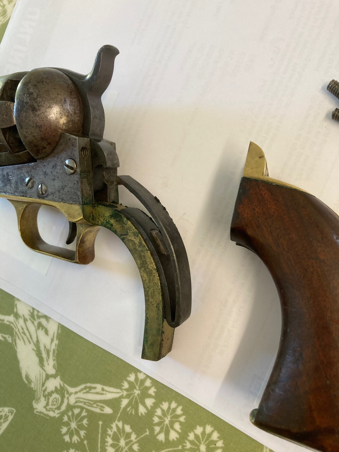

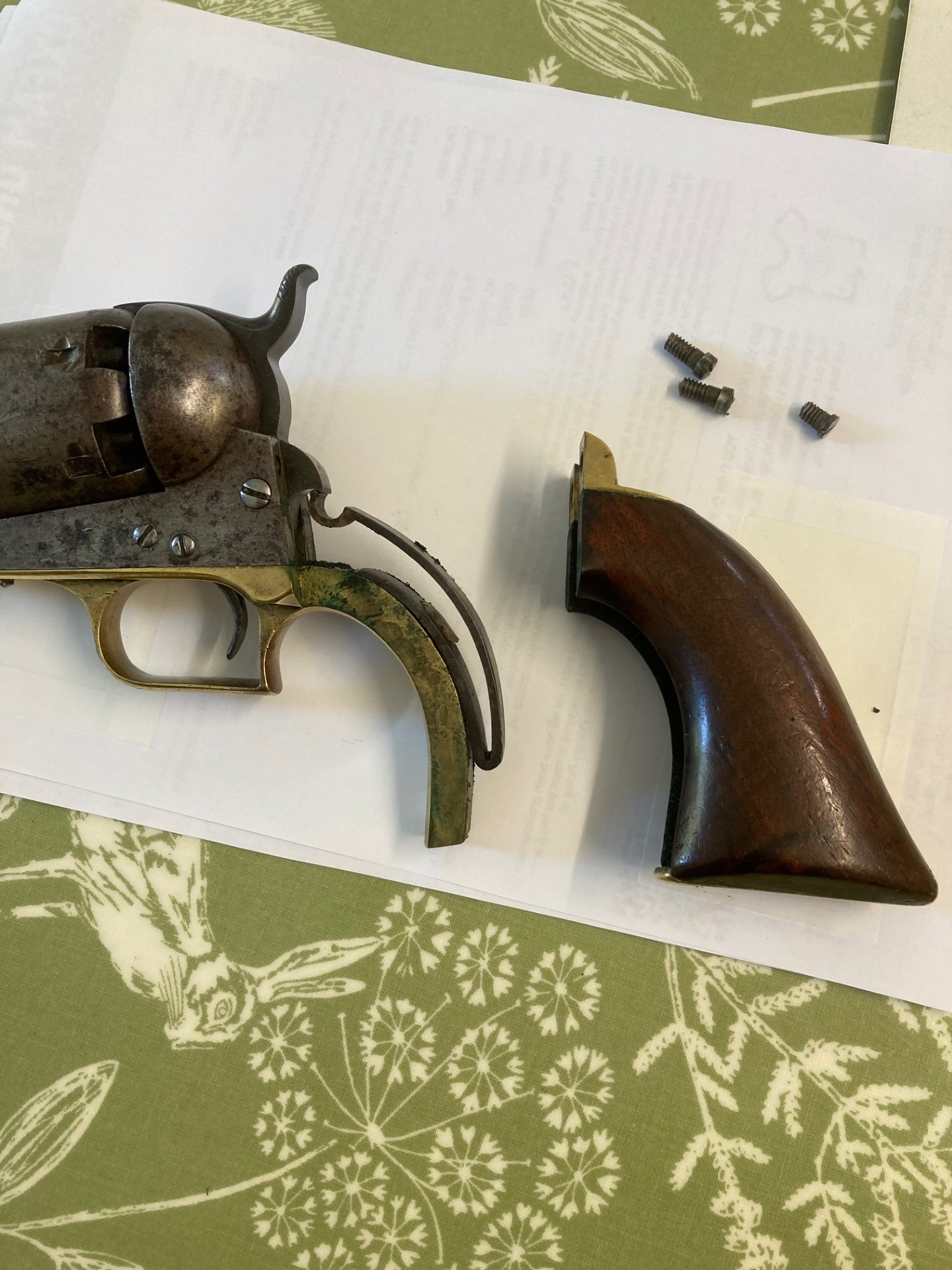

I have a 2nd model Colt Dragoon revolver, serial number 8840 (so quite early) and I have read that 1st models and some 2nd models had a V mainspring and later ones had a flat mainspring. I can't find any photos of the springs and would like to ask members if I have a V spring from the photos that I have attached? Can post more photos if required.
hold up your hand and extend your index and middle finger. You've made the World War II sign for "V for Victory"
Now fold one of those fingers so only one is extended.
As with fingers, so with springs!

Thanks Jeff, nicely explained. As requested I have added a few more images. It has all matching numbers and there is even a bit of the cylinder scene visible. Bought it here in the UK a few months ago, very pleased but a bit poorer now.
