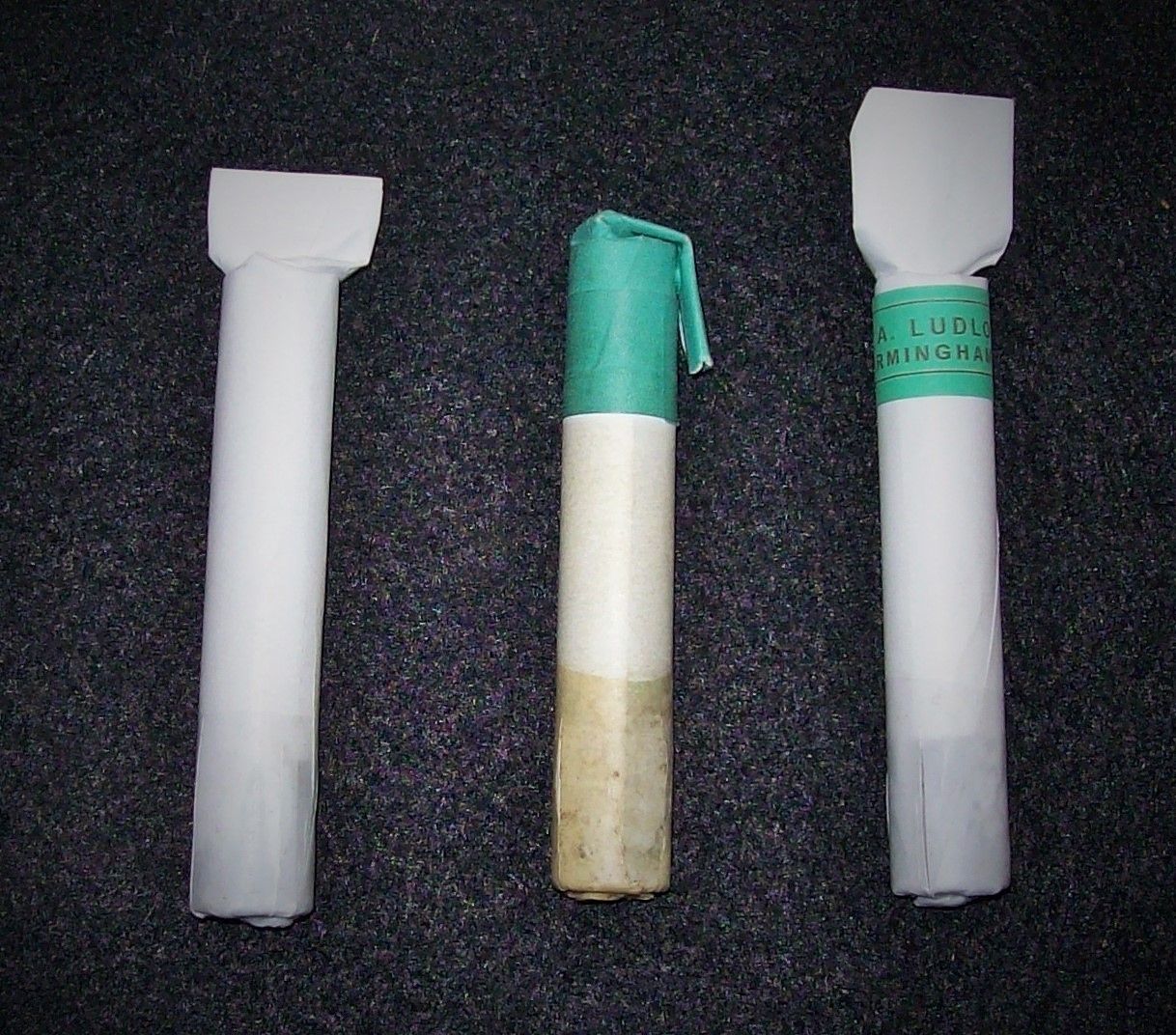

He needs to be using real Enfield style cartridges!
They look great, would love to try to make a few for demo purposes. What did you lube the paper with?
After forming the cartridge, I dip the bullet end into a mixture of pure beeswax, and olive oil. (more beeswax than oil, (around 60/40%). Then with the forming rod in the case, I push the bullet end into a .577" sizing die. This uniformly presses the paper around the bullet, and presses the lube better into the paper.
