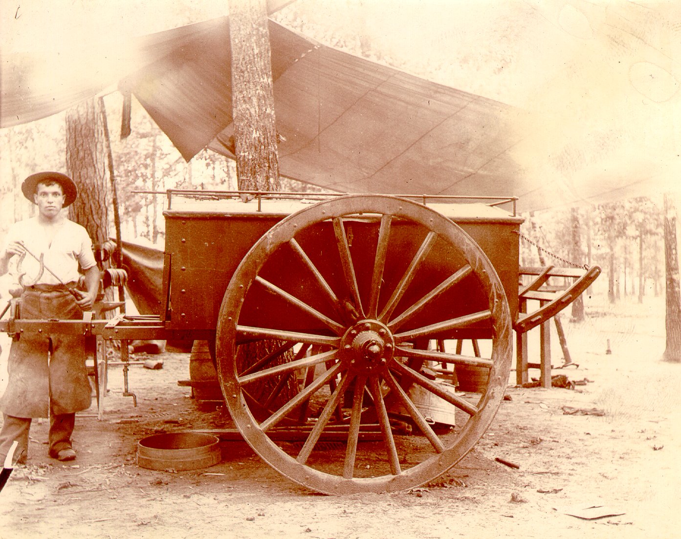

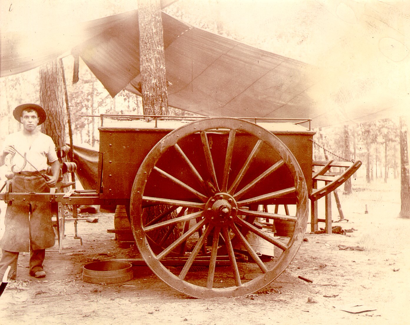

Side bar: The battery wagon is something that few have heard of or ever seen in person. It was an absolutely essential rolling hardware store necessary for maintaining the battery.
The lid of this battery wagon is closed. It would have been hitched to a limber just like the guns, caisson & traveling forge. The cradle on the back was for hay. This is a post war example only different in detail.
Every battery was assigned a battery wagon.
The contents of the battery wagon was an exactly sized & placed collection of boxes. Each of which contained an exact inventory of necessary items.
Just a heads up - that is a post war image of post war equipment.
