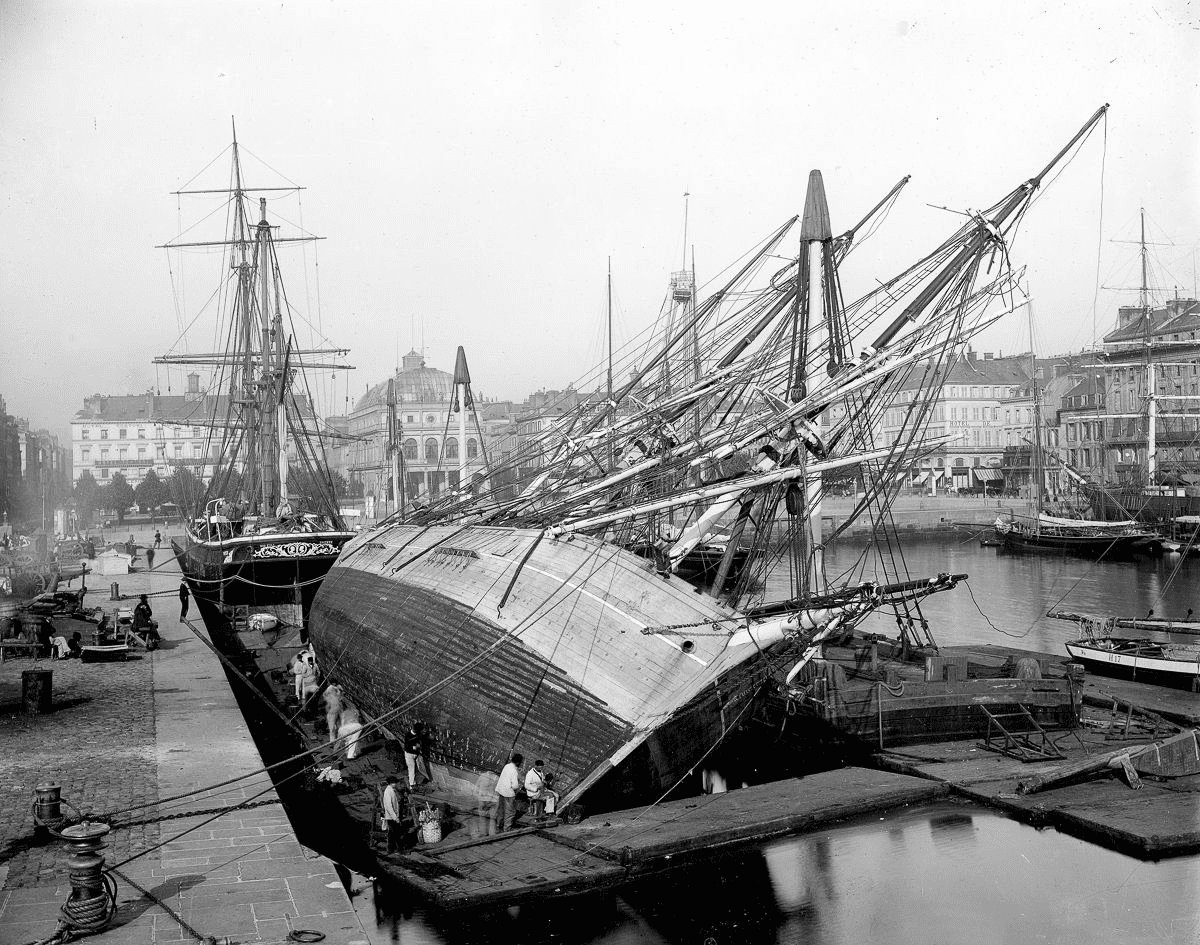

Known as 'careening' or also 'Parliamentary heel'. Quicker and faster and don't need to take up space in drydocks.

Careening makes sense but why Parliamentary Heel? I see that they either have to shift the ballast or cargo to get it to tip on its side, how on did they get her upright again..did they pull it upright with hoists or did they shift the cargo/ballast again?
The term was "careening..." [sorry! just saw that @USS ALASKA beat me to it...] usually when repairing, painting, resheathing, or doing something else to the hull. As for why this was preferable to sitting upright, I'm not quite certain; I was under the impression it was mostly done where there were no drydock facilities that would permit the ship to remain upright, but the photo doesn't look like facilities are lacking-- so I'm puzzled.

When/why would one turn a ship on its side like this to work on it, rather than support it upright on scaffolding?
That's known as "careening", usually done in a location with no docking facilities, I can't explain why they are doing that here, unless that is a lock chamber. The location looks vaguely French.

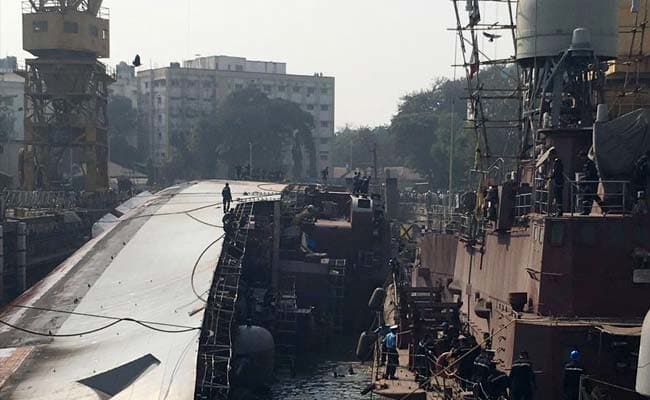

It can also happen by accident, as with the Indian frigate Betwa in dry dock a couple of years ago:
