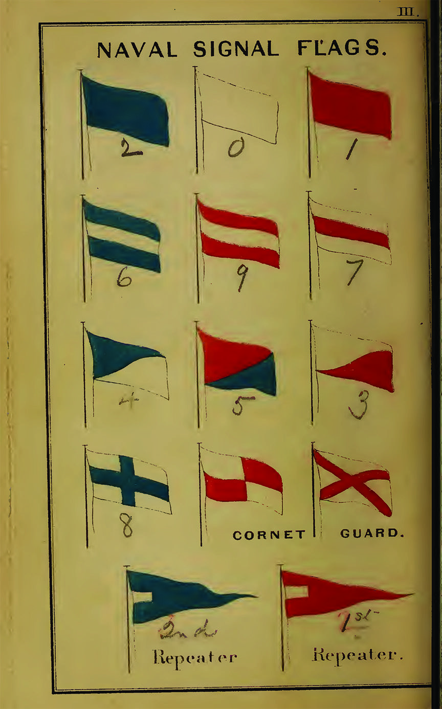

From the Code of Flotilla and Boat Squadron Signals for the United States Navy (1861) (14MB PDF):
Signal No. 3794, Concentrate fire​
I'm not certain how the squadron commander would designate the target vessel, though.
Notice that the numerals assigned to the individual flags (p. 34 of the PDF) are not sequential, and written in pencil -- I think that was a security precaution that allowed the value of each flag to be changed when it was believed to code had been compromised.
