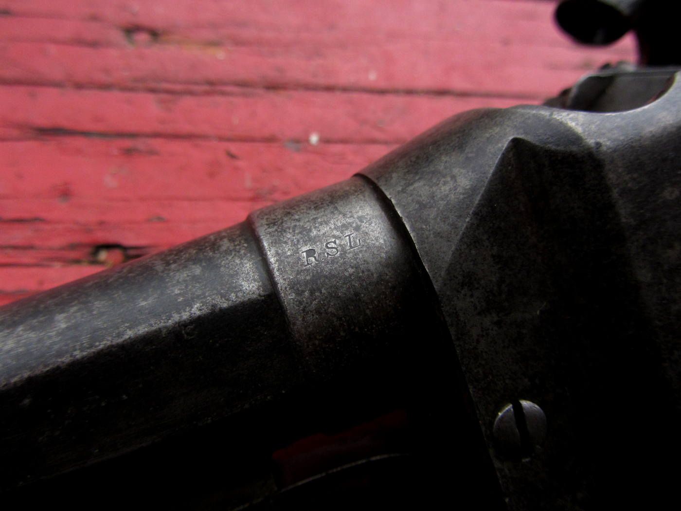

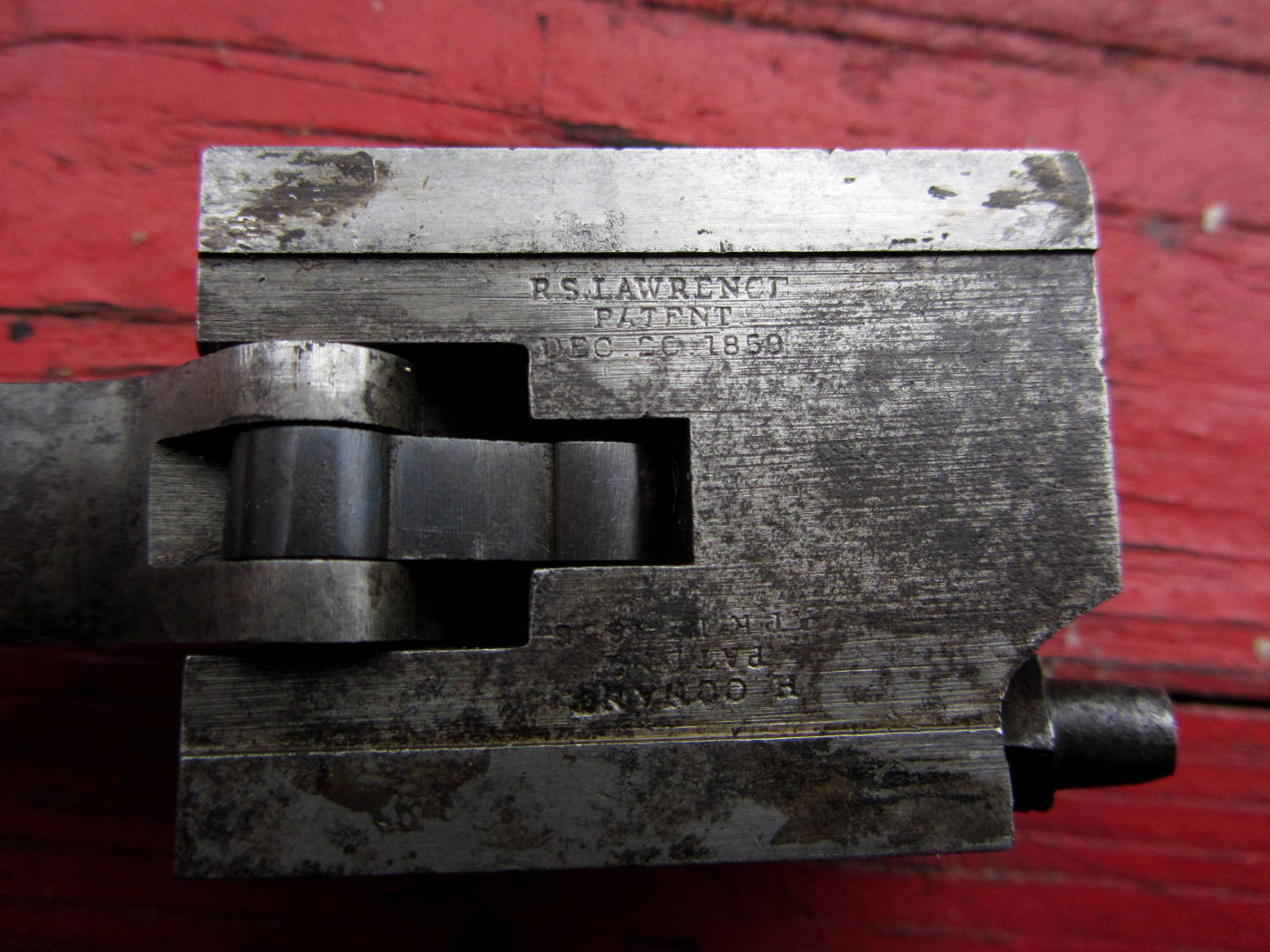

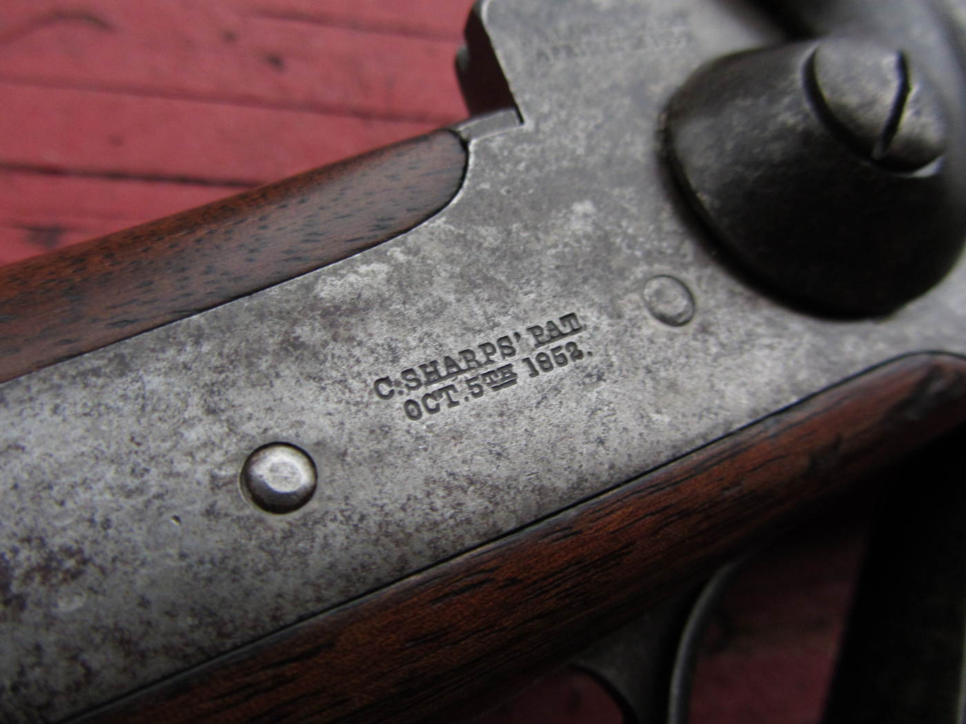

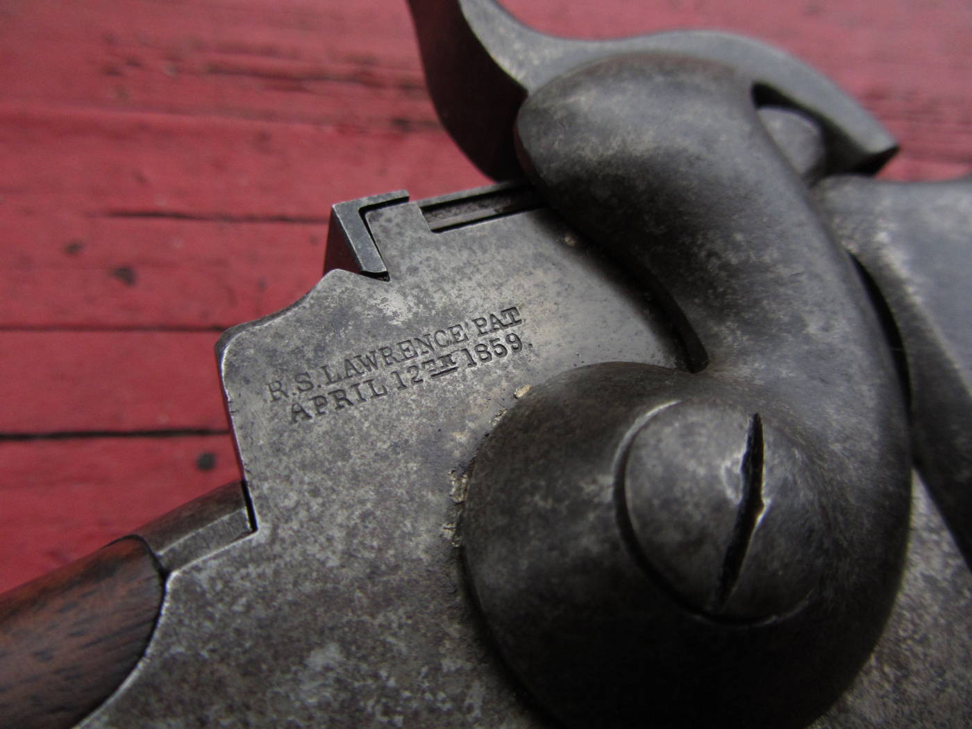

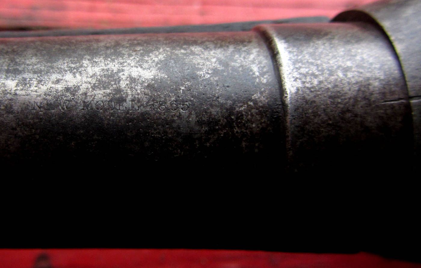

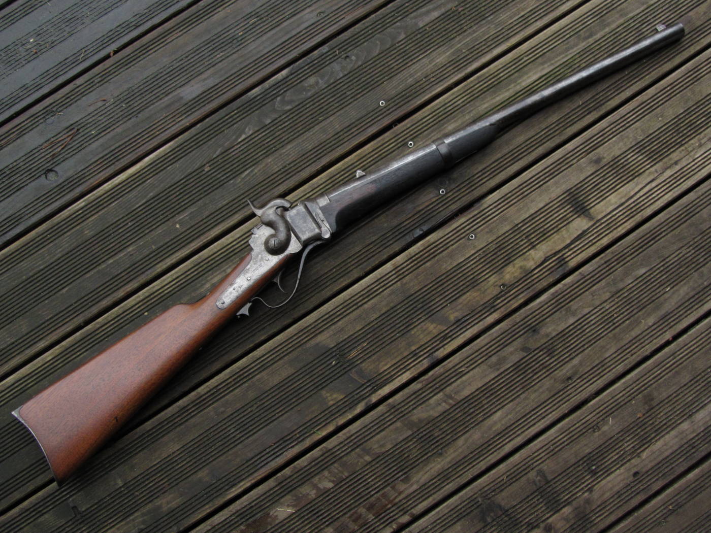

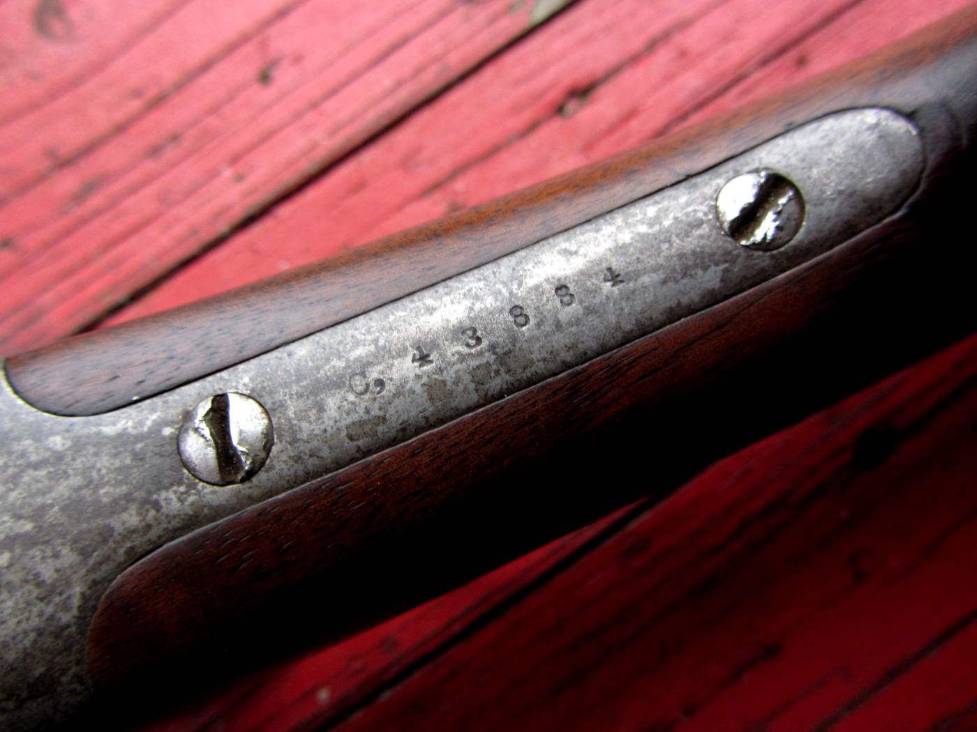

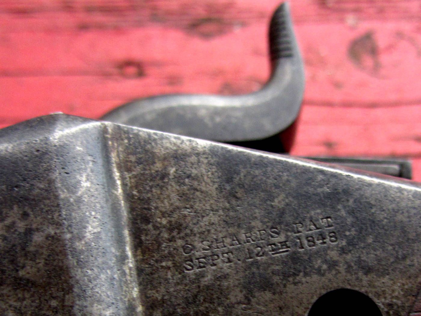

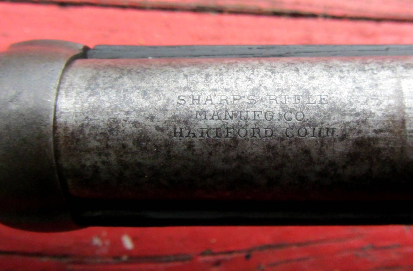

Hello,
this rifle was sold to me an an Palmetto Sharps, but the seller dont really know it, he got it for selling it from an widow of an colleague.
I researched alot the past days, and don't find much informations.
Experts say that it must be an real Sharps, theres no replica ever made in .52 with all these markings.
Sadly some parts are missing, swivel bar, saddle ring and the orginial rearsight... just have an repro sight on it.
But i think its not an problem, find all parts instead of the sight for small price.
So, any opinion if that really an original, or an very good replica?
It haves alot of markings, small parts have an c, p or r stamped.
Best regards, David
Thanks Mr. Steele :smile:
I dont know much about Sharps atm....
Whats the difference between M1863 and New Model 1865?
Just checked the serial number, its fit to M1865, and on the barrel it looks like an 5 at the end, not an 3
I think its the find of my life... just paid 240 Euros for it
Best regards, David

The differences are absolutely minimal and related to ease of production.
Most M1865 were converted to .50-70, those remaining in percussion usually made it into the hands of Indian Scouts during the various Indian Wars. Quite a few were sold to the French just prior to the Franco Prussian War and like the Spencer were highly regarded by those that carried them. That it managed to survive two World Wars and the anti-gun frenzy of Europe is interesting.
It is in nice condition and for 240 Euros you made out like a bandit, I would expect it would fetch 3-4 times that in the US.

So, what means the R.L.S. marking?
Just found out it is from Captain Robert S. LaMotte... but what it means?
Best regards, David
Does the forend have burn signs? The lever-to-block link and nipple look new/repro. Beautiful piece. You want a nice rear sight go to gunsamerica.com and search for sharps rear sight. Orlandof is the guys handle, and wouldn't reply to any of my emails, so I bought a cheaper one on eBay. He probably had too many hagglers like me bothering him. Price is $180.

Nice piece! Looks like 'the real deal' to me....
If you can, remove the forend screw, press on the spring and remove the band and forend. You can confirm the receiver and barrel are the same serial number. Barrel number is maybe 2-3 inches forward of the screw base.
Don't know if you stated above, but do the forend and/or stock have any pressed-in factory markings? I'm working on a '59 carbine restoration and needed many parts. Forend has a mark on the bottom rear nearest the block.
You'll need a high magnification glass to check out some numbers. What I've noticed with screw heads is that the repros have a tree ring effect. Could be wrong, but good bet. The tang screws look questionable.
