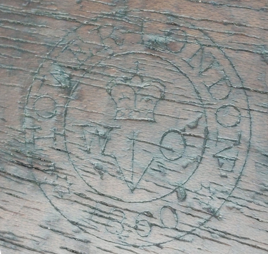

Within the roundel, one can see a Crown at top, a broad arrow below it and a very clear O to the right of the arrow. There would normally be a letter to the left of the arrow that should be a B. Many of us know that the B-arrow-O is the British Military Board of Ordnance military acceptance mark. The word London is clear in the outer portion of the roundel so this was undoubtedly a London-based government inspection facility...but what are the missing words on the roundel? How many government inspection houses were there?...does anyone know? There was a government inspection facility in the Tower of London, but what was their roundel? The picture doesn't quite capture it but with my jeweller's goggles I can see TOWER to the left of LONDON....squint and you can see a faint TO, the W is obscured by the wood grain, then a really faint E and a much clearer R. So we have TOWER LONDON in the top half of the outer roundel, but can't make anything out in the bottom half...any idea what the missing words might be or maybe there were no other words? It looks like there may have been another word in the bottom right (it looks like there is an illegible character there).
This is not a PIMLICO roundel, which was the government repair facility.
TOWER LONDON goes along with all the other information you have - a London consortium produced P53 for the British government. The Board of Ordnance (BO) died out in 1855 to be replaced with the War Department WD, but the arrow remained and a W replaced the B on the older stamps. There appears to be a faint W to the side of the arrow on yours. Underneath would be the date - like this one:
The Classification '1' is off centre on yours, hence the confusion.

You found the roundel I was looking for!!!!!!! :wavespin: :hug: AWESOME!!! :smile coffee: I had wondered if a date would be in the bottom half of the outer circle, but I really didn't want to speculate...THANK YOU, THANK YOU! You have renewed my faith in the Forums.🤓
Is this roundel from one of your guns, or did you find it online? I have googled and googled to no avail...if its from something online, please share the link. Do you have any good links to information on British military markings or anything on 1853 Enfield production? Anything you would be willing to share would be greatly appreciated!

To be honest it was a chance 'image search' find - and upside down. These are usually from adverts of one sort or another or complicated specialist sites. An excellent site for information is, as most would guess, is Tim Prince's College Hill Arsenal https://collegehillarsenal.com/ complete with photos and a quite detailed background and description (look in 'previously sold' - some 105 pages so far!).
