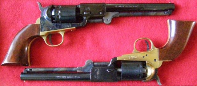

I have always liked the brass framed Griswold & Gunnison for the part round/part octagonal barrel and the smooth non-engraved cylinder. I have one made by Pietta (CN/2015).
Here it is paired with a Pietta Rigdon & Ansley parts (VTI) gun I assembled on a 1851 Navy frame (I had the 6 extra stop slots/approaches in the plain cylinder cut by my machinist neighbor):
