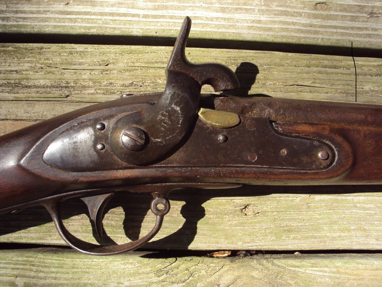

Ok, so I have been looking on line, lots of pictures.
Is it wrong to want to clean the Harpers Ferry up? Recommendations on what or what not to do? I believe there are dates on the breach plug (not sure where) stampings on the barrel to look for?
I do not see any modifications to the barrel. Does the frizzel look pretty well used?
So the threads on the Harpers Ferry do not match any gauges I have. It falls in between 20 and 24 standard and 1 and 1.25 metric. There is a B stamped on the back and an R S stamped on the top piece.
I forgot to ask if the butt stock on the flintlock has a dished out area on the left side. If it does, then you probably have a Model 1812 musket. This was the only one ever made with a cheek cutout. I'll scan a few things from my books and post. Yep, some of those screw threads were odd ball pitch. Some original guns used metric threads but other screws were standard. We copied the French muskets and those used metric pitch. Both guns look they are in good condition. I wish I could find goodies like these in junk stores. I did find a cut down and converted 1816 Evans contract musket in a junk store. I paid $150 for it. The lock alone was worth that!
The frizzen looks like it's seen use but I'm a little leery about the pan. It doesn't show much pitting while the breech of the barrel does. Some musket pans were detachable and could be replaced if needed. The 1816 musket is an example. Brass pan held with screws instead of brazed or forged in place. It looks like the vent is plugged with dirt/mud and or rust. Mud daubers can get inside the barrel and build a nest.
Something like this is what probably was done to your musket: the pan cut down, a nipple (missing on this example) placed directly onto/into the barrel, and cock replaced with a percussion-type hammer. Welcome to the forums, and nice buys nevertheless!

Hi, The left and right side look the same on the stock.
I think I might need to have the breach plug removed and push out what ever is in the barrel. I would like to salvage it if it is an old ball.
I don't think so, Pan is there and no damage to the barrel.
Ok, So I decided to start disassembling it. See pics. Pan is part of the sideplate. One casting. I did notice OHIO stamped on the barrel by the plug with what looks like a U under it. Should I try to clean it up???

I meant assuming that what Package4 said about it being a re-conversion was correct, as I too think likely. A friend of mine wanted an example of an 1816 that didn't cost a fortune and that he might use for Mexican War-era reenacting, plus an excuse to try out his gunsmithing abilities, and he did a very acceptable reconversion of one he'd picked up cheap.
The hammer does not match the piece, indicating that it could be a reconversion, this means that the piece was converted to percussion and then reconverted to Flint at a later date for collector value.
Hmm, something is fishy. The pan doesn't look like it was tampered with. And no dished out stock. I'll do some more checking and see what gives. If you can ship the barrel, get with Mike Lea in Columbus Ohio. He's a first rate Black Powder gunsmith. He can also examine the lock and see if all is well. Mike doesn't have a website and I don't have his phone # handy but you can probably find him using his name and Columbus Ohio as key word search. Just by looking at the plugged up vent, you might just have mud in the breech. Let us know if you get it cleared.

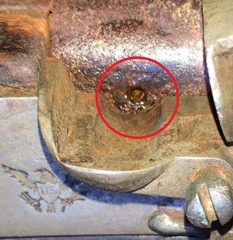

I'd suggest it's more likely a drum conversion reconverted to flintlock.
Look inside the red circle and you can see the faint outline of either 1) a touchhole liner or 2) what I think is more likely, the remains of a percussion drum conversion cut off flush with the side of the barrel.
Okay I did some more research. According to Major Jas. Hick's book, you do indeed have a Model 1812 musket. Some that were made at Harpers Ferry did not have the cheek cut out on the left side of the butt stock. Those were sent to the many private contractors (like Eli Whitney) as patterns to copy. The OHIO stamp on the barrel probably indicates that it was sent to the Ohio State Arsenal after the War of 1812. Many states stockpiled muskets (usually contract pieces) for an emergency. This pattern may have seen use in the hands of volunteers or militia during the Black Hawk Indian War or one of the Seminole Wars.
The internal lock parts look to be in good shape. The frizzen screw juts out a bit too much. Can you screw it in all the way ? If not, it might be a replacement. According to original sources o
Thanks for the enlarged image. Didn't notice that. It could also be a period "re-bushing" of the old vent when it became enlarged. It was bored out and tapped for threads and a corresponding plug installed and drilled for a vent. The pitting around this plug makes me think that way.
