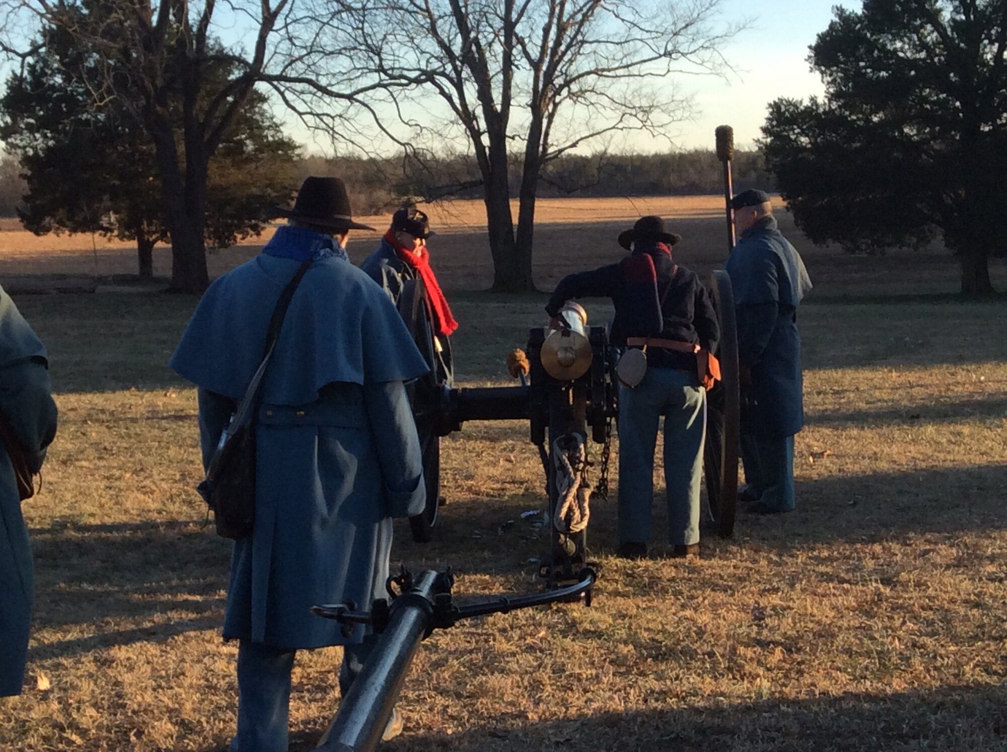

For those members not familiar with #1's position on the cannon crew, they use the sponge rammer to clear the barrel & ram the charge. #1 is stepping forward & about to sponge or ram the charge.
#3 is blocking the vent with his thumb. This prevents air getting into the barrel as #1 withdraws the sponge. A partial vacuum is created. The sponge comes out with a resonant popgun sound.
Premature detonation occurs when live embers are left. If #3 does not stop the vent or is not there at all, withdrawing the sponge sucks in a surprising jet of air. The live embers can detonate the charge as it is being rammed.
It is counter intuitive, but as the entry in the cannon accident says, a wet sponge does not extinguish embers the way you might think. The water child a hard crust around the ember. The ramming breaks open the crust & boom!
#1 always points his thumb toward the sponge. Held the other way the hand locks onto shaft with catastrophic results.
Parks Canada placed just about everything flammable in a cannon to see how long it would burn. 7 minutes was the longest before the oxygen ran out. That is the data that supports the 150% ten minute wait between rounds mandated by the NPS & many state park systems.
That's what I didn't understand - it is counter intuitive. I didn't realize the water chills a hard crust around the ember. That is crazy AND interesting! So that's why stopping the vent is SO important when swabbing out. Just like puffing a fire to get it going.
