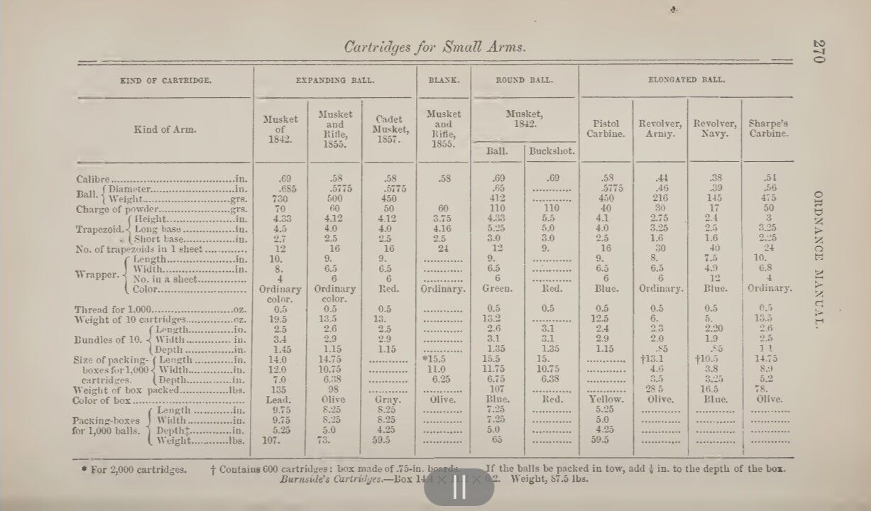

What was the standard paper cartridge load for the Springfield and Enefield rifles? What diameter/weight minie, charge of powder, etc.? I've been trying to find details in some old Ordnance books online with no luck.
Look up "The Ordnance Manual for the use of the officers of the United States Army." More specifically page 270. It lists all the dimensions, powder charges etc.. I believe it's a free download.
