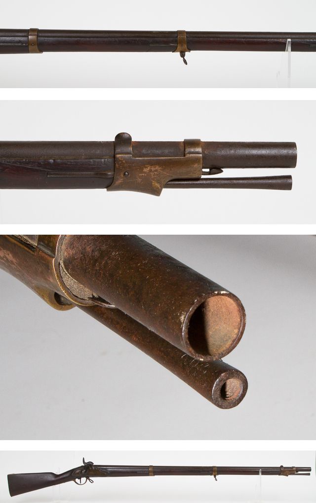

Hello all,
Have a question on a Potsdam musket, I think a converted Model 1809 (dated 1830). I bought it fairly cheap because the wood's been stripped. Question is, what was the original military finish on these? I think it's European beechwood? All the Potsdam photos I've seen run the spectrum of shades from light beige to golden to to dark walnut colored. I imagine I need to get something on it before I start applying the BLO? Other than the stock issue I just need to get sling swivels and a lockplate retainer screw
Those are all beautiful pieces. Thanks guys.
So maybe a coat of Tung Oil before the BLO to darken it a tad? The wood on mine is completely raw and wouldn't only the BLO turn out a super light shade when finished?
Where would someone be able to get some European beechwood. I need some to make a forearm from the lower barrel band forward. and on another the wood behind the lock had severe burn out from when it was a flintlock. I had someone said it was a common thing for the wood behind the bolster to get burnt badly, then it would fall away.
I have no idea whether the differences in beech would make a difference or not, but the following link is for a guy in Europe that makes military rifle gun stocks and could presumably be a source for wood.
This is likely too late for the OP, but if you are trying to match a wood color you should apply the first coat of BLO, and while it is still wet, then apply an oil-based stain. The stain will still penetrate the wet BLO and it is much easier to match the color you want if you are working with a wet stock because the stain doesn't penetrate as quickly.
Good tip - I've never tried this.
