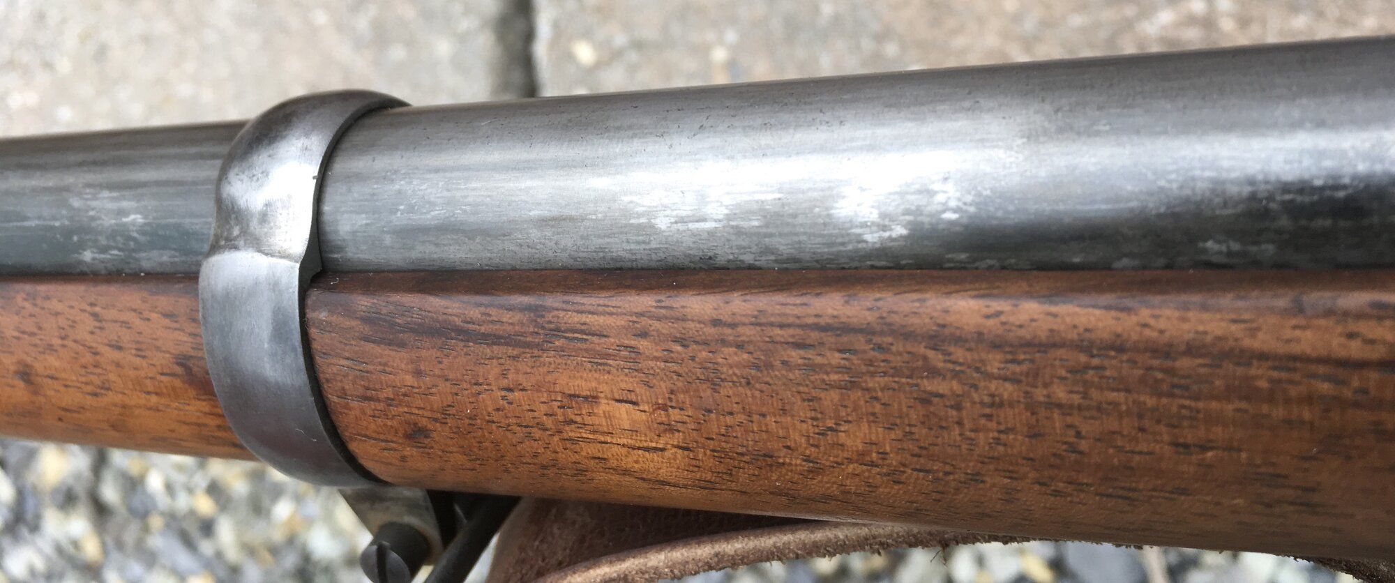

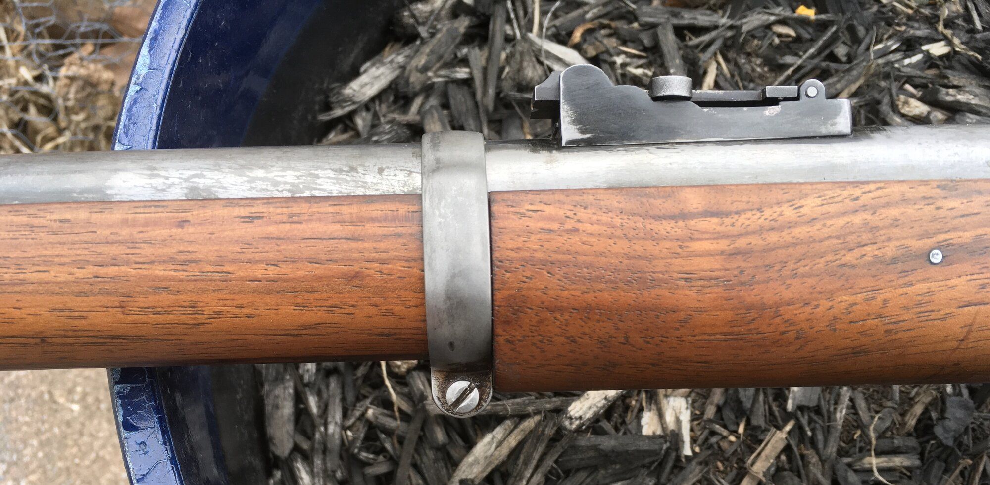

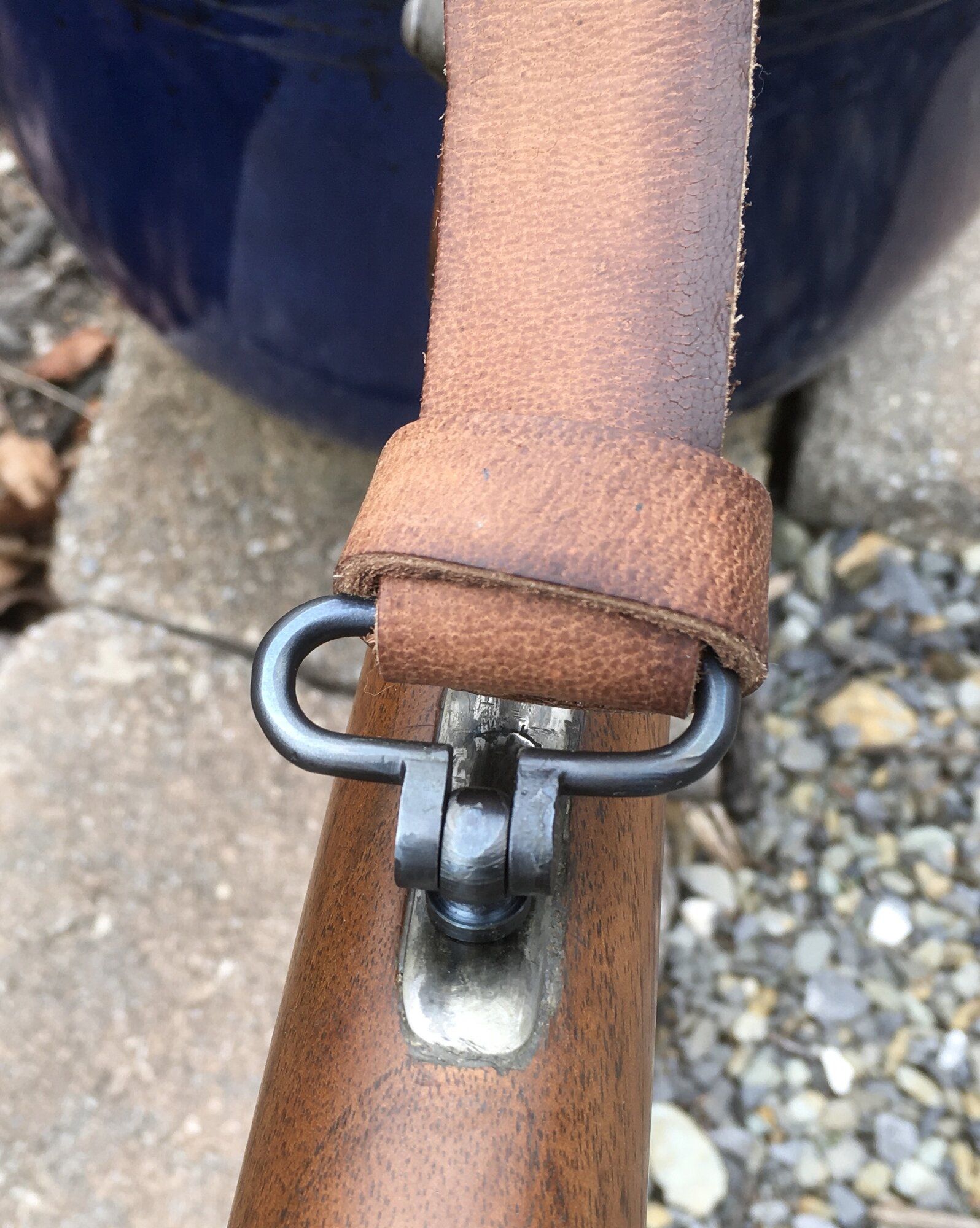

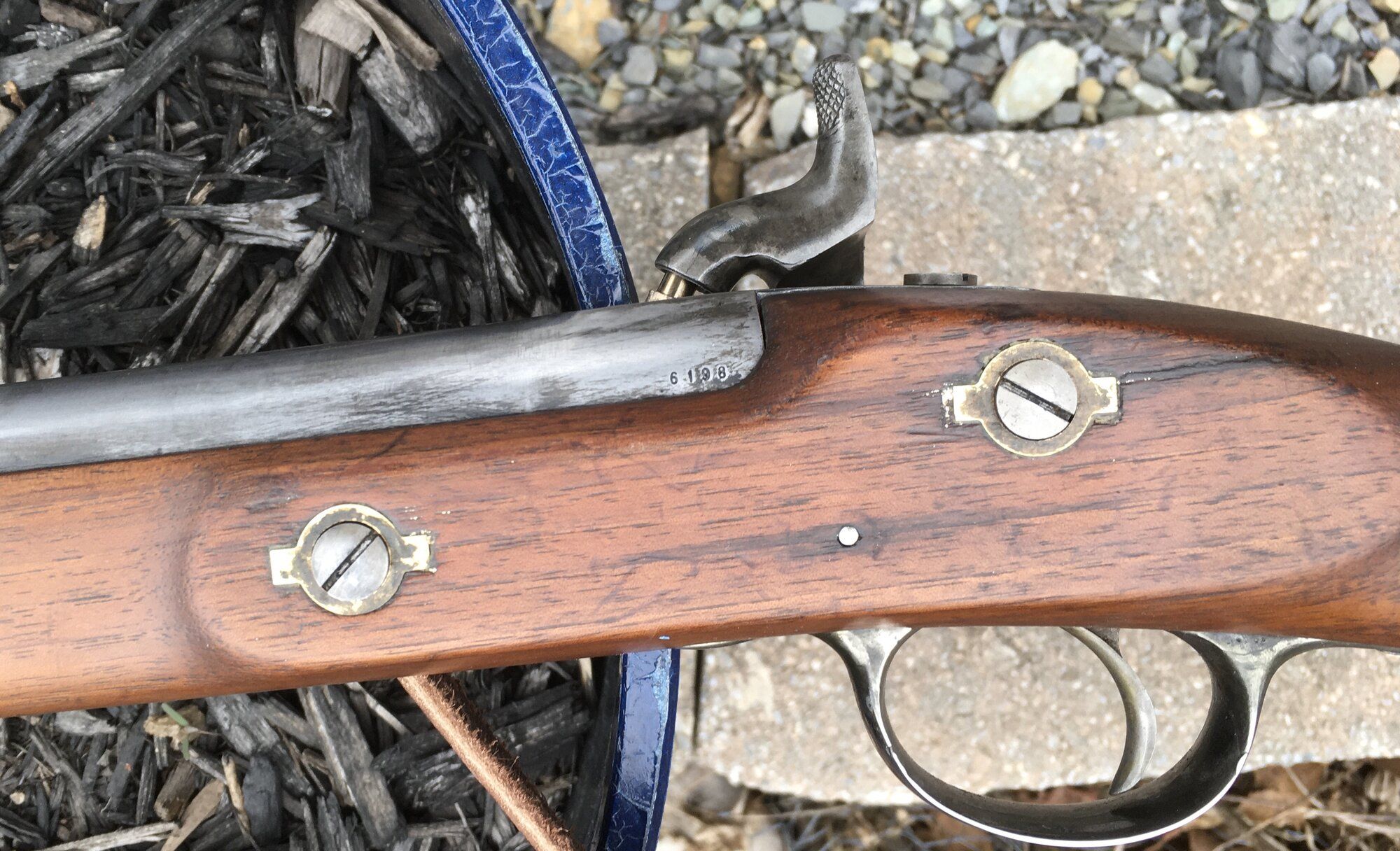

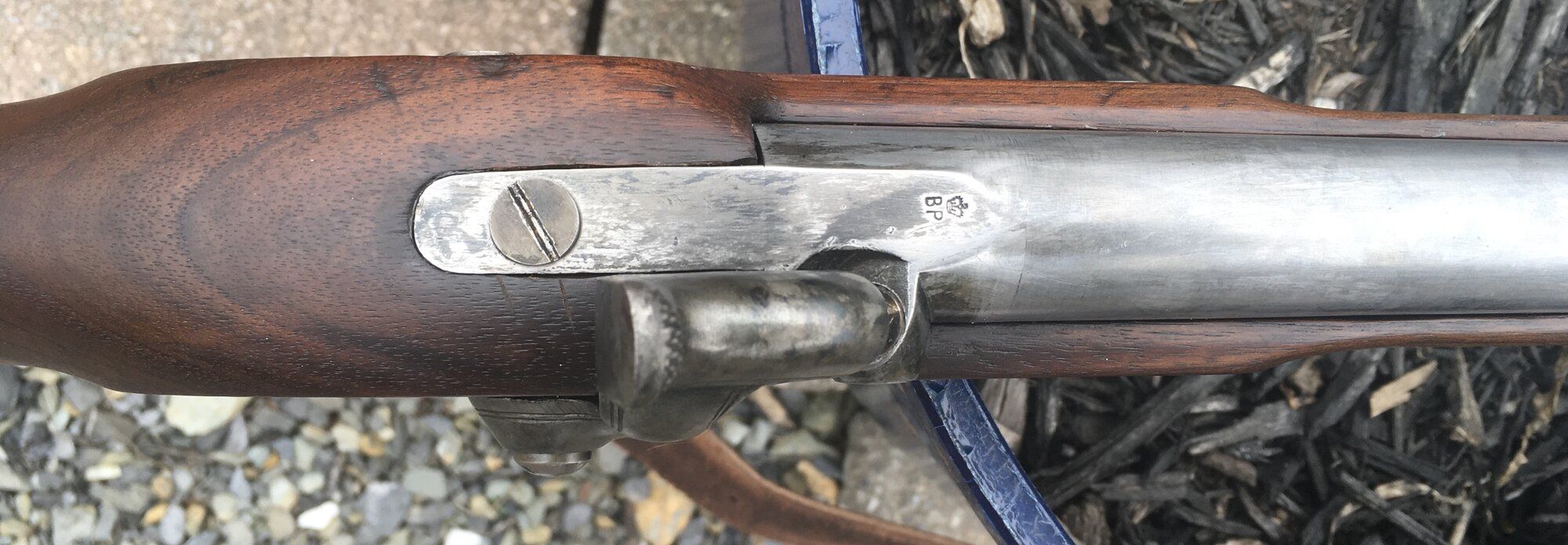

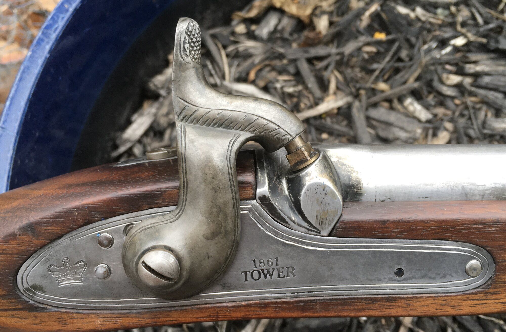

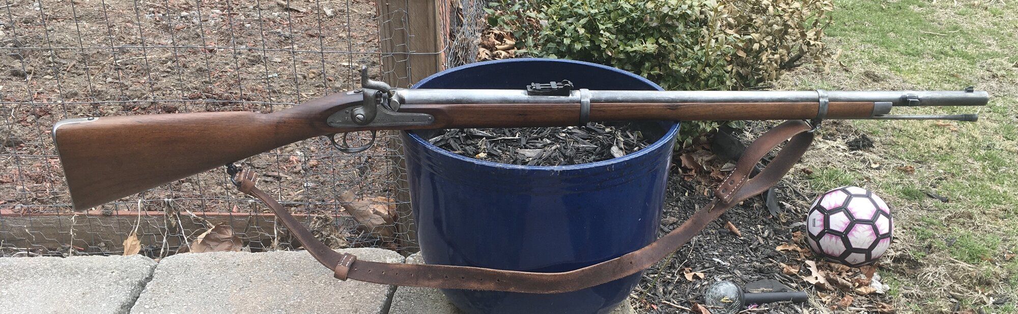

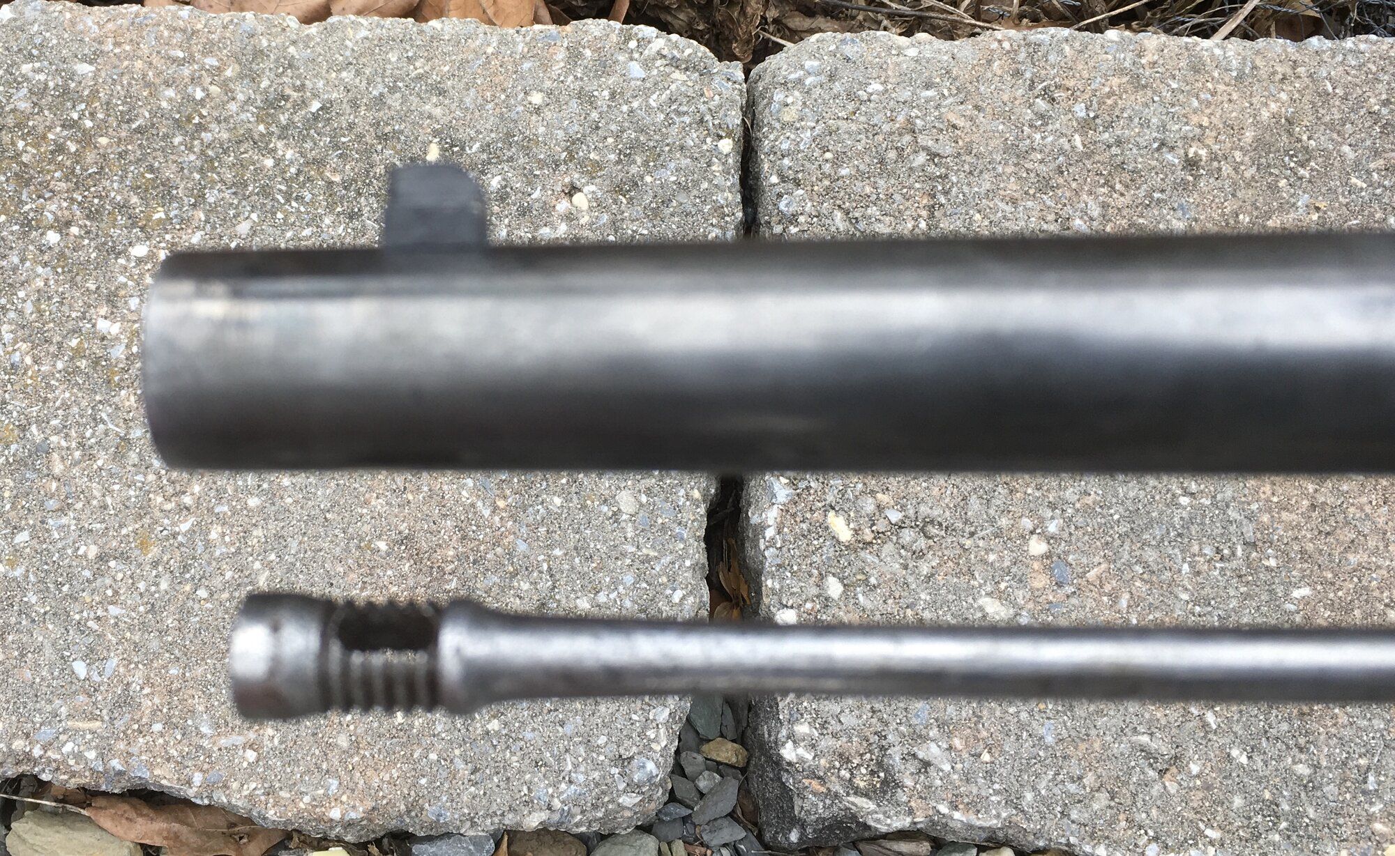

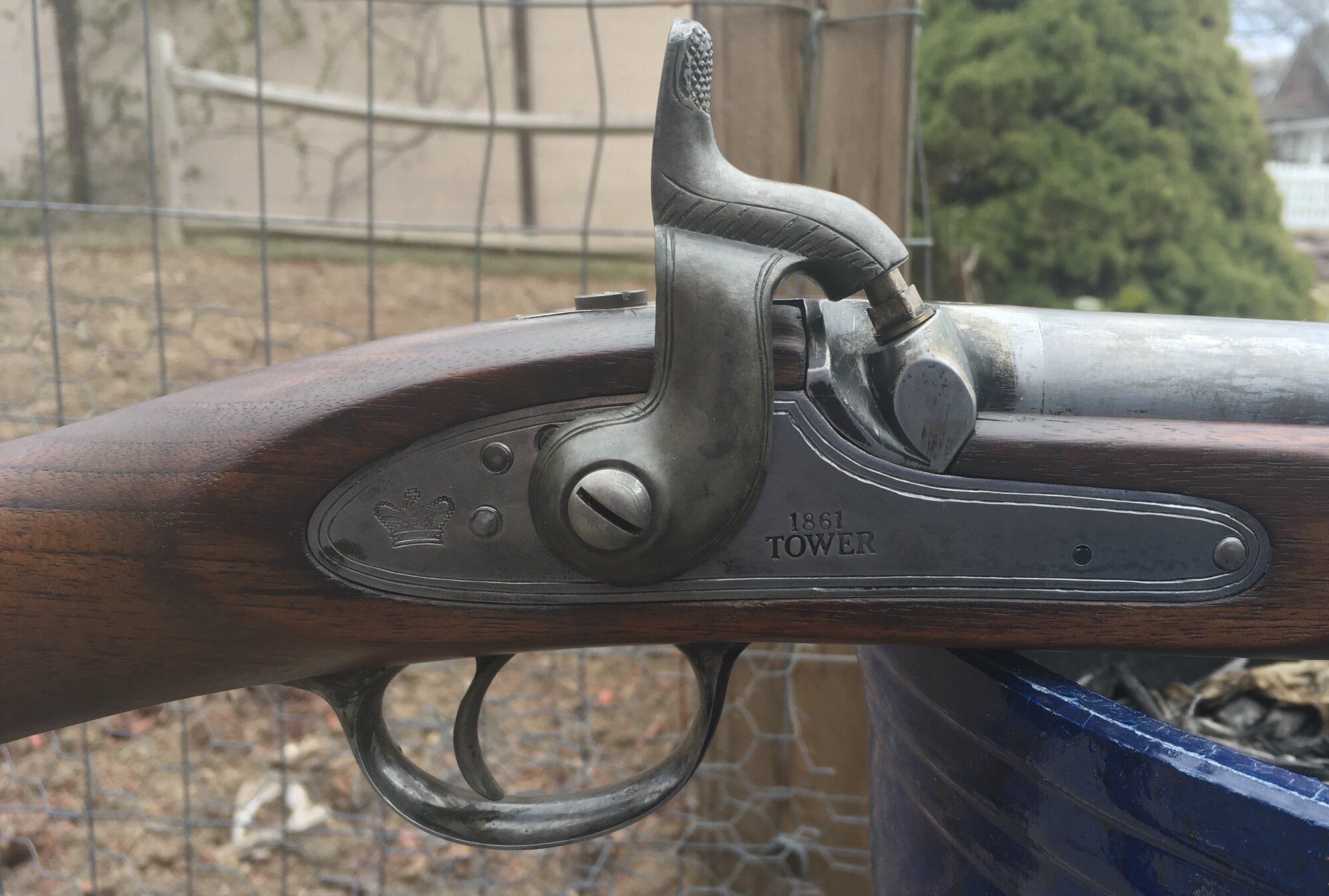

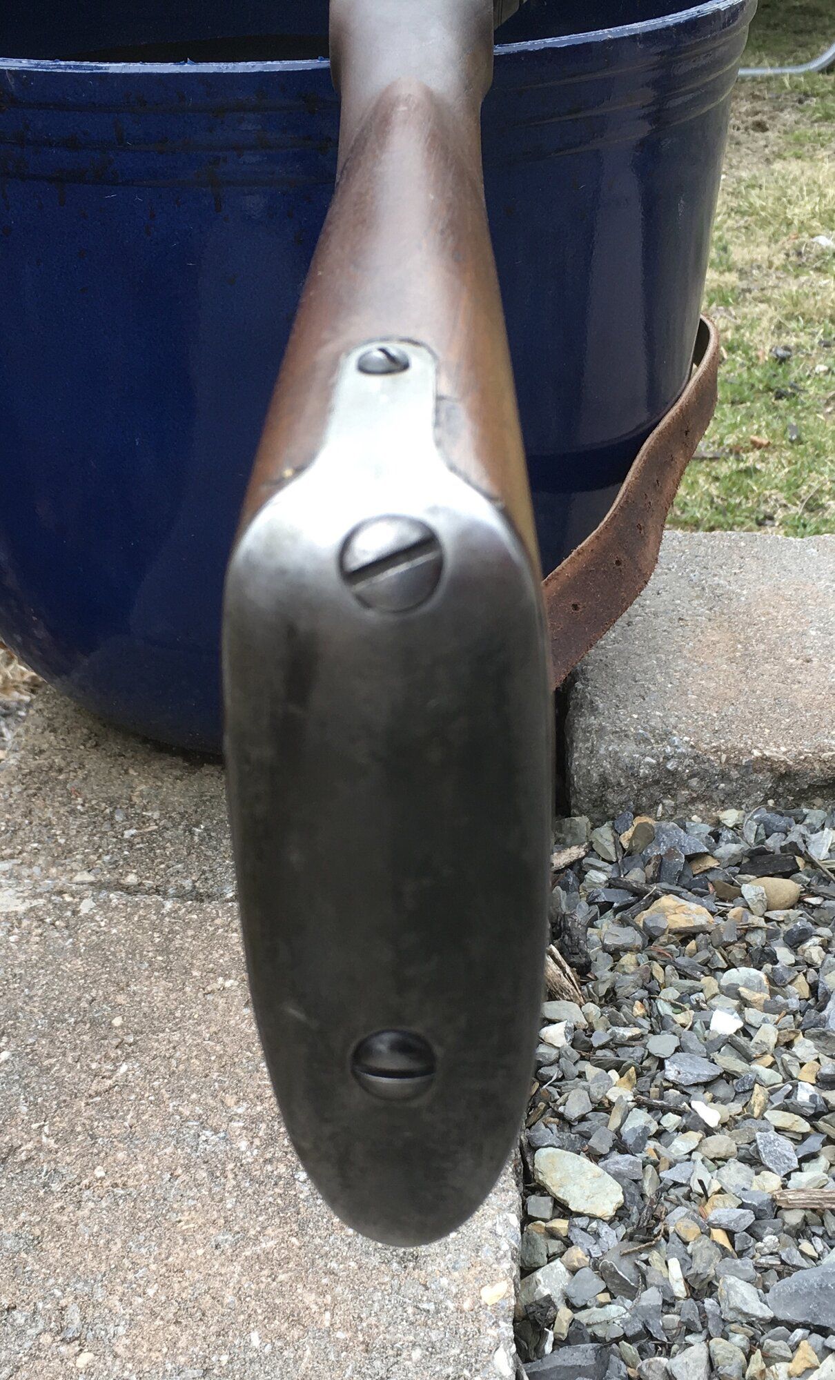

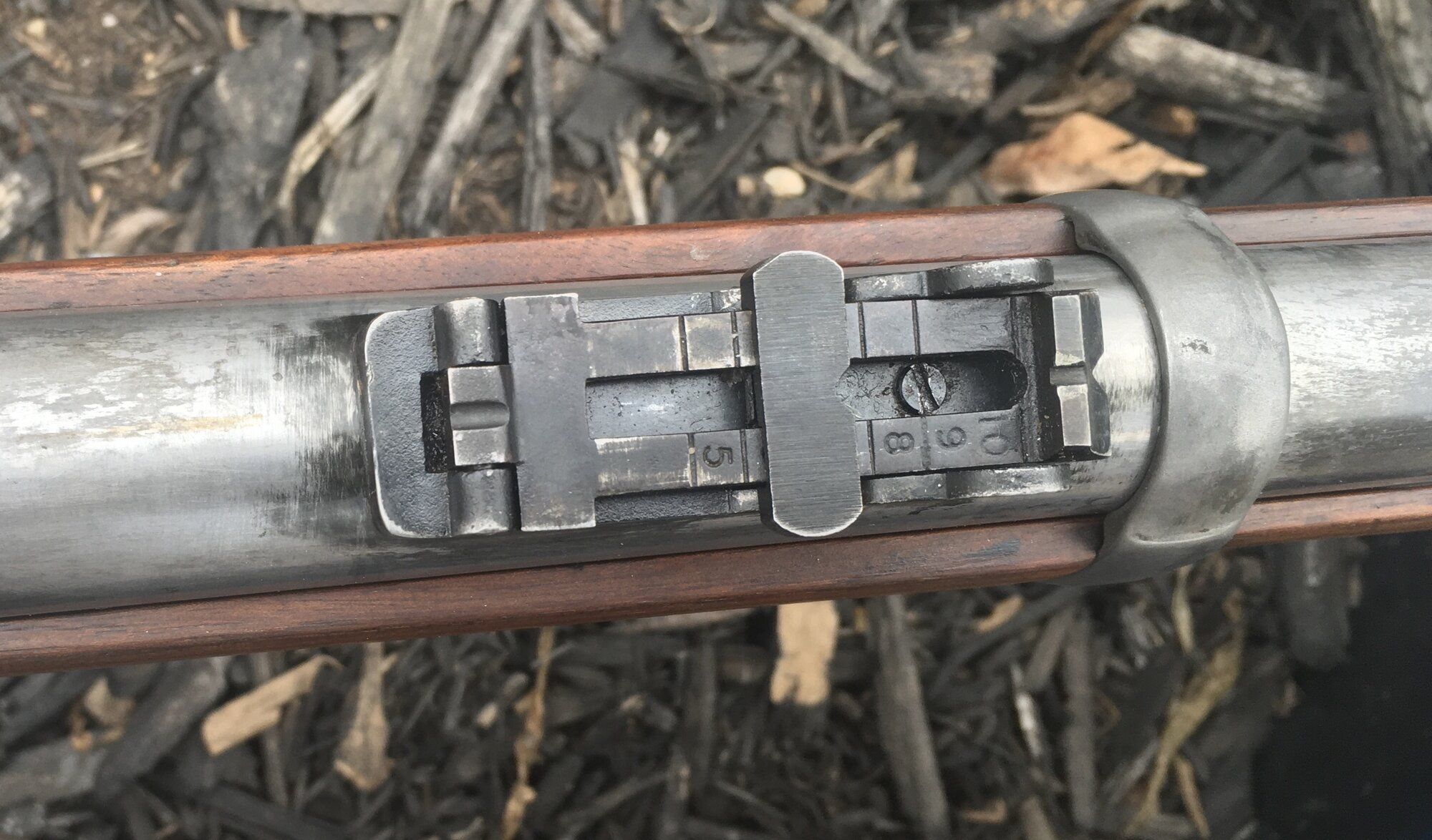

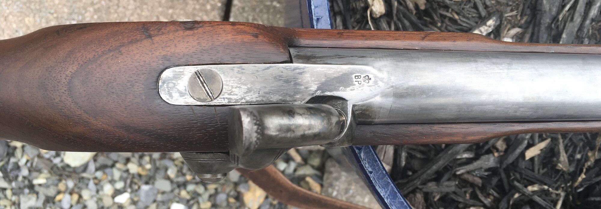

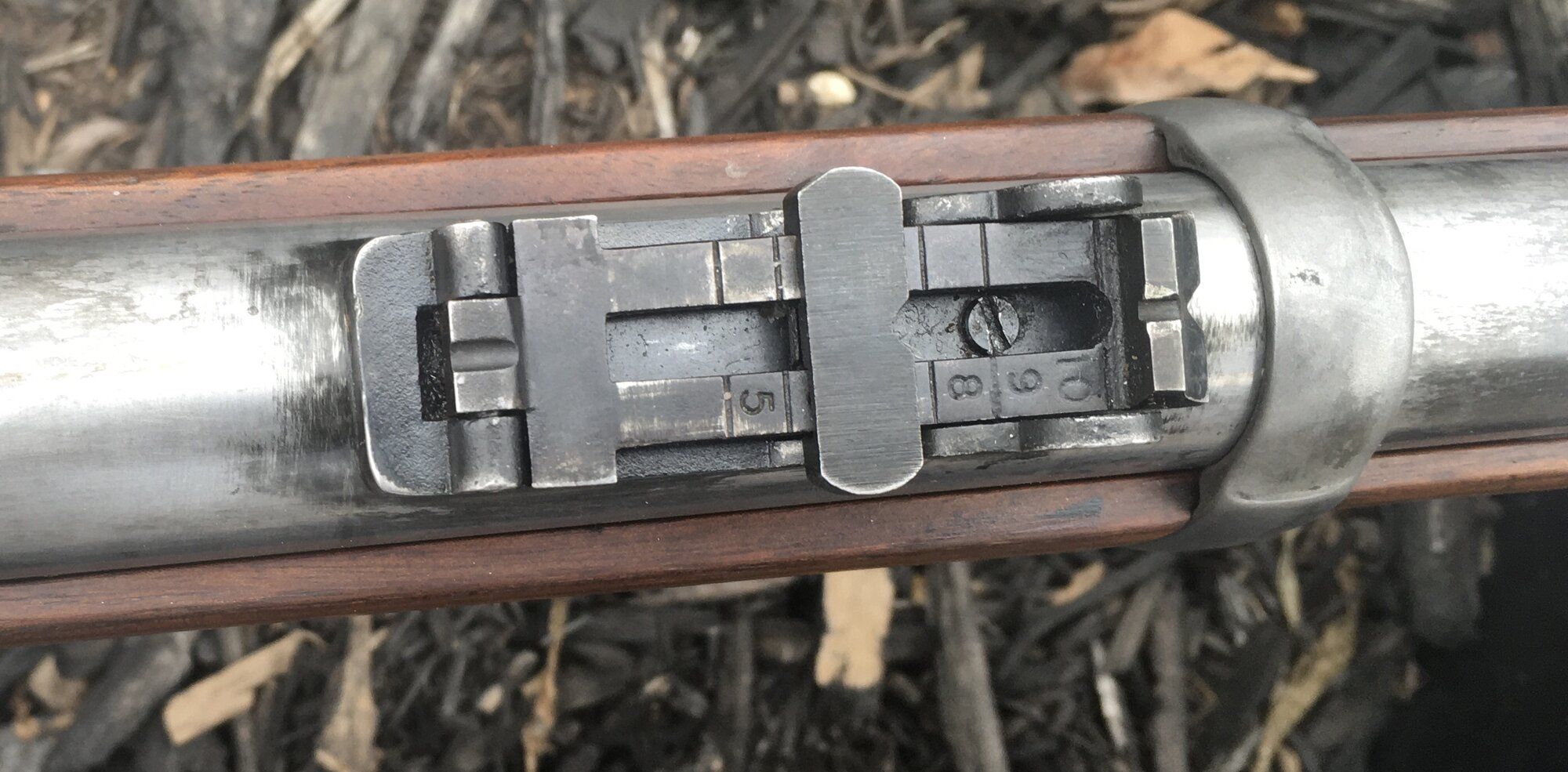

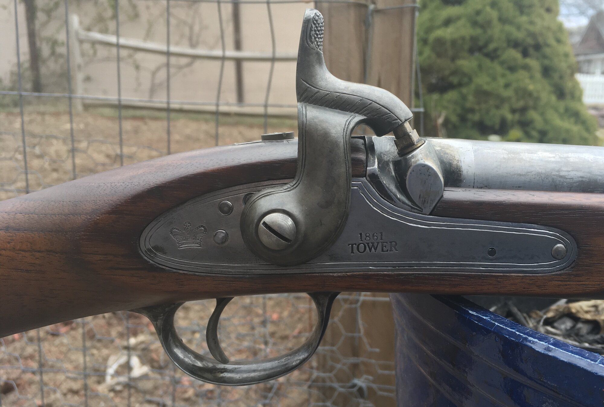

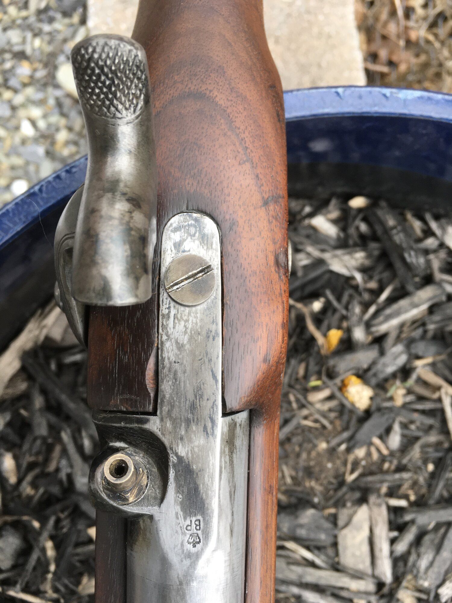

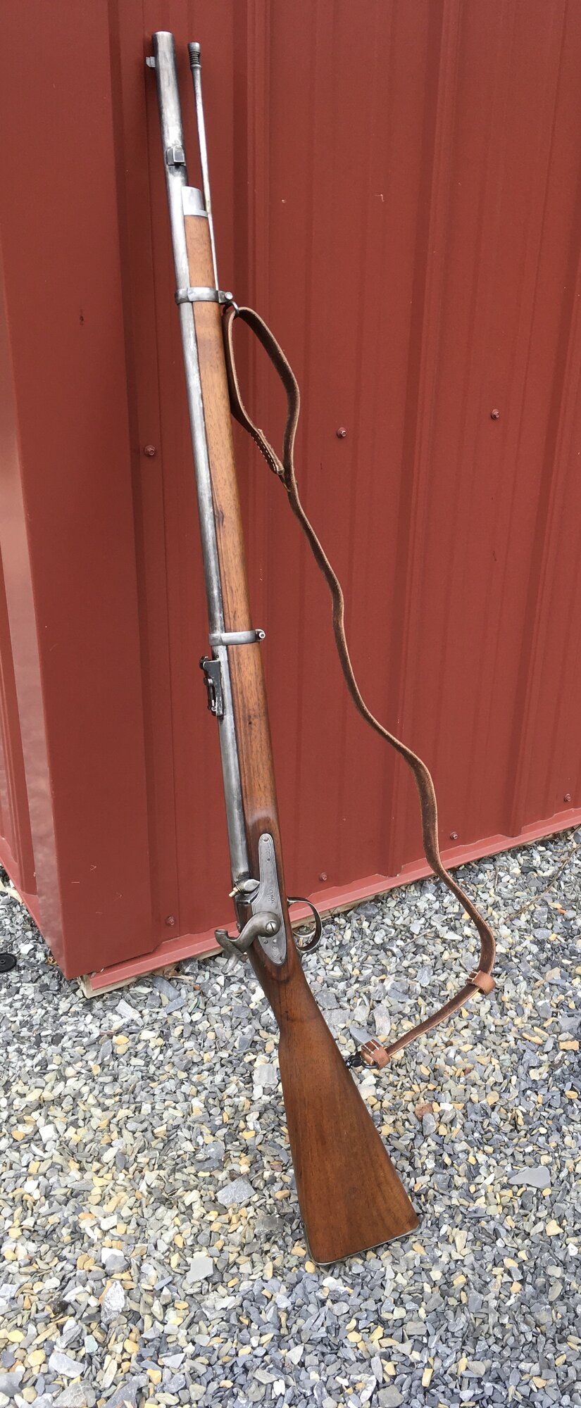

I finally completed the project! Basically it is an interpretation of what a P 60 would have looked like IF Parker Hale had produced one. I am quite happy with the finished project. In NO way am I trying to pass it off as an original. It is NOT a "defarb". I left the PH stamps as if it came from them. The only PH stamp removed was from the lock plate. This is the original plate to the rifle, just restamped as Tower 1861.

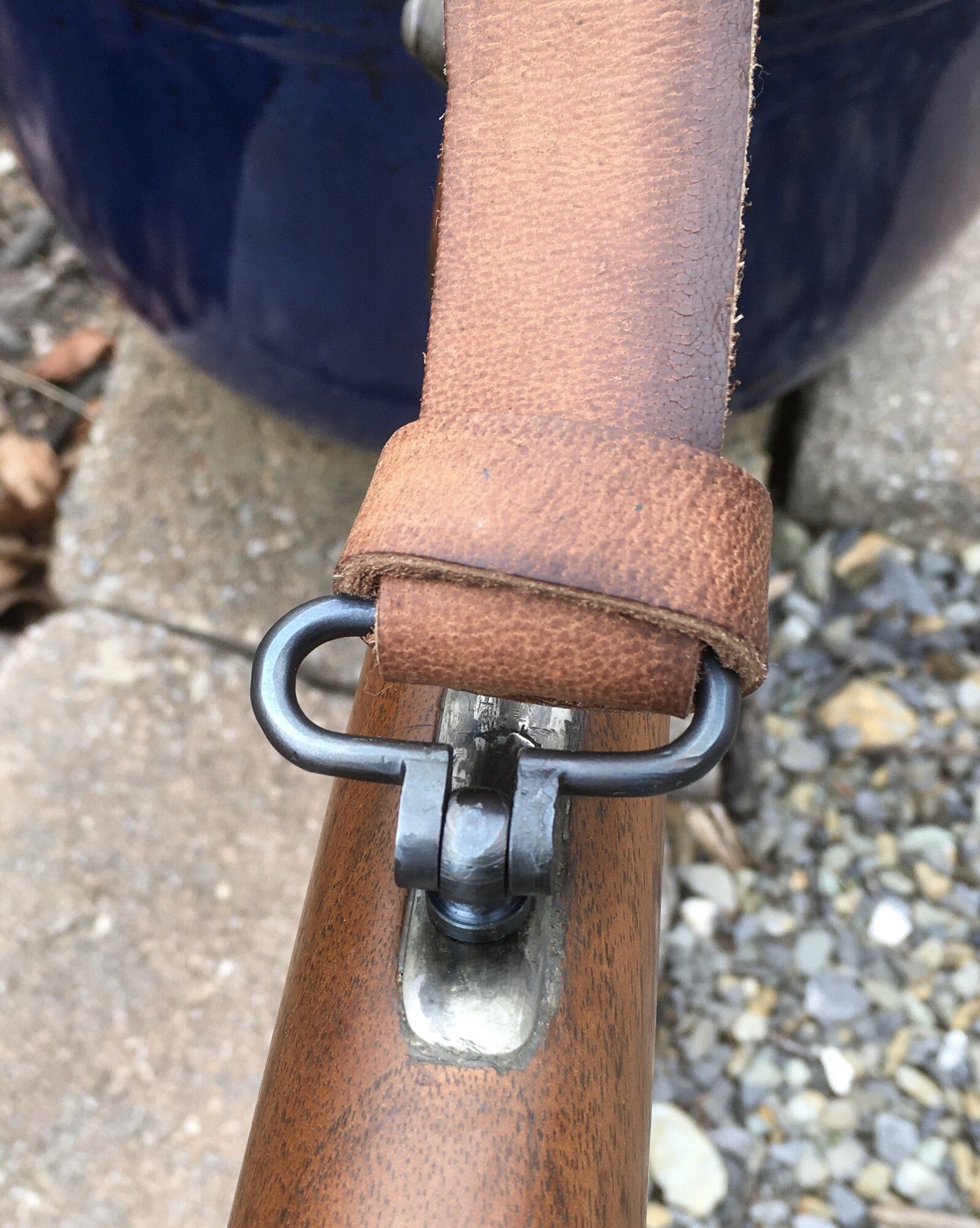

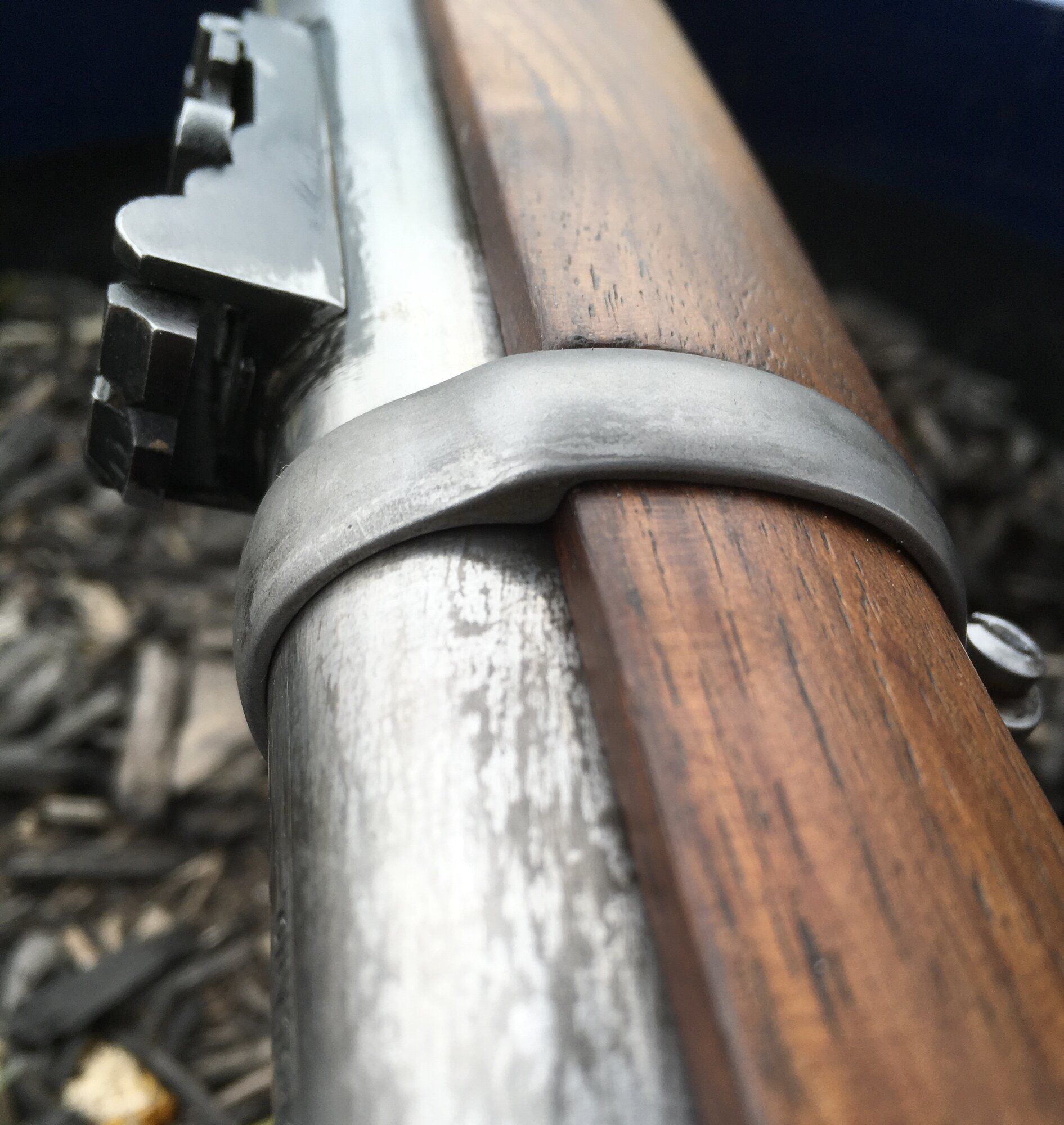

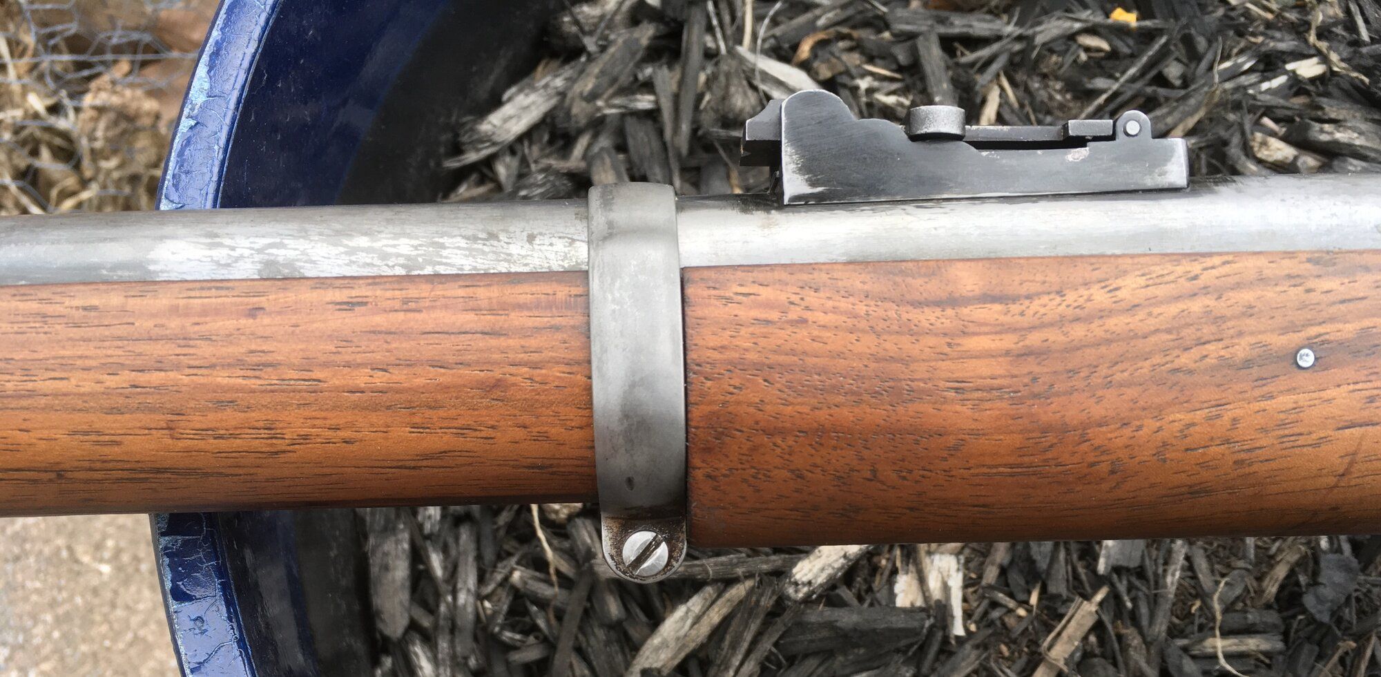

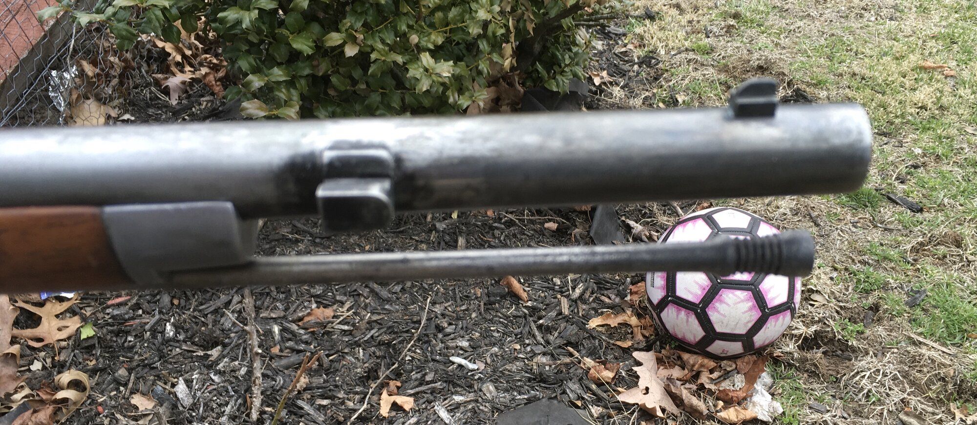

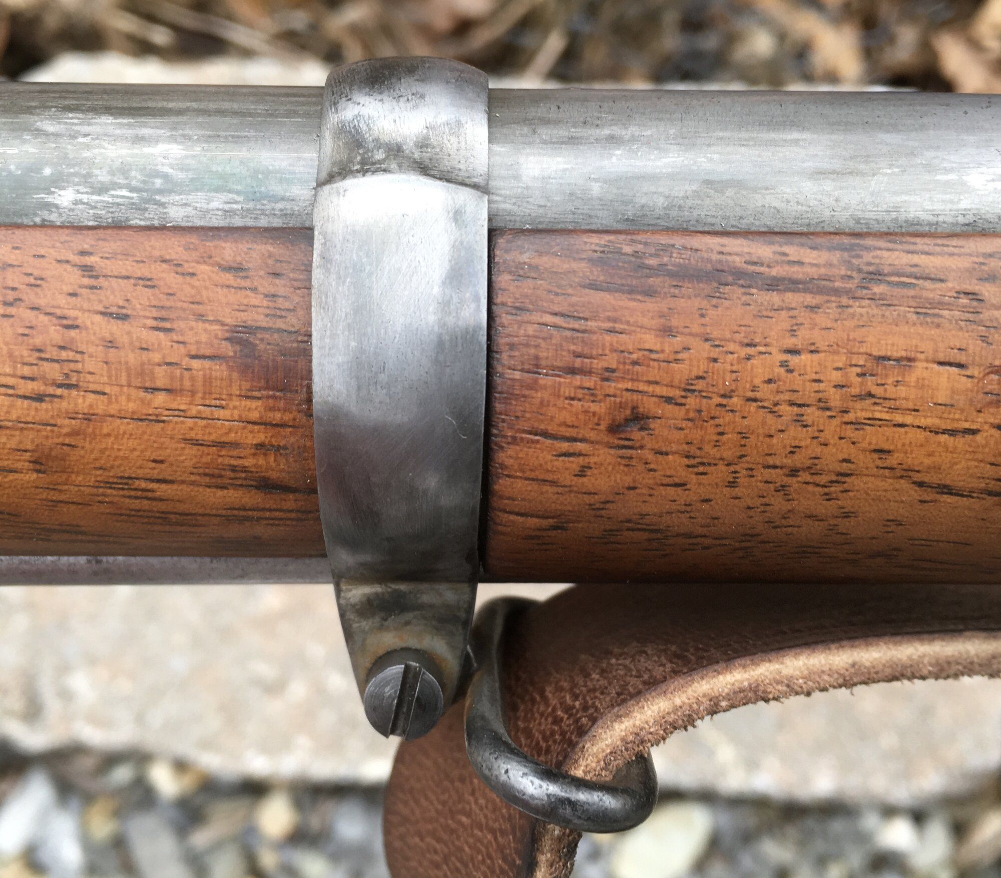

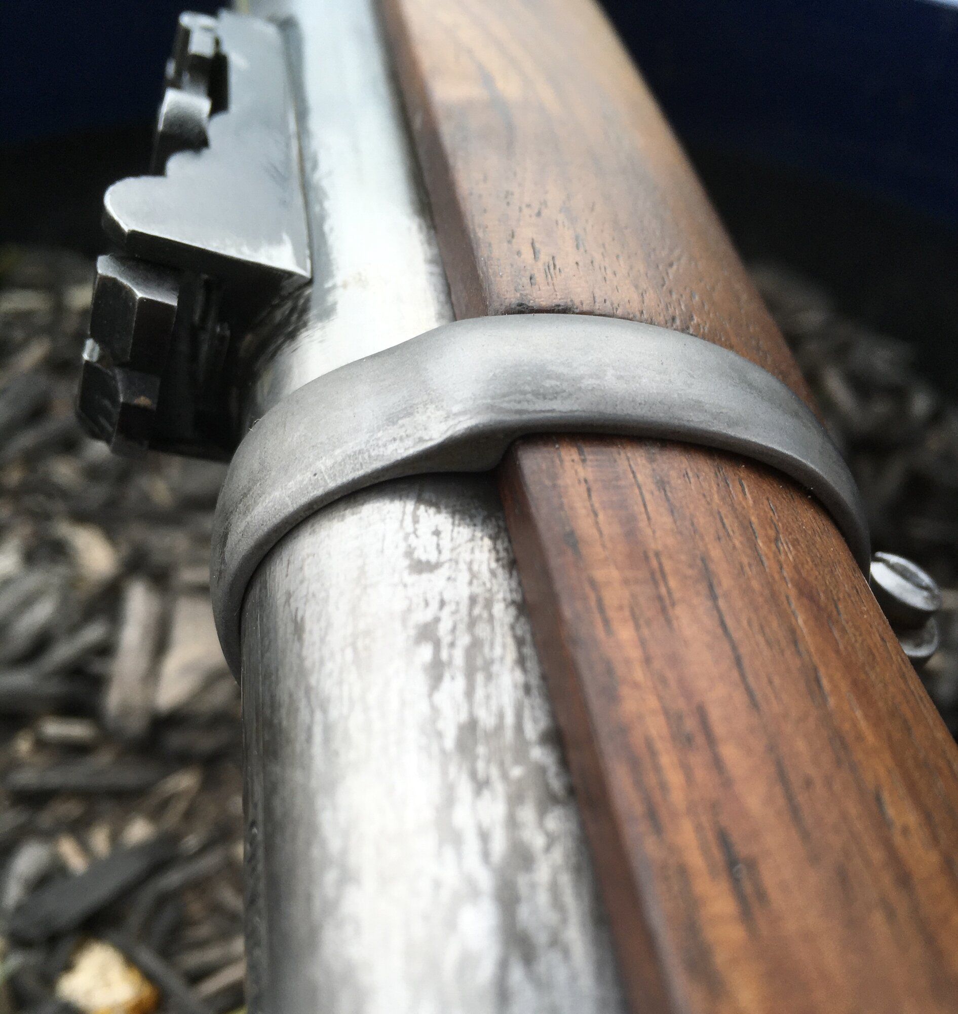

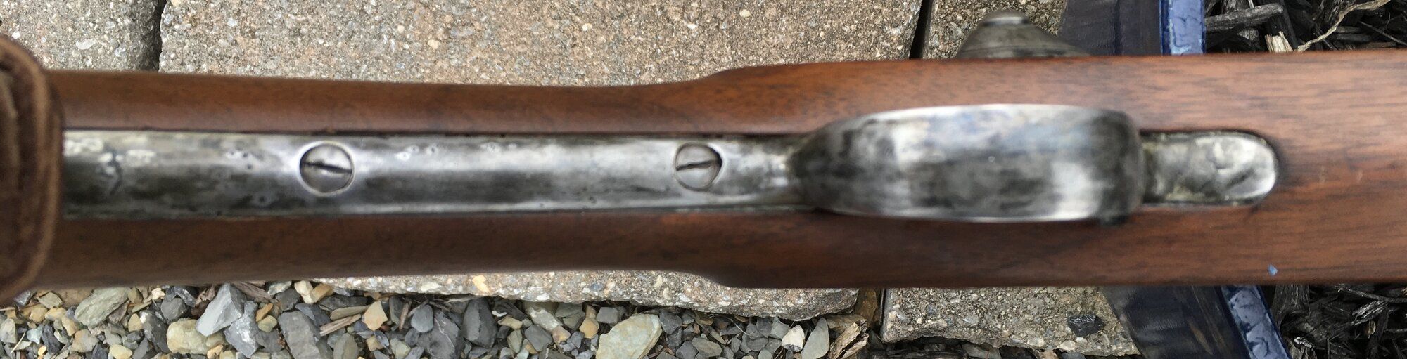

All the parts are out on the market, you just have to search. The rear band is an ArmiSport band, and the front is the original PH band, just modified to have better contour lines. Both have Palmer screws. The front sling swivel is the correct centered sling. The rear sling swivel is from Peter Dyson (as is the trigger guard) and the butt plate from The Rifle Shoppe. It may look like poor fit to finish around the trigger guard, it is not. What you see is a buildup of linseed oil and beeswax. I left it there for weather protection.
The finish to the metal is…..uh…..unique! 😂 I constantly have seen the argument/discussion on Blued or In the White. So, my take was, how would an imported Enfield look after three years of heavy service? Routine cleaning, slight burnishing, weather, etc…..leads to worn out bluing. Not quite blue, but not quite bare metal. So, I used Birch Wood Casey , Brass Black. One pass, moderate rubbing with a cloth on bare metal. This was the finish, co erred with a "burnishing" from a wax candle and rubbed with a soft cloth.
S&S Enfield sling for the rifle. This rifle is going to be a plinker/hunting rifle. So, for me, a nice representation of the P 1860.

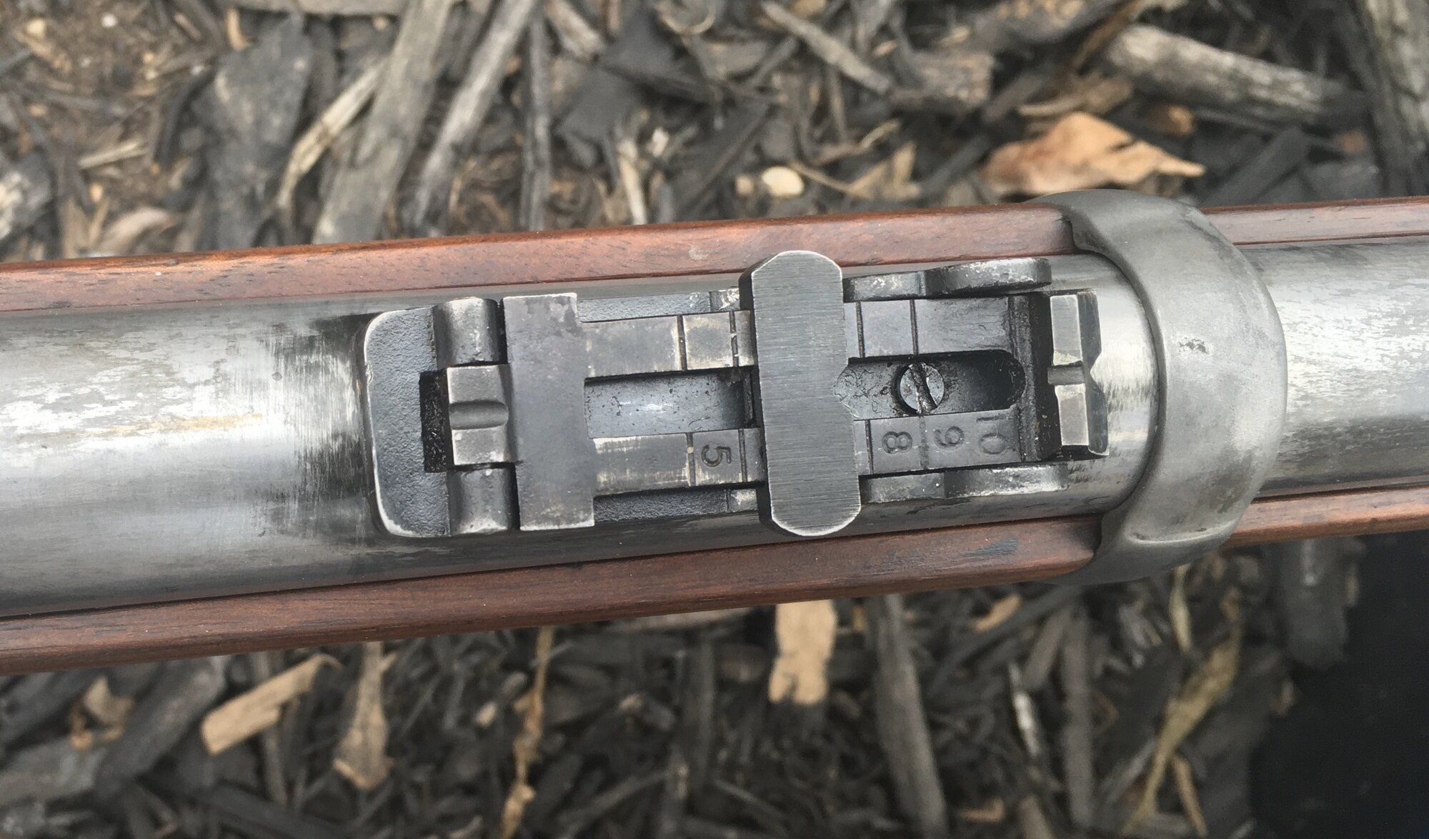

I hate to be a wet blanket but the wood stock is really nice. Pristine almost. If you are going for a campaigning for 3 years of the war look with the barrel blueing I think the.stock would be banged up a little as well. I have a Remington Zouave re pro that I got from Pony Express gun store in Encino, CA in 1976. I used it in my early years of reenacting. I take casualty as much as I can in battles. I'm good at it. People have come up to me to make sure I was ok because I can time a bullets travel from live firing that rifle a million times. Fun but that rifle took a beating. The point I'm getting to is that the stock is dented and missing finish in places and blemished all over. The bluing is still pretty good. It's hard to see the rifling in the muzzle but the bluing is ok.
Just a little food for thought. I'm not suggesting that the stock should be aged or anything. Maybe an alternate stock that's not so pretty could be employed.
Just to let you know, The stock was stripped and redone with just linseed oil and beeswax. I based it off of a stock I have from an original enfield that is JS anchor marked, but is a P56. The stock on the 56 is in as good condition as the one on the PH.
Not disrespecting your thoughts at all, and quoting you, not to be a wet blanket, but not every solider fell during battle. If I read your statement correctly, you "fall in battle" quite frequently. With that being said, you must be rather abusive (not meant to be derogatory, just an observation) to some of your equipment. Granted, you take pride in your representation of the combat simulation. BUT, in reality, how many firearms were issued and reissued several times in a war? Even if it was reissued, if it was in poor or damaged condition, it would have been sent to an armory for reconditioning.
Also, this rifle would not be a standard issue rifle. The P53 and the P56 were three land and groove rifles in 1:72 twist. The P58/60/61 rifles were five land and groove with 1:48 rifling. With that information, it was standard policy (Mainly with Confederates) to issue the P56/60/61 to skirmishers/sharpshooters (equivalent of "snipers") in the troops. Those soldiers were not standard line of battle troops in campaigns. These rifles were coddled and prized. Needless to say, they were not exposed to the same rigors as a line of battle front line rifle.
Again, this response was not to disrespect you or belittle you, but just to give you an insight to why the stock is not as "damaged" as you would believe it would/should be.
