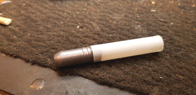

Pictures always help i guess,albeit this then a cartridge for a different paper cartridge rifle. The French Chassepot Mle1866.
The bullet is a regular 457/500 roundnose gov 45 caliber one. The Chassepot,like most paper cartridge rifles,lack means to register the cartridge really.
In the case of the Chassepot the "forcing cone" part of the chamber is just..insane. Thus Chassepot shooters,before this,needed a full target to register hits at a mere 100 meters. The rifle being known to shoot far,just not very accurate.
So what i did was slug the bore to find the minimum diameter. The bullet in case is at least reasonably long why i chucked my alloy bullets into a lathe and turned minimum body diameter for a greater part of the bullet down so the bullet can actually be shoved into the bore and come to a rest on the actual rifling.
Of course while retaining rear so called drivebands. These were 0,459" as dropped while the part i turned down i did to 11.oo mm. This makes for a "true" bore rider. Ie;part of the bullet actually come to a rest on the actual rifling and thus gets guidance the instance you fire.
