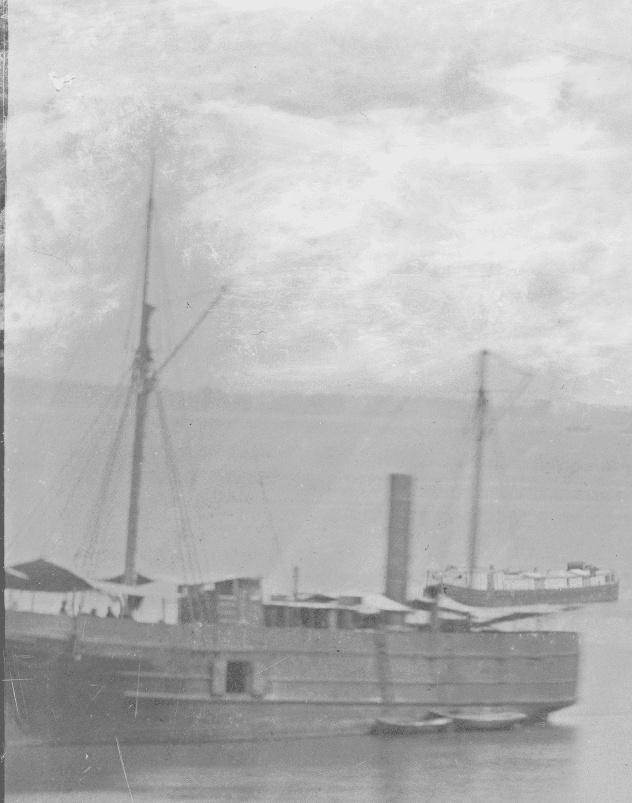

Some other interesting vessels I found in the same CITY POINT, VA series.
This looks like an old schooner with the bulkheads built up.

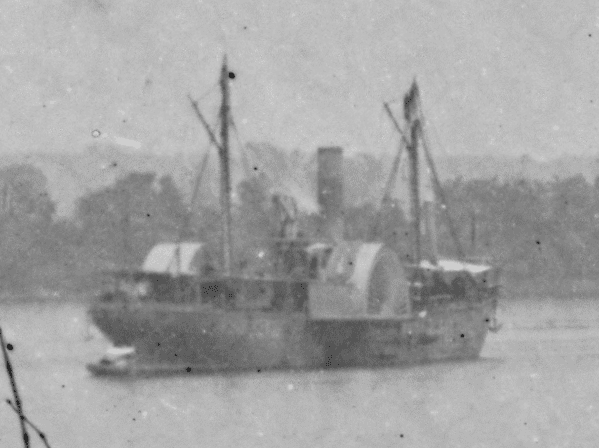

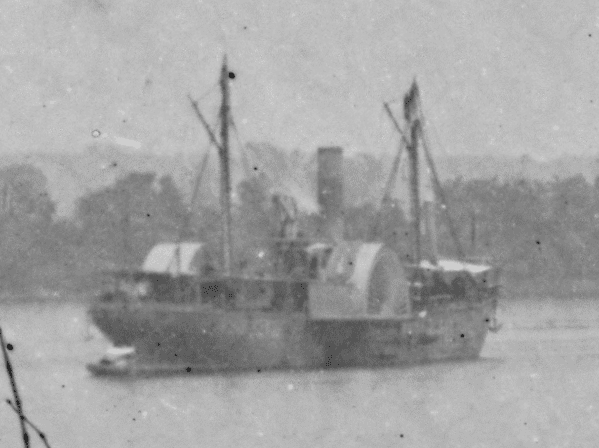

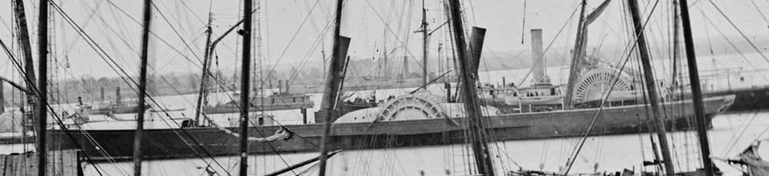

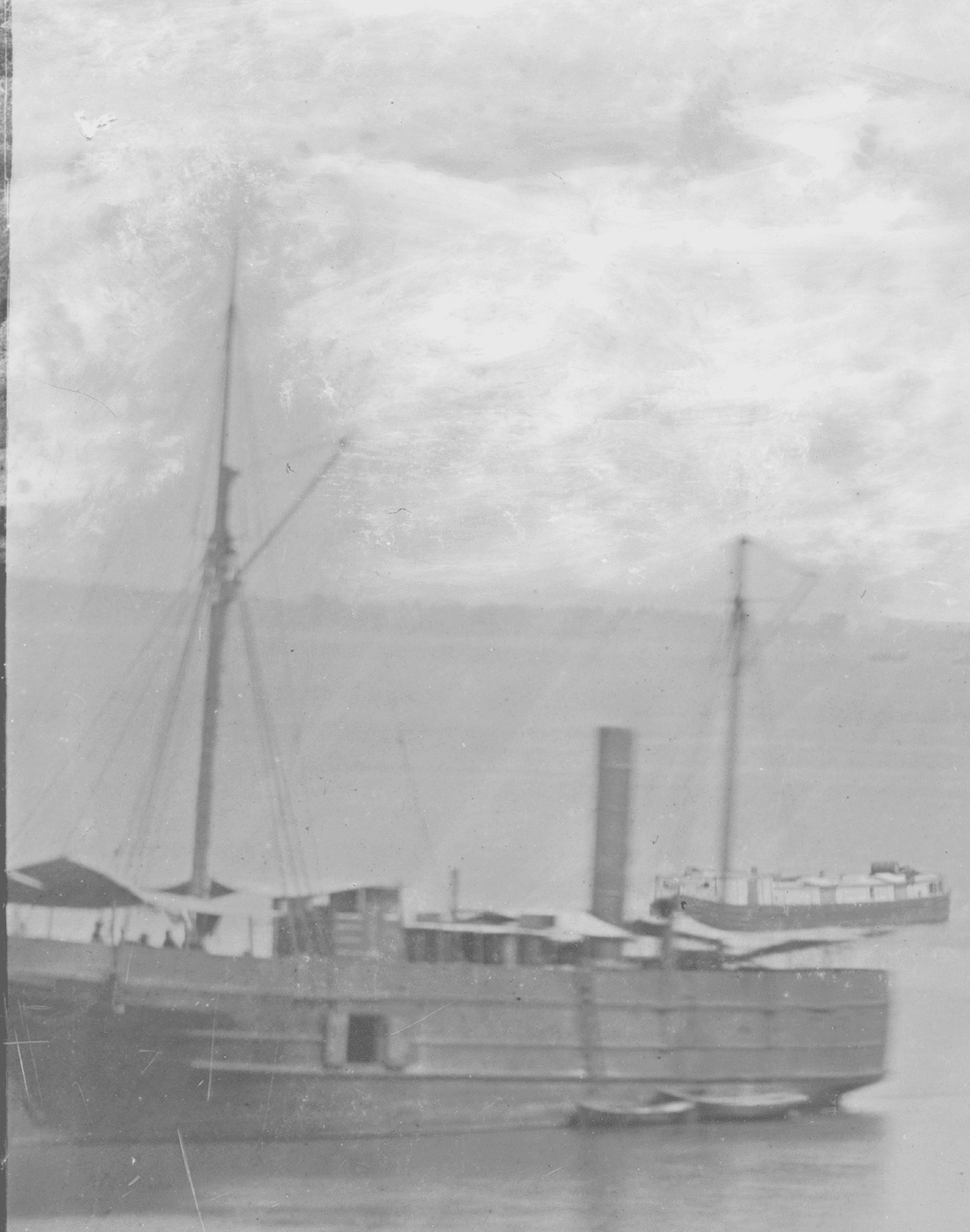

This is a full-resolution copy of the detail image that the author of the linked website in the OP says is "fairly sure" is U.S.S. Banshee, a former blockade runner captured in November 1863 and taken into the U.S. Navy. That may very well be the case, as the vessel shown closely resembles an 1864 painting of that ship by Samuel Walters, which is now in the collection of the Merseyside Maritime Museum in the UK:
This is extremely interesting to me, because I have tried to document every warship which made it to City Point or further up the James on my Petersburg site. Looking at the various list of vessels different for points of time, I had not been able to confirm the Banshee had made it to City Point. Now I need to add a page for the Banshee at my site. I do still need to go through ththe ORNs, volumes 10-12, page by page, to find the stragglers. This just gives me a head start!
Update on this one, and I should have posted it sooner. The vessel identified as Banshee cannot be Banshee. Phil Ireson, who runs Spithead Miniatures and is an expert on British-built blockade runners, assured me she was NOT the Banshee. Phil laid out his case and I agree with him:
Initial email from Phil:
Hi , the vessel pictures is the Hope not the Banshee . If you want to discuss why this is then please fell free to contact me. The Liverpool Maritime museum have done a great disservice in wrongly attributing that painting as Banshee.
My reply:
I was hoping you would contact me. With a name like Spithead Miniatures, I figured you had done original research on British Blockade runners. I wondered about that painting because the painting looks like the ship pictures.
I'm always open to new assertions. My goal now is to try to figure out a few things:
1. Try to find a reference in the newspapers to the Hope (renamed Savannah on January 11, 1865) departing from or heading for City Point.
2. Try to find out when Hope was sold at auction. I would assume on or close to Janaury 11, 1865. Also try to find out to which port she was taken after capture.
3. Ask you for what other Jones Quiggins vessels could have been captured and used by the Union Army at the Siege of Petersburg.
4. Try to identify other dates on which the Library of Congress image could have been taken. If that ship is the Hope, then that image could not have been taken in early December 1864 as has been claimed. That's okay though. It is not uncommon for dates to be wrong in American Civil War images.
5. I noticed there were two Banshees. Are you positive the model you referenced is Banshee I? That's the ship which was made into a US warship and was definitely on the James River at City Point as part of the North Atlantic Bloackading Squadron. If you can show me through the model what she looked like, I can go actively look for her in the existing images of the James River.
Anything you can give me helping with the above, links to the models you referenced, and just how you came to the conclusion the painting is not of Banshee, all would help me.
Brett Schulte
Email back from Phil with details in an attachment

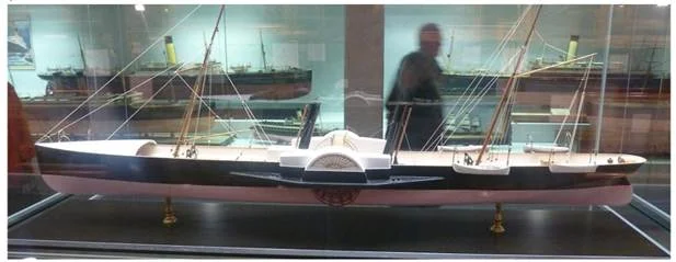

The picture below was taken at Liverpool's Maritime Museum, I have also included two pictures of her, the first made post war and the second painted while she was coaling in Ireland before leaving British waters.
Take a look at the model of PS Hope above from the Liverpool Museum and compare this to the Painting by Samuel Walters (also above) and you will see that the vessels are identical in form. Look at the double fret paddlebox, a design only used by Quiggins, look at the rounded guards either side of the paddle box, again a feature unique to late war Quiggins vessels . Rounded guards can also be seen on other Quiggen's ships like Bat, Dream. Lamb, and Rosine , they were a signature of late 1864 Quiggins designs.

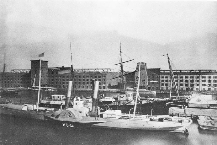

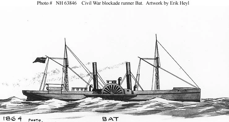

Hi Brett you are correct in thinking that the Bat would look like the Hope as they had many Quiggin's design features in common. Here is a picture of her made in Ireland on her way out. She has the spoon bow, the rounded paddle guards and like several of her Quiggin's predecessors she has a small pilothouse mounted high up between the paddle wheels. What you cannot see here is the double fret paddle box design as she was painted black to fool Union agents. Please note the distance between the forward deckhouse and the fore mast and more importantly the height and small size of her pilot house when compared to Hopes lower and longer pilot house that is slightly forward of the wheels
The picture below shows the Bat as the post war vessel Teaser, you will note that she still has one of her rounded guards in place but her paddle boxes have been replaced during a refit . Please note the smaller distinctive pilot house which was part of her build in line with her paddle wheels. The forward deckhouse has been removed to gain better access to her hold but the aft one is still in place. She looks very small here but don't be fooled as the next picture shows her sistership the Stag in the post war guise of Secret

Apart from the difference in size between Hope 281ft and Bat 230ft the main feature of note is that the picture taken of her during the war shows a low pilothouse slightly forward of the paddle boxes.

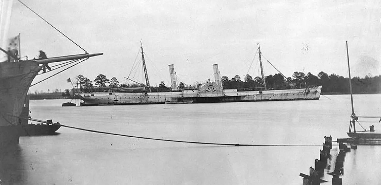

I have always been certain that the picture below was the Hope but what you say is interesting because I am no longer as sure as I was. She might well be the Bat or even the Stag , the only thing I can say is she is definitely not the Banshee and this vessel was certainly built by Quiggins. I look forward to your findings with interest as they could be key to identifying the name of this ship.
All I can go off is my gut instinct and the overall impression of her size and the fact that the portholes in the guards match the Samuels painting plus the Bat class seemed to have a line of portholes aft of the paddle boxes which are not apparent on the photo below
Final email from phil explaining why he thinks this is Hope:
I am going out on a limb here and backing this vessel to be PS Hope over USS Bat and here are my reasons .
No guns are evident.
The paddle box centre patterns are slightly different to Stag (Zenobia) and Secret which were both smaller vessels.
The ratio of funnel spacing to mast spacing is different when compared to the Bat class (this does not depend on the angle of the photographed ship as the ratio will stay the same)
The ratio of funnel spacing to paddlebox diameter does not match either the Bat class or Secret.
There is no evidence of stern decoration on both Bat class vessels but they appear in the picture at City Point and on the Samuel's painting of Hope .
The strakes on the sides do not match the Bat class or the Secret .
The ratio of the documented length of Hopes lifeboats and the waterline length of the City Point vessel match within 2% of accuracy.
I would have expected to see a Naval ensign on any US Navy ship, she doesnt even appear to have a jackstaff .
Nothing conclusive I admit, but it all stacks up. There are only six possibilites given that she was definately built by Quiggin's, these are Hope, the four Bat class vessels , Bat, Stag , Deer, Owl , and the Secret. We know little about Deer other than she was later sold on and named Palmyra and nothing about the Owl apart from rumours that she was in the Gulf at the very end of the war.
The only book in my collection I would recommend to you is Stephan R Wise's "Lifeline of the Confederacy" as it has potted histories of each runner . I would also recommend any of Silverstones books .
cheers Phil.
I'd be interested to see what some of you Civil War naval experts think about this exchange. Does @AndyHall still post here?
I believe the blockade runner is the "Savannah."
Gibson and Gibson, Dictionary of Transports and Combatant Vessels Steam and Sail Employed by the Union Army, 1861-1868 says: SAVANNAH; sidewheel steamer; 1818 tons. Formerly Confederate blockade runner HOPE. Chartered Mar 17-Sept 4, 1865.
It was captured October 22, 1864 and sent to a prize court.
Miles Hai
seeingthecivilwar.com
Miles, agreed! Assuming the picture is indeed the Hope, it was renamed Savannah by the time the image was taken. And there are no signs of any weapons on deck, so the image was of a civilian vessel, not a converted warship. I'd really like to narrow down the date when the photo was taken more than "After October 22, 1864." I need to go do some research in the papers and find the dates Savannah departed places and headed for City Point or vice versa. That could narrow the dates down quickly.
The Savannah / Hope ( good name for a blockade runner that ) was an auxiliary vessel not a commissioned gunboat.
The commissioned USS Savannah was very different.
Navsource Photo Index
For details read more here.
Link
Yes, good point. The warship USS Savannah was never at City Point during the Siege, or if she was, it would have been brief, at least according to the Navy ORs and my other independent research.

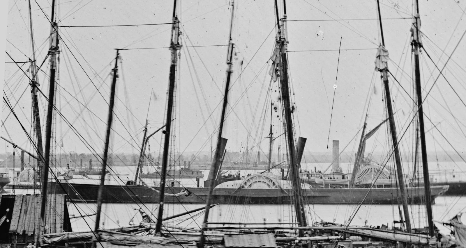

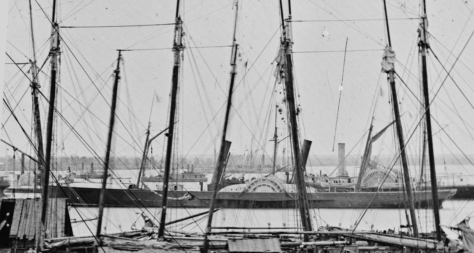

The vessel pictured at the head of this thread has a definitive profile. Her raked funnels are fore & aft of the side wheels. That is very distinctive but not unique.
