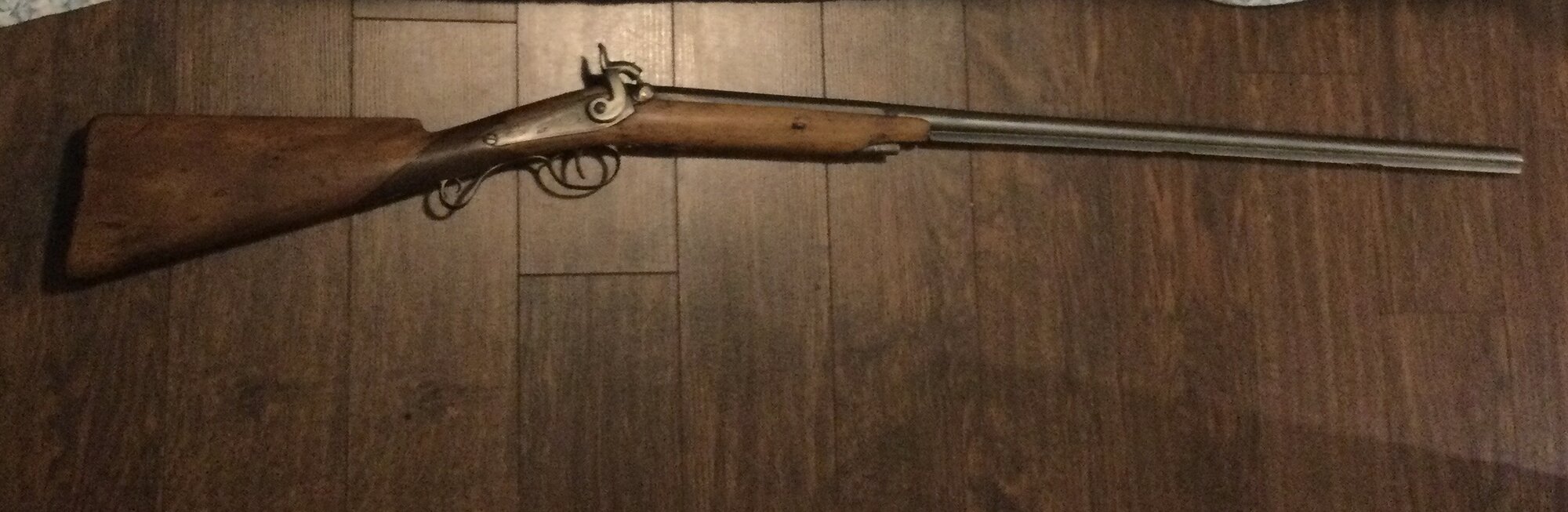

Morning al
My name is Bob Fournier and I was just given my Great Grandfathers Musket Gun.
He was born in 1850 in Quebec, Canada and settled in Mont-Louis Quebec.
I was hoping someone could give me information on the gun and hopefully try to find some of the missing parts.

What a beautiful survivor! Fantastic that it has stayed within your family. I'm only an apprentice level Gunsmith but I would highly recommend not doing anything to it but gently cleaning and oiling to preserve her beauty. It looks like you're only missing the ram rod which is probably the most likely part to be missing and a hard one to find. Luckily, speaking for myself, I think a reproduction ram rod is the only fitting compliment you could add.
I'm not an expert on makers marks but it is likely European by the crown shaped one, speculation off the photo of course.

Yes the ram rod is missing and I don't even know how it connects to the barrel and the other part missing is the butt Plate at the other end.

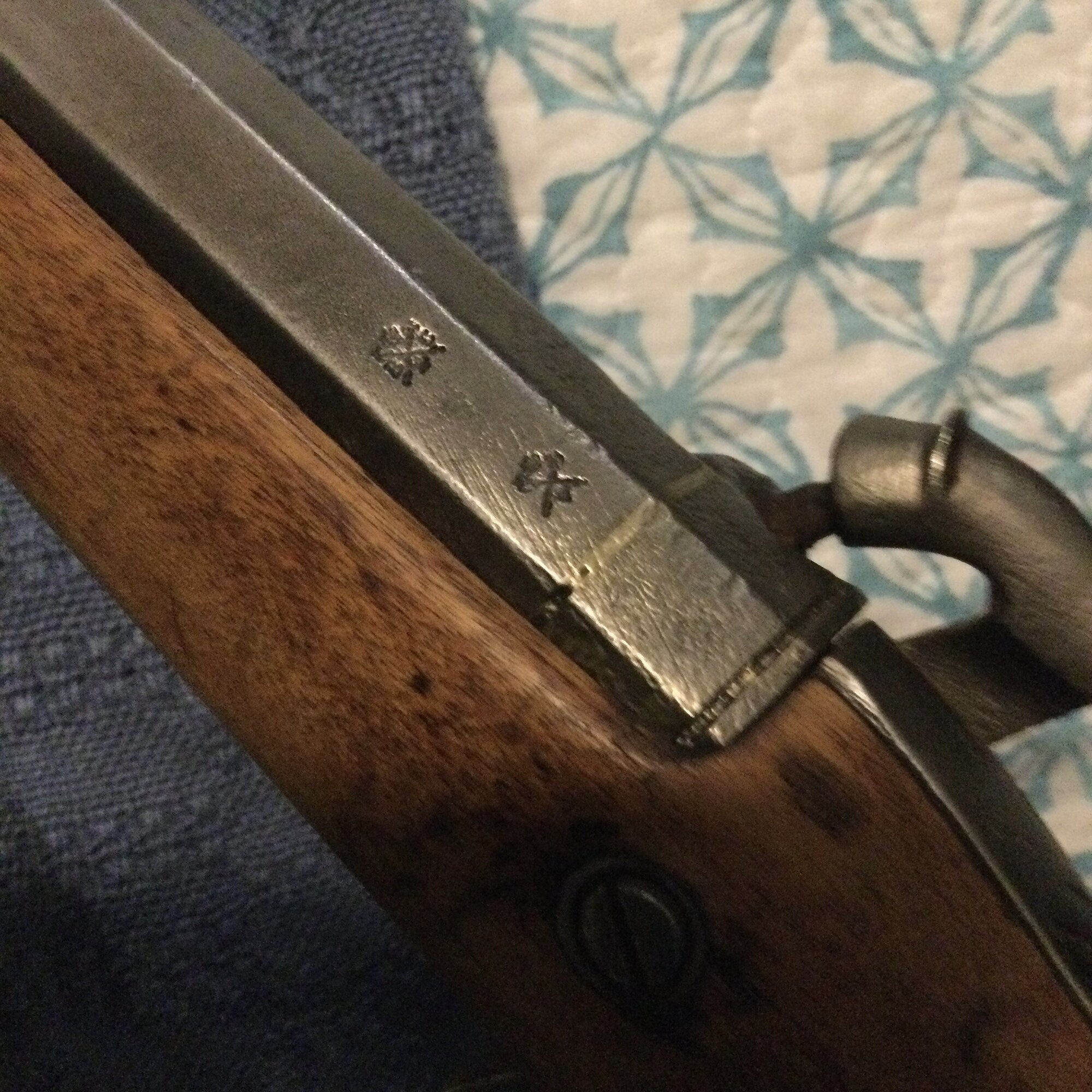

I've identified markings as Birmingham marking so definitely a British gun. I believe it was made between 1813-1904.
Is it a Musketoon? Because it is shorter then a regular Musket 47 inches.
The two markings on the barrel are British.... Birmingham proof and view stamps from the mid 1800's. So the barrel, at least, is from England.
That would fit with the gun coming from Canada.

It has what's known as a "back action lock" because the mainspring is in the rear of the lock. Looks to be a pretty typical 19th century shoulder gun, but it's really nice that it's still in your family. It's also a good reminder that not everyone was taking a state of the art gun out hunting. By the time your ancestor was 20 years old, this gun was obsolete, but still functional. As long as you can get powder, lead and caps you can keep shooting.
It looks like the under rib is missing the thimbles that would have held the ramrod to the underside of the barrel. Another nice feature is the barrel looks to have silver bands inlaid at the breech.

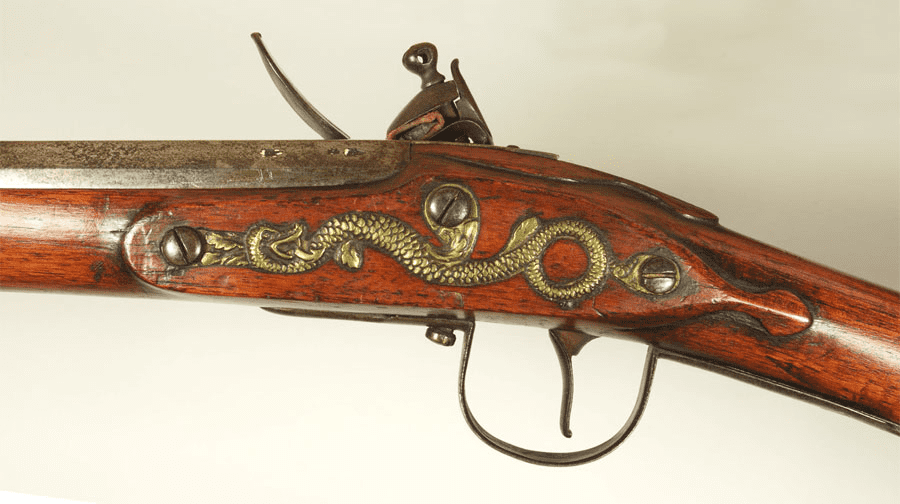

Northwest Trade Guns had a very distinctive what we would call a logo. This distinctive dragon plate was a fixture of flintlocks until 1877; cap & ball rifles until the end of the Century. It was not always this elaborate. Other examples
I knew almost nothing about Northwest Trade Guns before starting this search. The Longhunters that came over the mountains into Tennessee have been a long time interest. This was something new & the dragon plates are really something. The link is to the article where these images came from.

Personally, I don't think it's a parts gun at all. Looks completely English too me. I think the wood has been cleaned, the missing butt plate probably had a thin extension, maybe kinda pointed. Can't tell but it looks like it has one? Wedge holding the barrel to the forestock? The inletting is well done, and the architecture of the stock is Very mid century English IMHO. Stocks been overly cleaned.

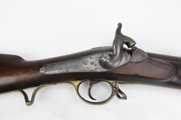

Most trade guns were flintlock of the usual pattern. The percussion backlock was quite high priced and appeared late 1830s/1840s. It is similar to the first pattern Brunswick rifle lock:

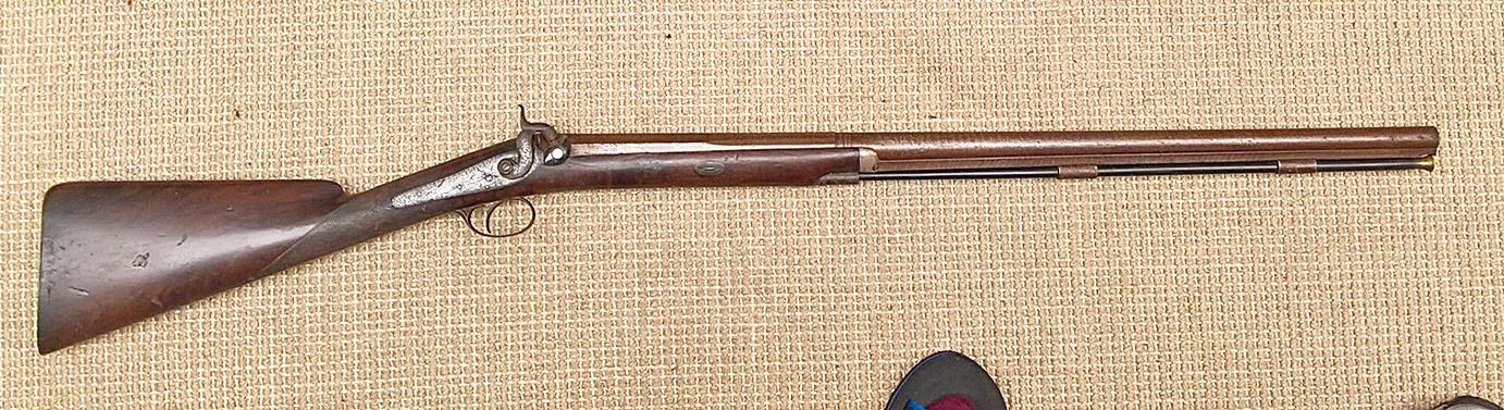

BUT, it is half-stocked with a straight butt taking a 'flat' butt plate, so likely to be British or Belgian. The barrel is a civilian one as it has the 'gold' band and is octagonal to round, almost certainly with a 'hook' connection with the rear breech face/tang and the triggerguard has no provision for a sling. It only has ONE wedge and the barrel has a rib underneath in typical civilian fashion. Yours has two 'spaces' or rounded areas where tubes would be silver soldered on to hold the ramrod. A typical example:
Removal of lock and barrel would reveal stamps and markings which MAY be helpful, at least showing assemblers marks like: X V l l (made with a flat edge into wood and metal (edges of lock!) which would prove a) age (pre 1860) and b) one assembly. It may also show makers initials, but tracing these can be difficult.

From your limited pics. The barrel does not fit well there at the barrel tang and stock. Look at that space. That hammer may not be original to that lockplate. Screws are all different looking, some look older than others. Fore end of the stock looks to have been cut down. No buttplate if it ever had one but most muskets of that time period had one. The rear tail pipe looks really low compared to where the other tail pipes would of been, maybe a very thick ramrod? Yes you been told a story of Family history but sorry to say many to include himself have fallen victim to that. Of course not saying in your case it ain't true. I inherited a supposedly French Rev War musket from dear old Dad when he passed along with a "story" on it. Well did my research and it was made 30 years after the Rev War ended. It was a popular model that was around for many years. The "story" total BS!
From your limited pics. The barrel does not fit well there at the barrel tang and stock. Look at that space. That hammer may not be original to that lockplate. Screws are all different looking, some look older than others. Fore end of the stock looks to have been cut down. Yes you been told a story of Family history but sorry to say many to include himself have fallen victim to that. Of course not saying in your case it ain't true. I inherited a supposedly French Rev War musket from dear old Dad when he passed along with a "story" on it. Well did my research and it was made 30 years after the Rev War ended. It was a popular model that was around for many years. The "story" total BS!
The fit at barrel and tang is because the barrel is hooked into the standing breech attached to the stock before wedging down. It is quite common in light shotguns used in Britain in the 1840s. It enables the barrel to be easily removed for cleaning in hot water without the possibility of damaging the stock and lock. (Black Powder shooter know what I mean) Yes, screws and even hammers are often replaced or added when missing too.
