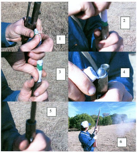

The picture posted is a friend of mine loading an Enfield cartridge, follows the rules give above by Gorgas. The pictures are numbered the order of sequence.
Kevin DallyView attachment 61089
