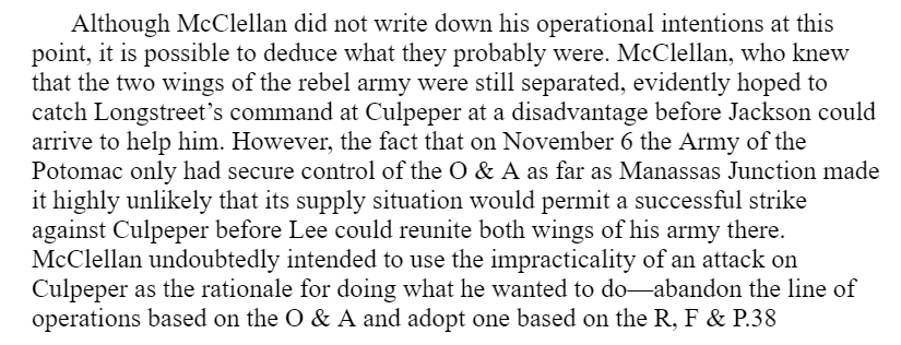

Here is what Ethan Rafuse wrote on McClellans intentions at the time he was relieved:
At the time of his relief, McClellans main supply depot was still on the Manassas railroad at Gainesville. It's doubtful he was planning on boldly marching to Gordonsville.
