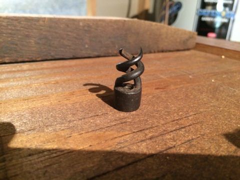

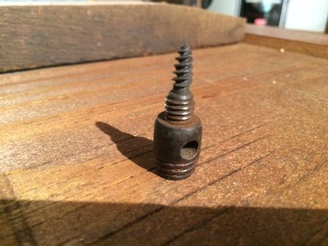

Below an original ramrod with a reproduction worm, I bent the worm prongs up a bit to get a better grip on a stuck patch.
I wish I could find a good worm to use with my .50 caliber guns. Most of my rods have 8/32 thread but a couple have 8/32 on one end and 10/32 on the other.
Most of my tools are threaded screws. I have used them on a few occasions but I don't trust them at griping onto a stuck bullet.
Do they make Worms with these threads?
Check w/ Track of the Wolf. They sell multiple different thread sized appendages.
