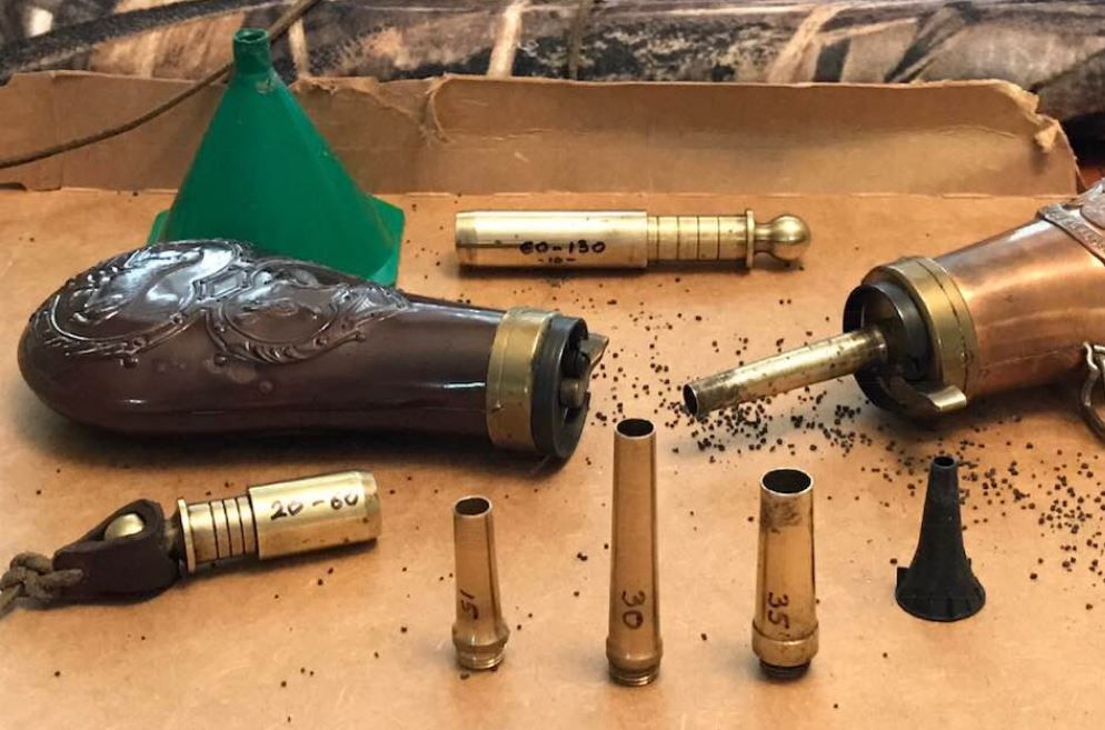

I took this photo of my flasks and the different spouts. It also shows 2 of my adjustable powder measures for loading consistent charges and experimenting with an increased or decrease in the load.
The small black funnel on the right is one that I stole from my Doctor's office---what they use to inspect your ears.
