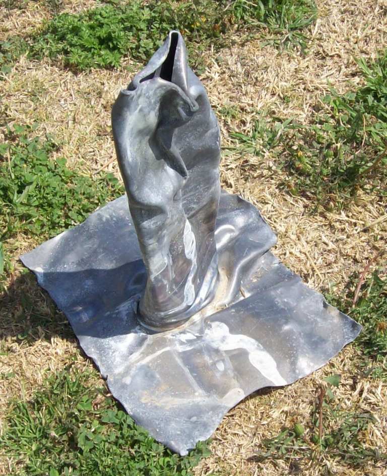

Be careful, wheel weights are now mostly made out of zinc! You don't want that stuff mixed in with lead. Your best bet is to go to a scrap yard, they usually have containers with lead, and get a supply of discarded old lead roofing vents. They are soft lead, make great ammo for muzzle loaders. As to your question, I have used pure/soft lead, wheel weights, and even harder lead for musket round balls with no problems. That is one reason I like shooting a .69 smooth bore, you don't have to be picky about the lead, lubrication, sizing...just stuff the ball(s) down the barrel and shoot!
