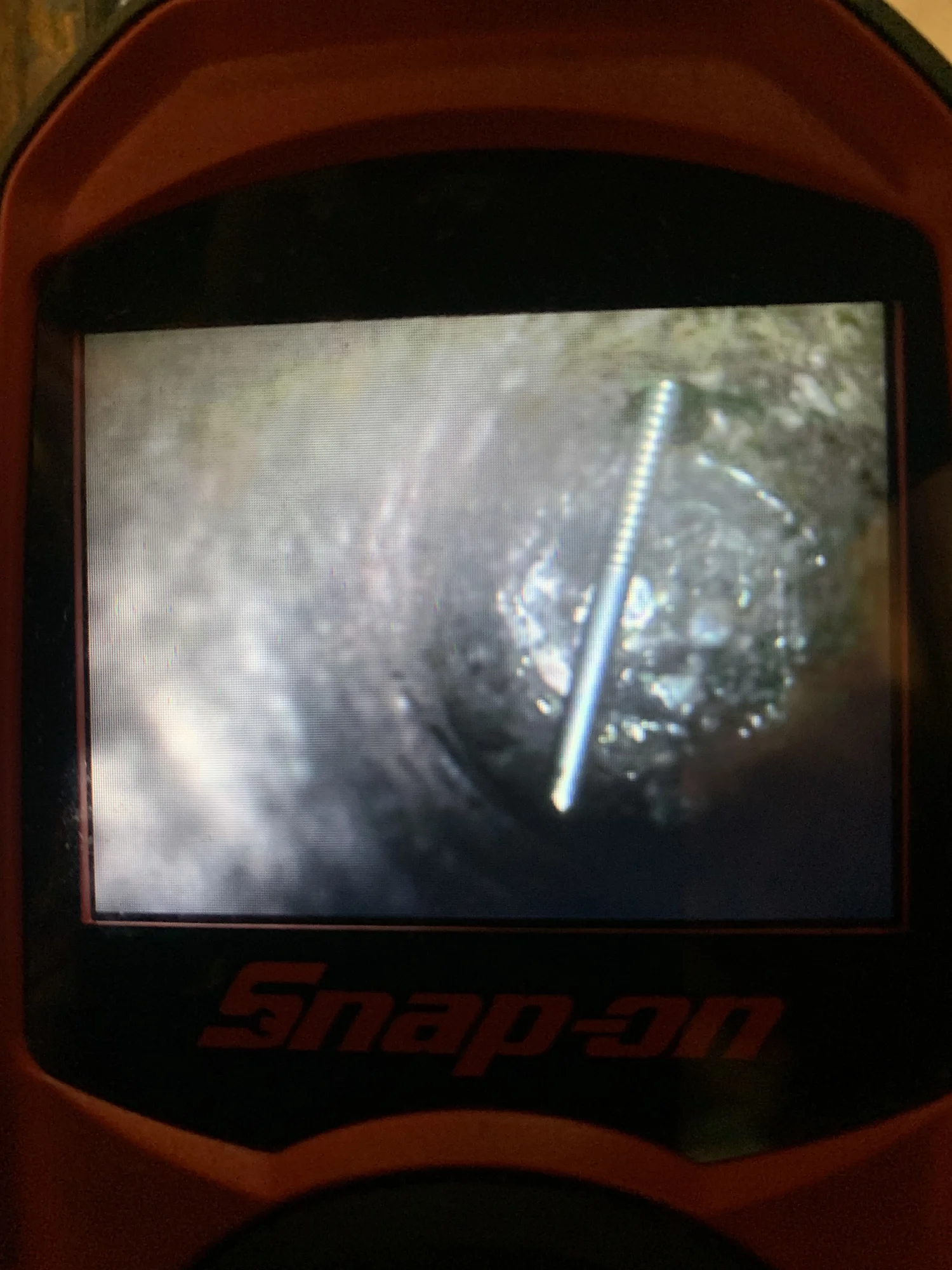

I picked up a nice M1812 made in 1816 and there is a ball in the bore. I used a snapon snake camera and it sure looks like the flower of a paper cartridge. I know I could just get a ball puller, but does anyone have an idea of how to get it out without destroying it given that it is a relatively loose fit? I understand it is a long shot that it could be an original cartridge but part of me wants to see what comes out in an undamaged state. Also is it dangerous to life and limb or the firearm to leave it since I don't wish to fire it?

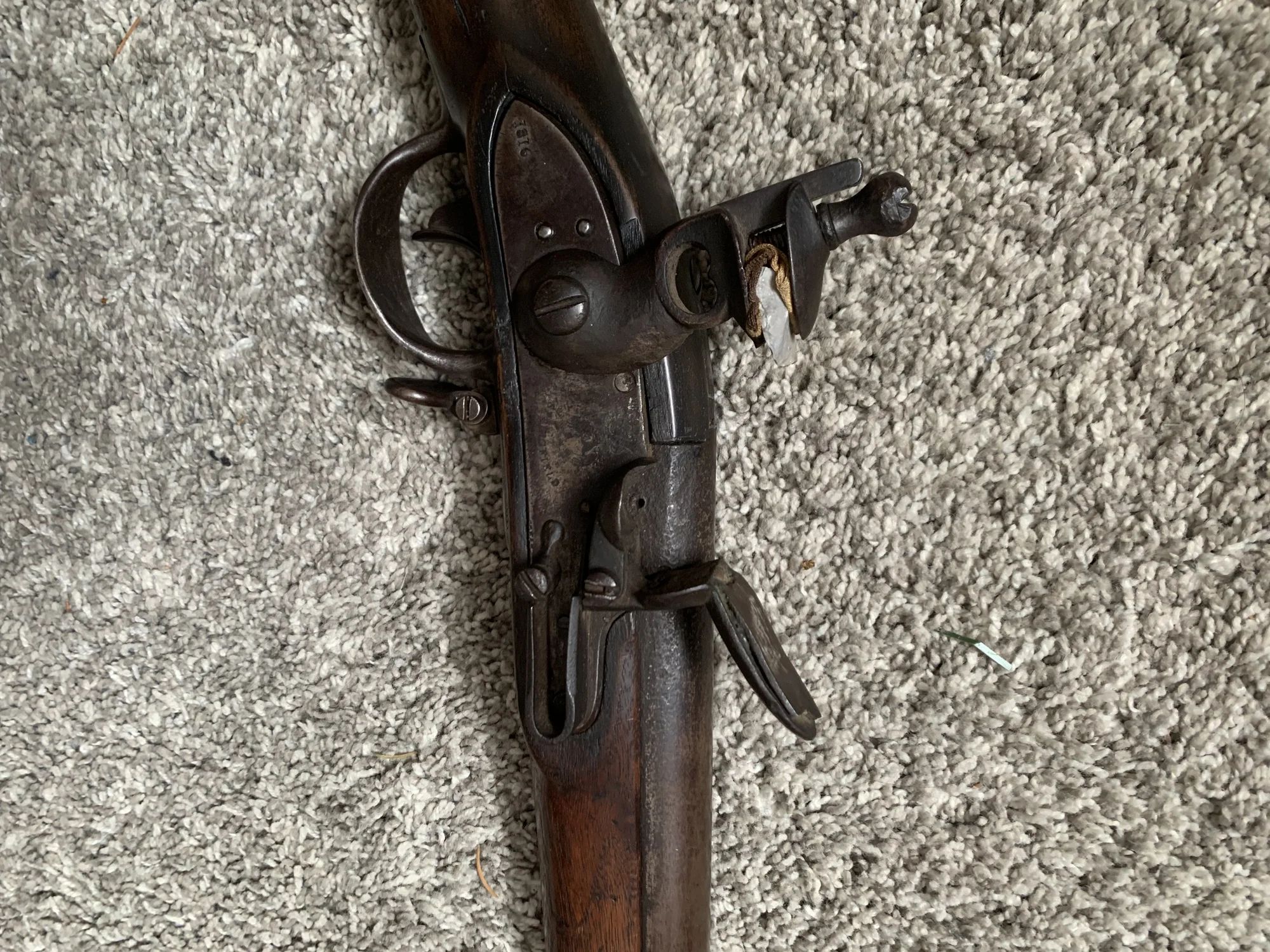

If you could post some photos of the breech end so we can see if its a flint or conversion. Its not going to go off so no worries there.
It's a flint. Air moves past it so I would assume I am stuck using a ball puller as I really don't want to mess with the breech plug. Should I put oil down the barrel to assist on the way out or is that unnecessary given the loose fit?
