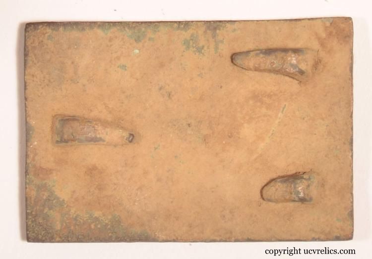

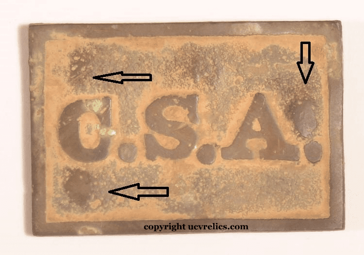

Congratulations on a great find. What you have found is what we refer to as the Atlanta style plate. It's real and has all the tell signs with the prong pull marks on the front. When these were cast, they were cast with the prongs pointed up and before it cooled they were bent down which caused the points on the front as in the photo of one I found years ago. Very nice find and leave it as is. As you can see mine still has most of the dirt still on it as that is Confederate dirt.
