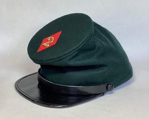

Welcome to the forum @SethJ. Have you had the opportunity to examine any original Civil War caps? Greg Starbuck is well known for his historically accurate caps. Perhaps it might be worthwhile to buy one of his caps, study it and then reverse engineer it. You can purchase historically accurate material from such vendors as Wambaugh & White. I'm attaching a photo of one of Greg's latest projects.

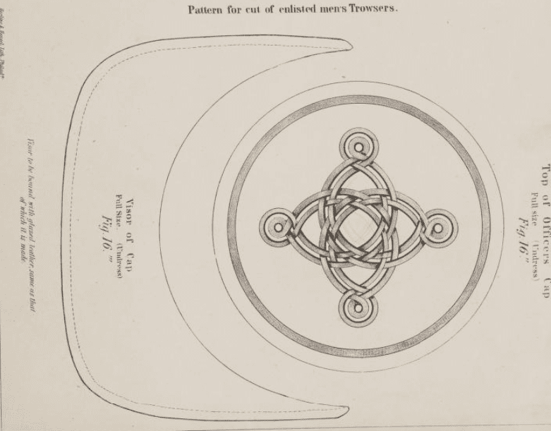

Here's the pattern of the US Marine Corps forage cap from 1859 that you can print off, resize, or compare to your own pattern.

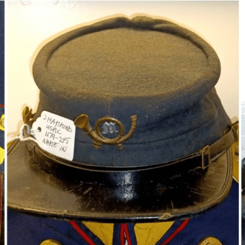

Here's a wartime USMC cap:

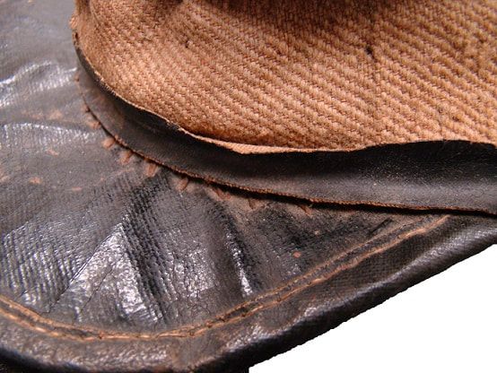

The visors of the crudest CSA caps were either black leather, or something like your attempt, of painted cotton. The simplest are the plain leather visors, with no binding... like this one:

To avoid dealing with leather, the painted cotton visors were paper pasteboard, sandwiched between two layers of painted thin cotton, and bound together with either some black cotton tape (Anderson Orphan brigade cap), or a strip of painted cotton, etc. The binding was sewn with a typical leather stitch (two needles)....

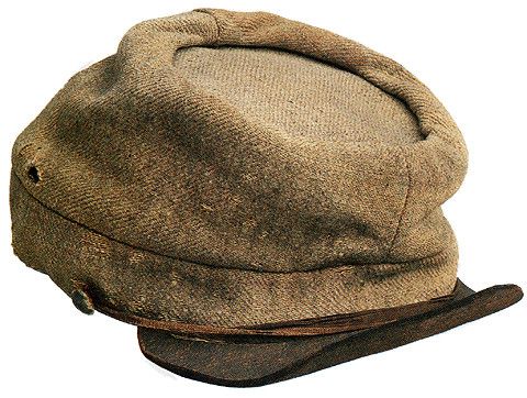

Here's a Confederate army cap of the lower crowned type at the Smithsonian.
