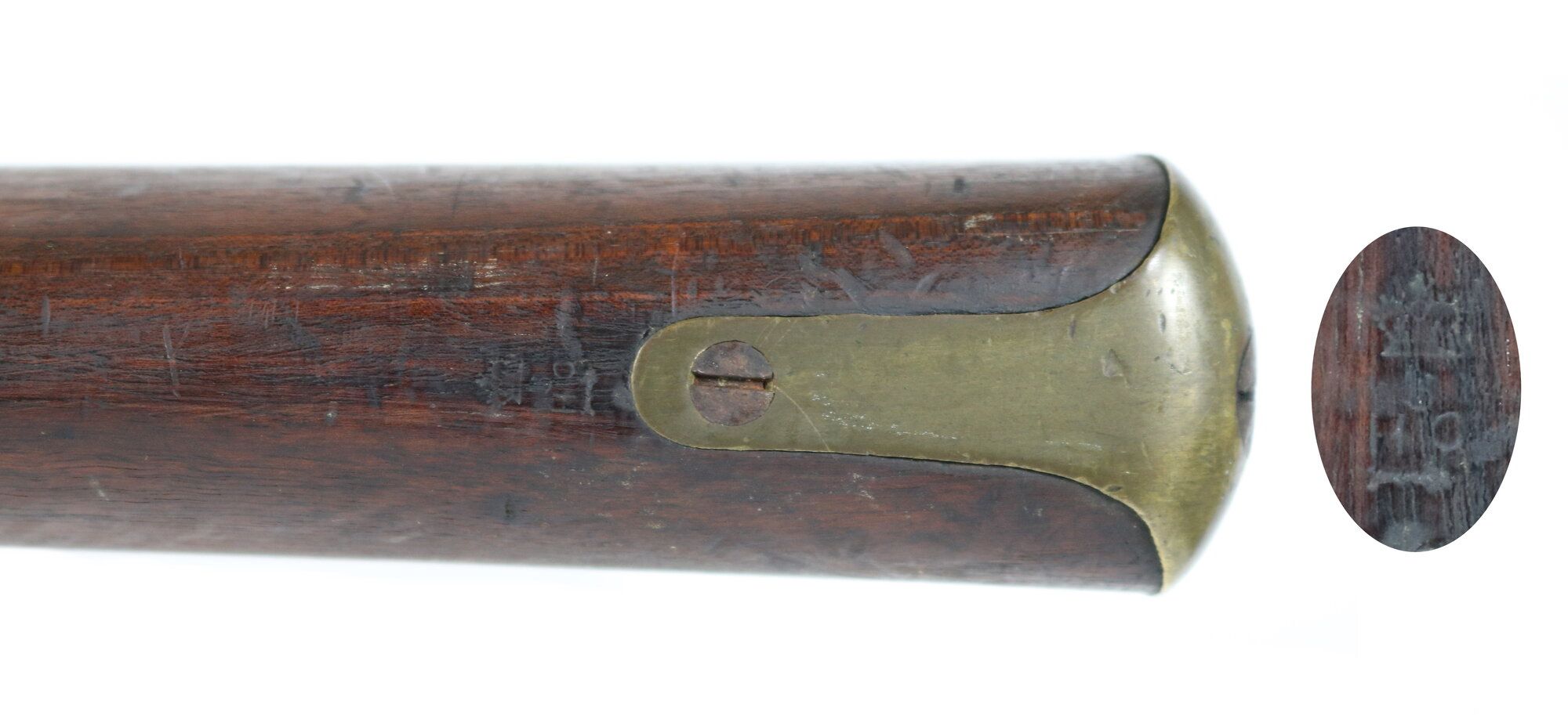

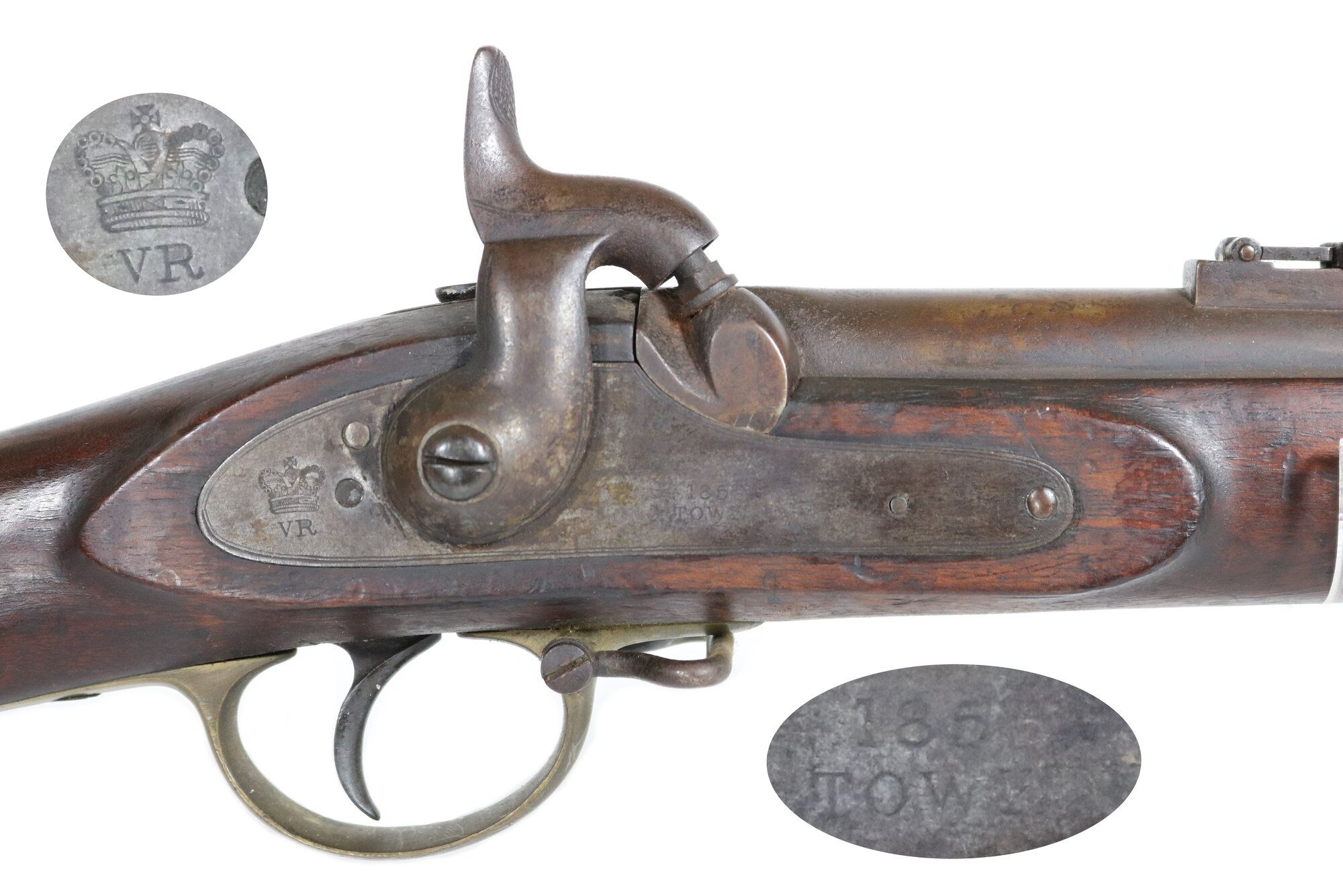

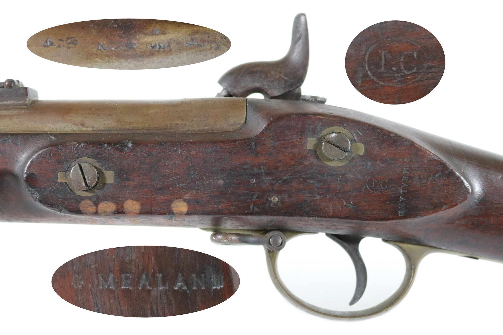

For a type I or II to be considered a Civil war import it needs to have Confederate viewers marks. There were indeed some older government P53s that ended up in America. I have never encountered a legit Confederate type I or II that has sold out of service arrows on it either. CS viewer marked P53 type Is and IIs are exceedingly rare.
This is a Confederate viewer marked P1853 type II from my collection.
OP's musket has no markings to support that it was imported for use in the US during the Civil War. It is however, a nice example of a Belgian made British military P1853 type II. For $200 he did very well.

Confederate imported British P1853 type Is and IIs are found with the SHC arrow marking like the example I shared, and a handful of P1853 type IIs are known with engraved inventory numbers and JS anchor stamps. The inventory numbered guns are without doubt from the second Confederate government contract with Sinclair, Hamilton & Company which was enacted in October 1861. The SHC arrow mark was quite possibly used on the first contract, of which little information is known. One can assume, however, based on records from the following contracts, that it was likely for 30,000 guns to be delivered over 6 months, which should put the origination time of the first contract around April of 1861.
I would caution anyone who doesn't really know what they are looking at to proceed with caution if looking at purchasing an allegedly Confederate type I or II. Legitimate examples are among the rarest of Civil War imports; at this point I think it is safe to say that there are probably only around a dozen examples known at present. The overwhelming majority of type Is and IIs are plain British military guns with no Civil War affiliation at all. And then there are boatloads of Indian/Afghan/Nepalese type IIs on the market as well.
