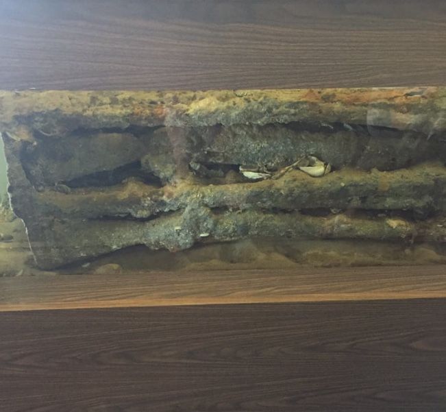

At the Museum of Coastal Carolina, 21 East Second Street Ocean Isle Beach, NC there is a unique exhibit.
This is a case of Enfield Rifles, complete with bayonets & slings recovered from the 1862 wreck of the blockade runner Modern Greece.
