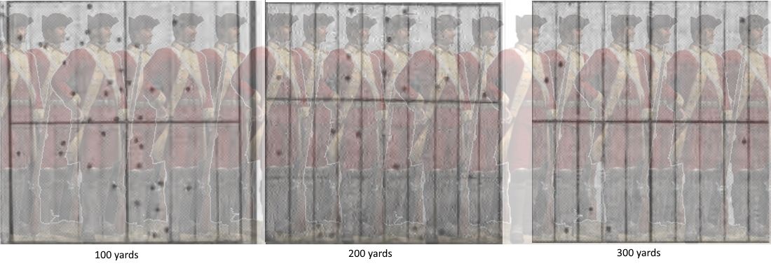

Now, as it happens I found an online source which actually shows the test cards in Fuller. What I'm going to do is to overlay a double line of infantry on the smoothbore ones, assuming that the men are 5 foot 8 inches tall (which is 17/18 of the total height of the 6 foot cards, and which is the average height of an adult American male as of the Revolutionary War - which is when I have data for it).
As you can see, at 100 yards the men are completely peppered. In fact, there are 17 hits on the legs, 12 hits on the body, and at head/neck height there are 9 balls which have a good chance of hitting.
So out of 50 shots fired here there are more than 30 hits (60%).
At 200 yards there are about 9 hits on the legs, 8 hits on the body, and 2-3 balls at head-neck height - so about 20/50 (40%)
At 300 yards, there are 4 hits on the legs, 2 on the body and 1 at head height. So 6-7 hits out of 50, or about 2 in 15 (13%).
Since 13% is still more than ten times as accurate as Union troops at Gettysburg, I would say that the theoretical accuracy of the smoothbore musket allows for the possibility of effective firing at 300 yards.
If you and 900 friends stood in a two-deep line 300 yards away from 900 men shooting at you with smoothbore muskets at this level of accuracy, each volley would hit more than 100 of you. I think I'll decline to join you...

That's roughly in accord with what I get by putting the Fuller plates on the tests.
It's actually interesting to contemplate that against a target consisting of a couple of dozen files of infantry that's a few hundred yards away, you have an interaction of the expanding spread of the musket balls and the distance - it's like you have a circle which expands at a linear rate but where the circle centre keeps going down at an accelerating rate.
It's only once the circle is entirely below the ground that hits become actually impossible.
