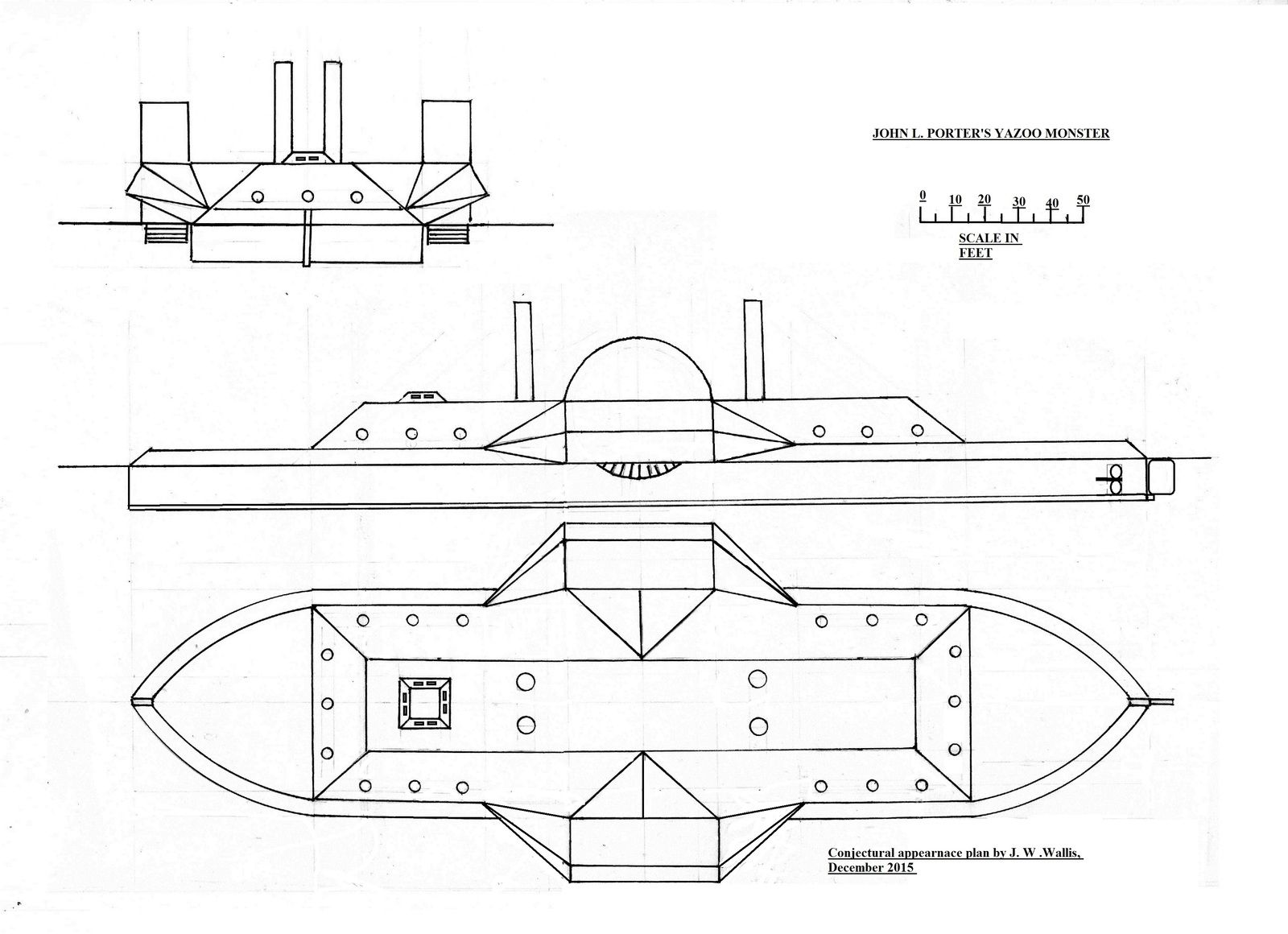

Hi Bil: you wonder if a Nashville would have the room and boiler capacity for a hybrid layout. Do we have only Porter's (USN) estimate on the length of the "Monster"? Another question is whether they would have just dropped in a parallel section amidships to get more room which seems a characteristic of Porter's (CSN) designs. With a hybrid their coal consumption would have been pretty high. I also wonder if Brown fished up the guns from the Van Dorn and Polk below the obstructions at Yazoo City. There should have been two guns from Van Dorn, I'm not sure what Polk had left or whether some of her guns were among those abandoned in a battery upriver. Has anyone heard of any attempt to salvage the machinery from the Van Dorn and Polk?
The Yazoo Monster dimensions 310ft x 70ft are in proportion an almost exact match for the dimensions of an enlarged "Nashville" as are the two sidewheels. These would have been 40ft diameter powered by " two standard western river type engines" . These certainly would be recovered from an existing vessel, and it might just be possible to identify which one by a process of elimination. The two 8ft screws are a strong indication that the machinery (and boilers?) for those were originally constructed for Arkansas sister ship.
Van Dorn had two guns ,Polk seven when burned, CSS Mobile had four and the Livingston six. I drew the monster as I thought John L Porter may have done ,as an enlarged Nashville for the reasons explained above. I do wonder though if I. N. Brown may have constructed her above the knuckle to his own ideas given the constraints he was under at Yazoo City.
John are you sure about these numbers of guns? I ask because a number of the guns from the CSN gunboats were placed in batteries ashore below Fort Pillow. A couple were shipped up rivers in Arkansas and Lt. Stone saved at least one by disobeying an order to leave them all. I know that the Van Dorn still had two guns when she arrived below the obstructions. I have no numbers on how many guns may have been aboard the CSN boats.

As you know, as we have discussed this before , I have struggled with the concept of this vessel for a long time
By coincidence I had just completed these drawings of the monster. This before. This is what I think John Luke Porter supplied to the builders

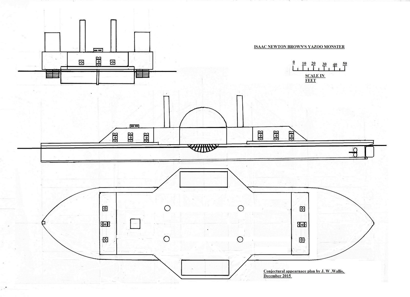

However, because Isaac Newton Brown was struggling with shortages of all descriptions , and because of his experience with Arkansas and his proposed conversions, this is what I fell the vessel may have been like if completed.
But I am fully prepared for you to tell me that is rubbish, and go back to the drawing board !
Incidentally I feel that CSS New Orleans would be a far better name than out previous thought, CSS Yazoo!
Nice work, Rebel. I agree with you that Brown would have wanted more guns fore and aft if the ordnance and space was available. Do you think that the outboard corner guns would have been on rotating mounts and serve on the broadsides too?
Hello George,
Excellent thoughts. If the YM did have a hybrid machinery arrangement I agree that they would have used the Tennessee's machinery. It was the only screw propelled machinery available at YCNY that I am aware of besides the Mobile's. I just haven't found any documentation from the builders or the CSN Dept. that such a design change occurred. On another note, I forget the precise source, but the original engineer of the Arkansas knew how to properly operate the engines. His replacement was not competent and it was his errors, not the machinery itself, that lead to the loss of the Arkansas. Supposedly her engines were quite sophisticated and required careful management.
All the best,
Bil
Hi Bil: do you suppose that Brown was informed that none of the available side-wheel machinery available was powerful enough for this size vessel and Brown made the decision to add the twin screw propulsion?
