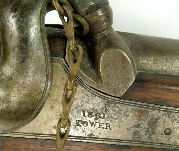

They varied per manufacture. Most are makers marked and most didn't have CS or CSA a few did, but that is different when it comes to CS swords. The majority of Confederate muskets were marked Tower (England) some had marking from CS inspectors that were in England but NOT as CS in case the blockade runner was captured.
The Richmond Arsenal is one of the few exceptions I mentioned above but not all of them that came out of the Richmond aresanal had CS marks. Also, here is a marking on a CS import from England and the anchor over JS is the CS inspector who was in England accepting this arms for the CSA.
