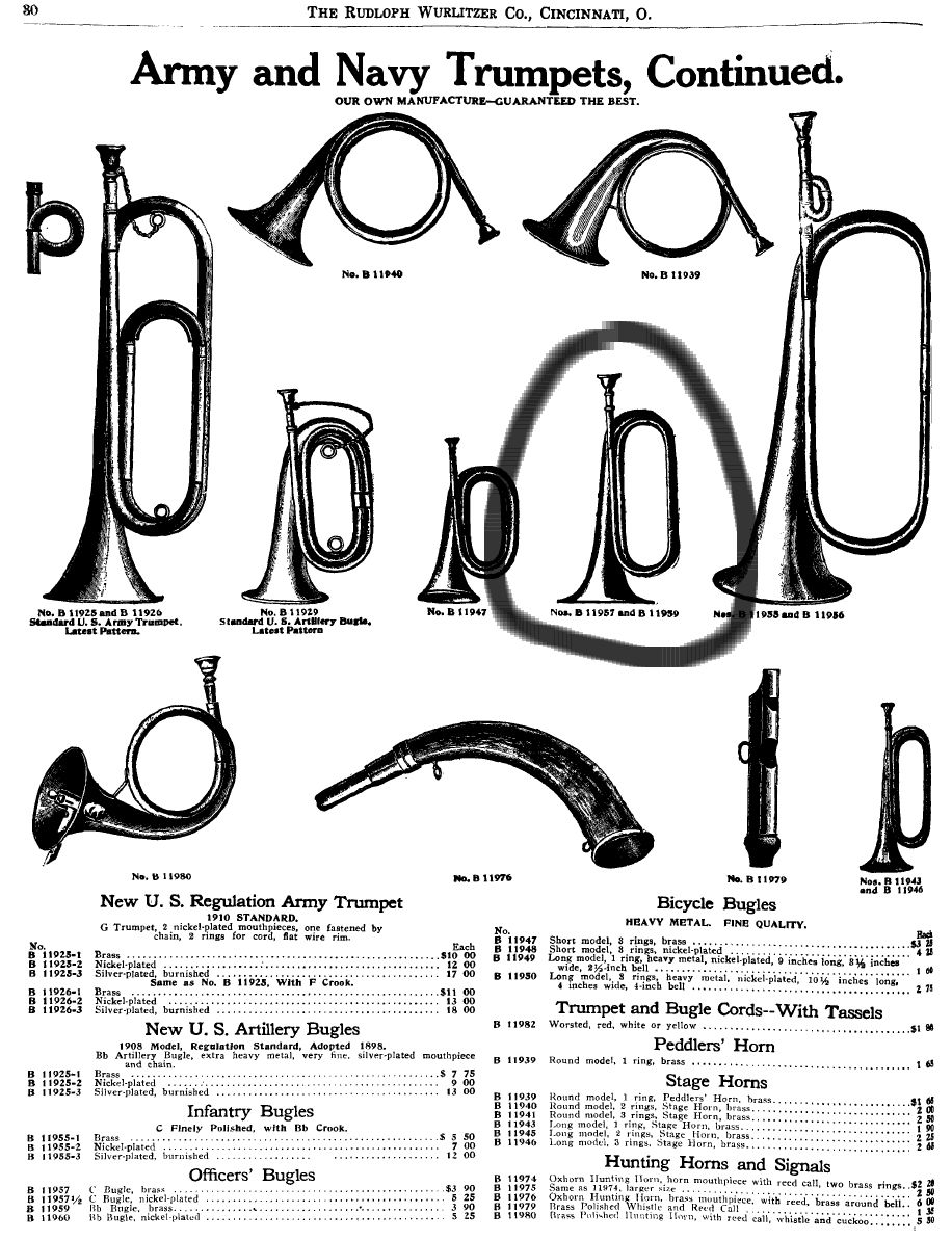

It is not a Civil War bugle. It looks to be an Officer's bugle made after the Civil War. These are smaller type, double or triple coiled horns designed to be played by officers usually found in the key of B-Flat or C. They are not to be confused with the M1894 bugles that were issued during WWI for infantry. I've attached a catalog from the turn of the century that has this horn circled
