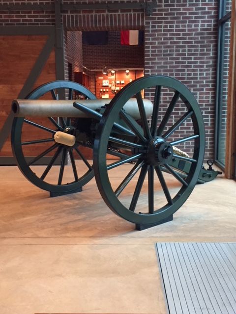

Drezac, nice photo!
There were six types of James' Rifled Cannon; the rifled 6-pounders were just one of those. The other five types all had the profile of the 3" ordnance rifle. Here at Shiloh we have twenty-one of the rifled 6-pounders out in the field and seventy-five of the James rifles with the ordnance profile. We have the largest collection of James rifles including three rare ones made of steel.
The photo is of an equally rare Type 2, Series 1, of which only five were ever cast. (These five had a seven-groove rifling pattern).This particular piece was captured by the Confederates at Shiloh and recaptured by the Union during the Battle of Corinth. There is a light inscription on top of the barrel "Captured Oct 4 1862/Corinth, Miss/by/1 US Inf" It is one of the park's most prized artifacts and it sits only yards from where it was retaken.
Drezac, nice photo!
