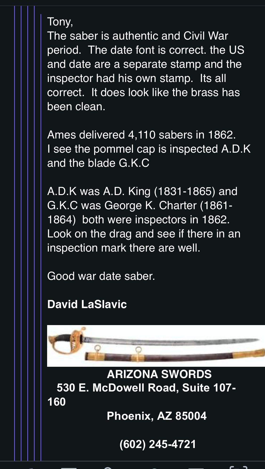

I contacted David at azswords and he got back to almost immediately.
Great guy , thanks to all and especially bayonet for the contact link to David.
I attached his answer in the attachment.
Thanks to everyone who gave input .
Tony

Scooter I thank you sir for all your time and effort .

Yes it is. I'm assuming he knows what he's talking about.
Usually. No one knows everything. I did pick up a couple items from Dave that he had misidentified, but to my advantage because in those two cases I'd already had experience and the knowledge to know what I was looking at. For everything else, I'm sure he knows much more than me.
Hi Bob, I agree 100%.
It just seems to me for him to be so sure of his evaluation that he must have documentation to back it up.
But who knows?
Well said, and I completely agree. I am going to pass and hopefully find another.

Unfortunately some people don't take questioning their knowledge well.
Yes the date fonts have everyone thinking it's been restamped.
Hard to figure that one out .
