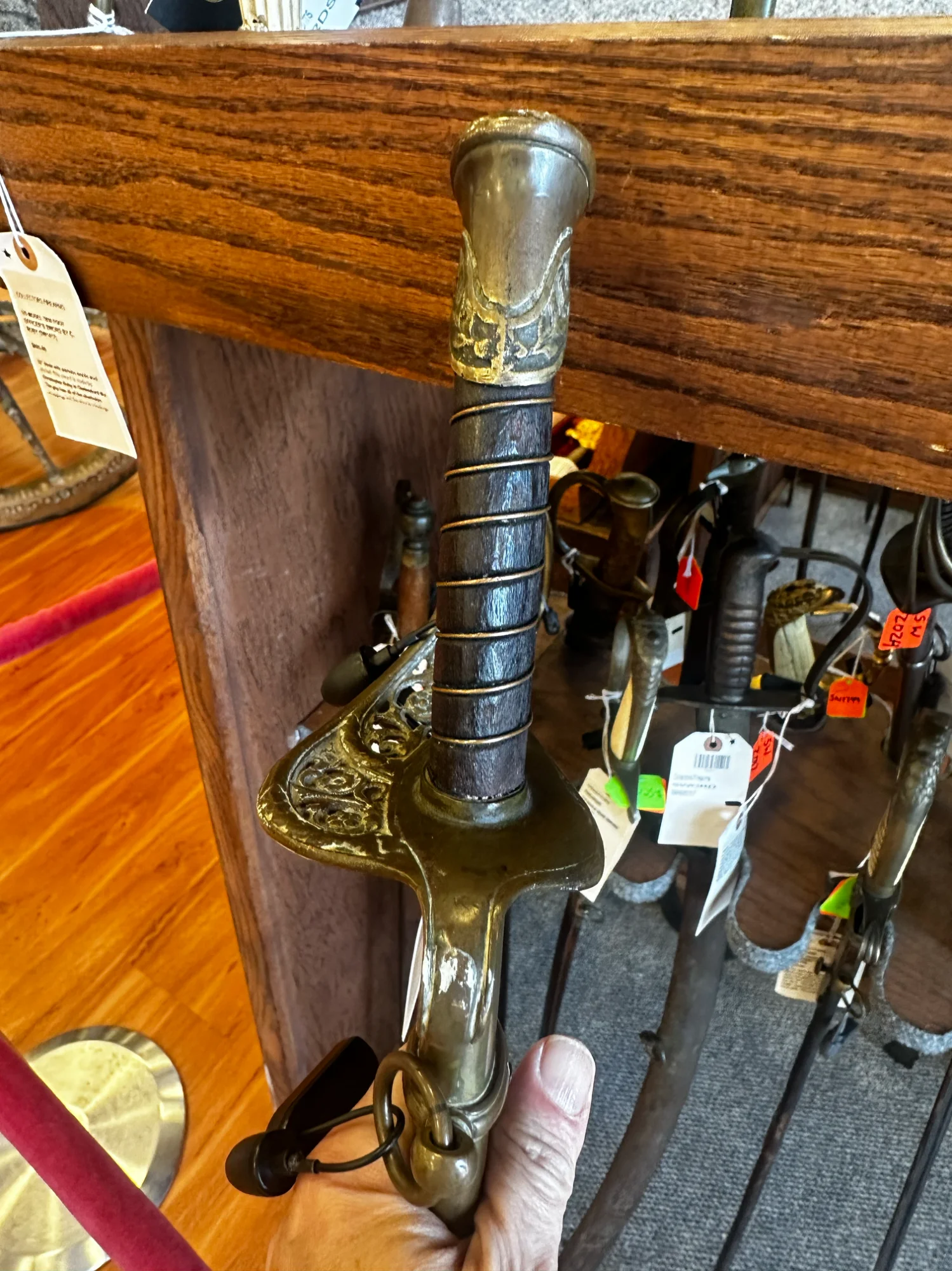

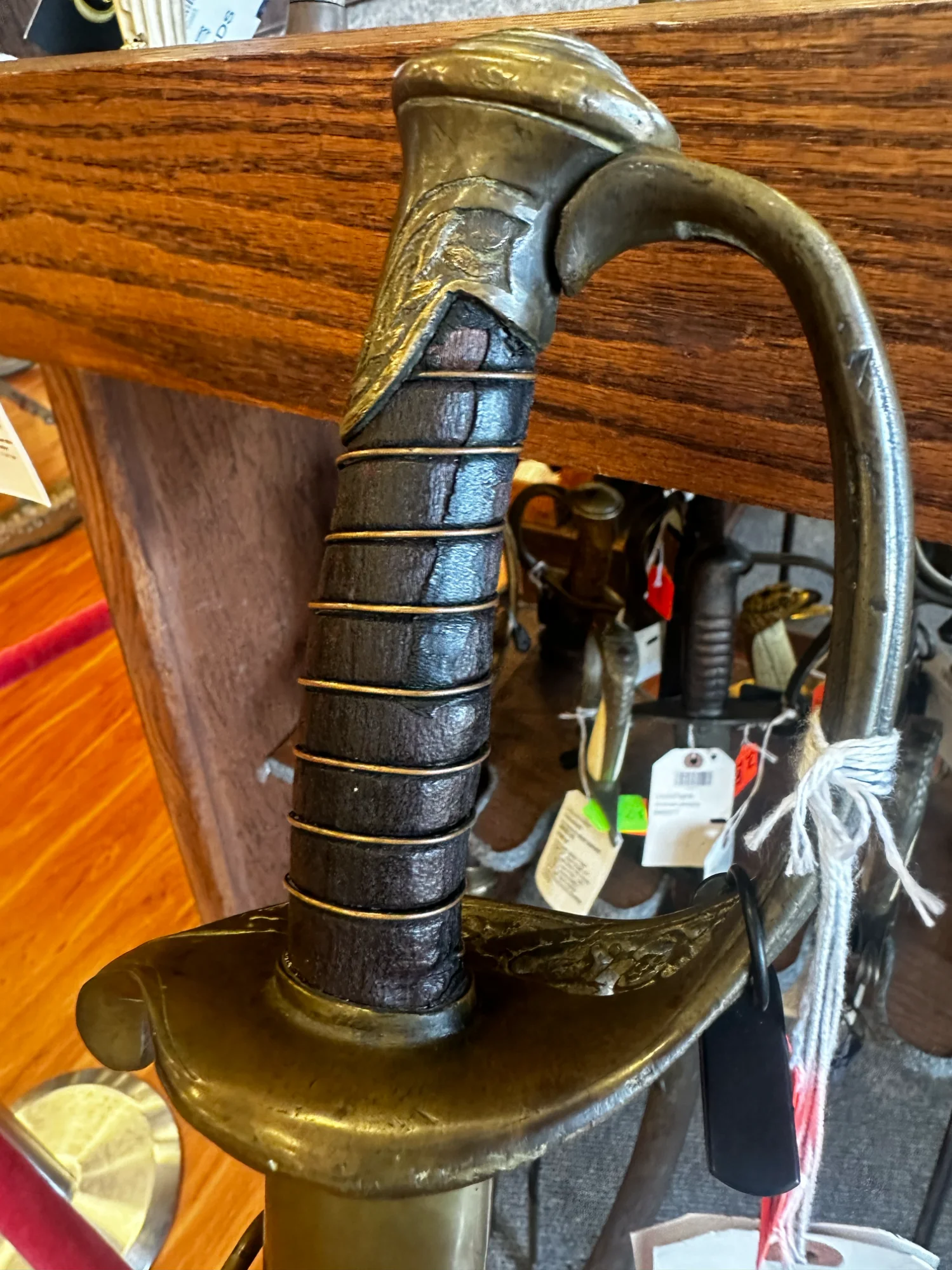

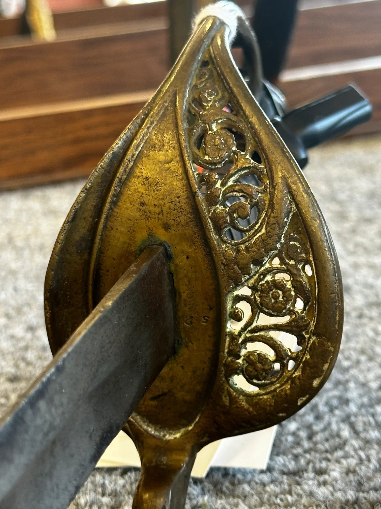

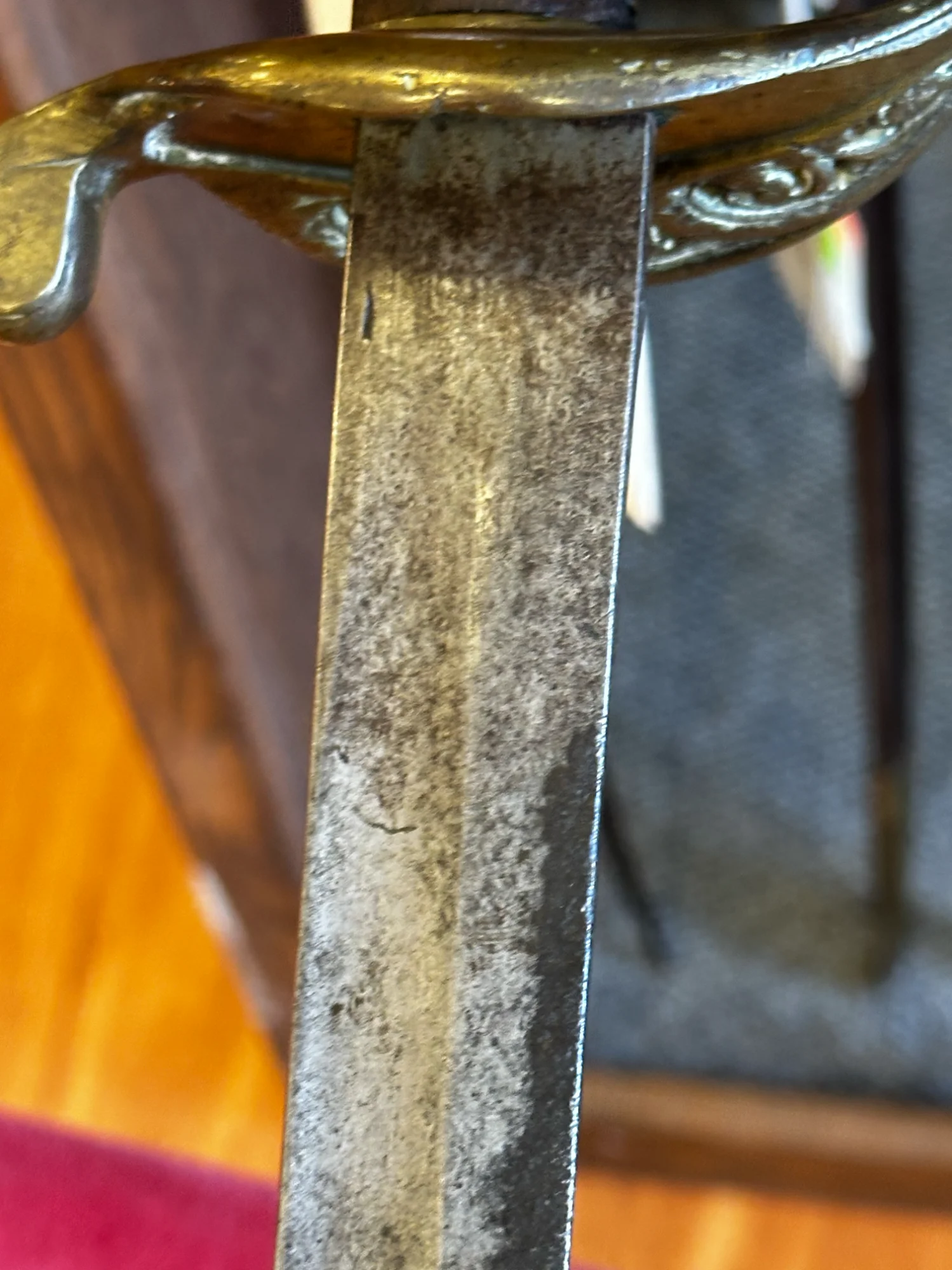

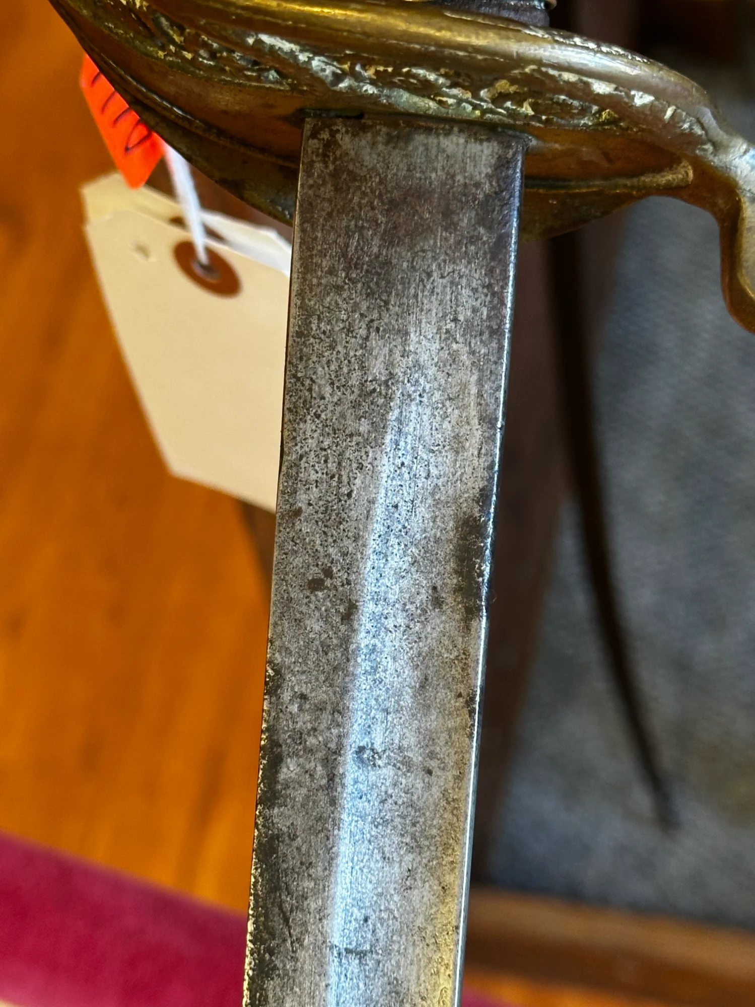

Hello all. I hope to make use of the collective genius of this forum again. I'm looking to add a line officer's sword to my minuscule collection. I came across this one in a large and highly regarded store from whom I've bought in the past, but I think it has a blind spot with Confederate weapons. @Lanyard Puller and others saved me from an embarrassing an expensive mistake.

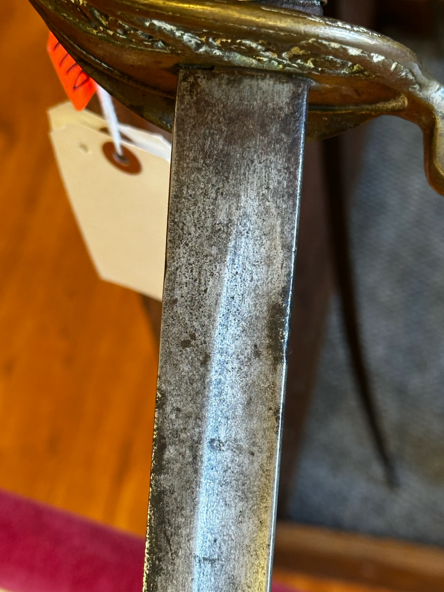

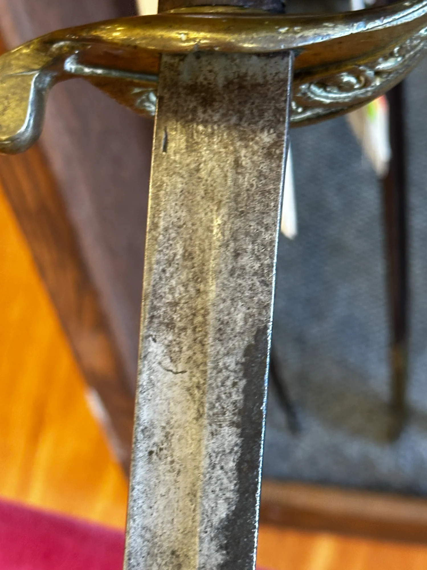

These are images of what it advertises as a Boyle and Gamble Confederate sword. I note that it lacks etching. Okay, it may be a cheaper version? The hilt does not resemble the B&G image @Lanyard Puller posted here -- but it looks sort of like the hilt on the B&G sword @LtDan posted here. I also did not see any evidence of the blade defect that both of those gents mentioned.
Thanks in advance for any thoughts. Soon I'll post a few pics of what is being advertised as a possible EJ Edwards blade.

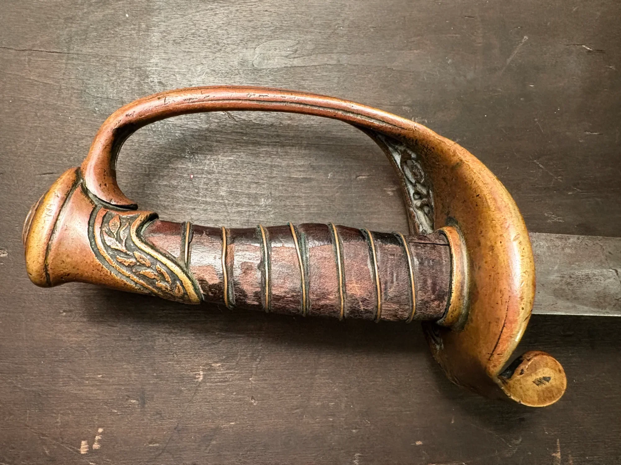

It appears to be a correct B&G foot officer's sword to me. I'll attach similar photos of my sword for comparison. I do not know if all Boyle & Gamble foot officer swords had etched blades. There are certainly many swords without visible etching......some being worn or cleaned off if it had existed. I do believe the Boyle, Gamble & MacFee foot officer swords were not etched.
I do not know of any recent reference books for these swords. You may want to find a copy of William Albaugh's "A Photographic Supplement of Confederate Swords". It was first published in 1963 and updated in 1979. I'm sure there's a lot of newer information out there but I've found this to be a good basic guide.

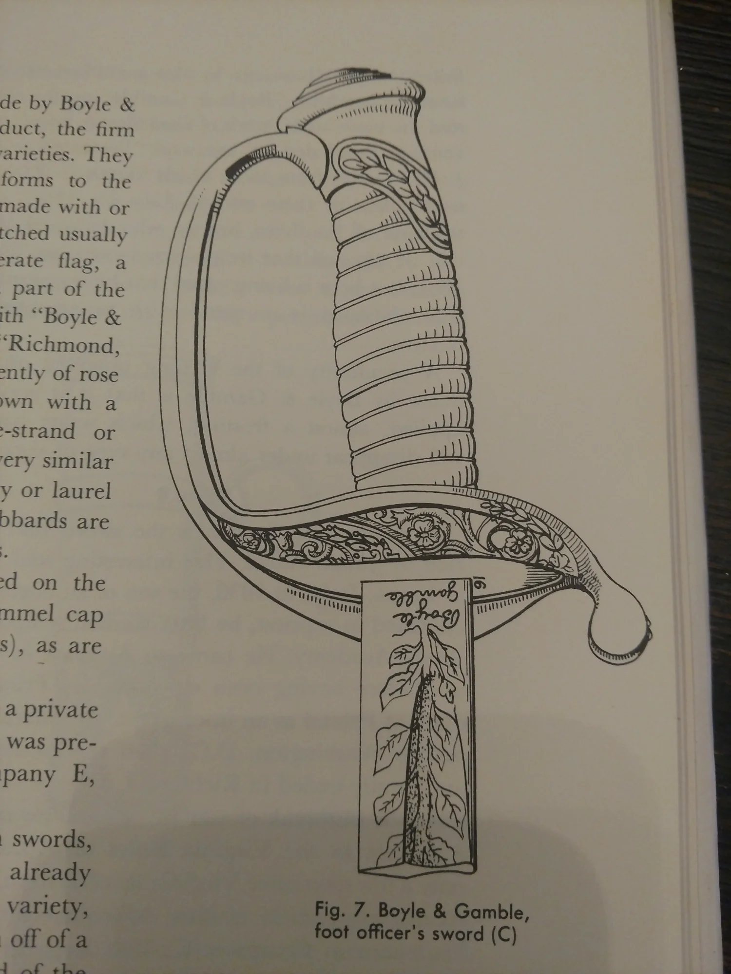

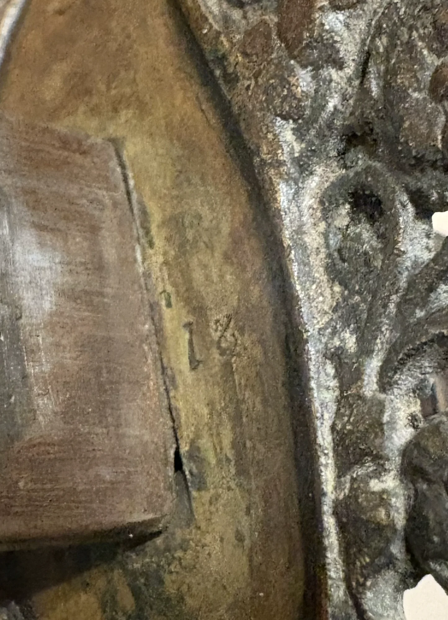

I think I can see part of a flaw line in your photo showing the left side of the blade. These flaws are not always as visible as the one on my sword. Also, I see the number "52" stamped under the guard. One of my photos shows the number "21" on my sword. Albaugh notes these numbers are found on "practically all swords by B&G......and are on the pommel, blade tang and underside of the guard. The guard is the only visible location without disassembling the sword". I'll also include a picture from Albaugh's book showing pommel styles. He shows 4 different styles. Hope this is helpful and good luck in your search. I'm glad to see some posts regarding confederate swords.

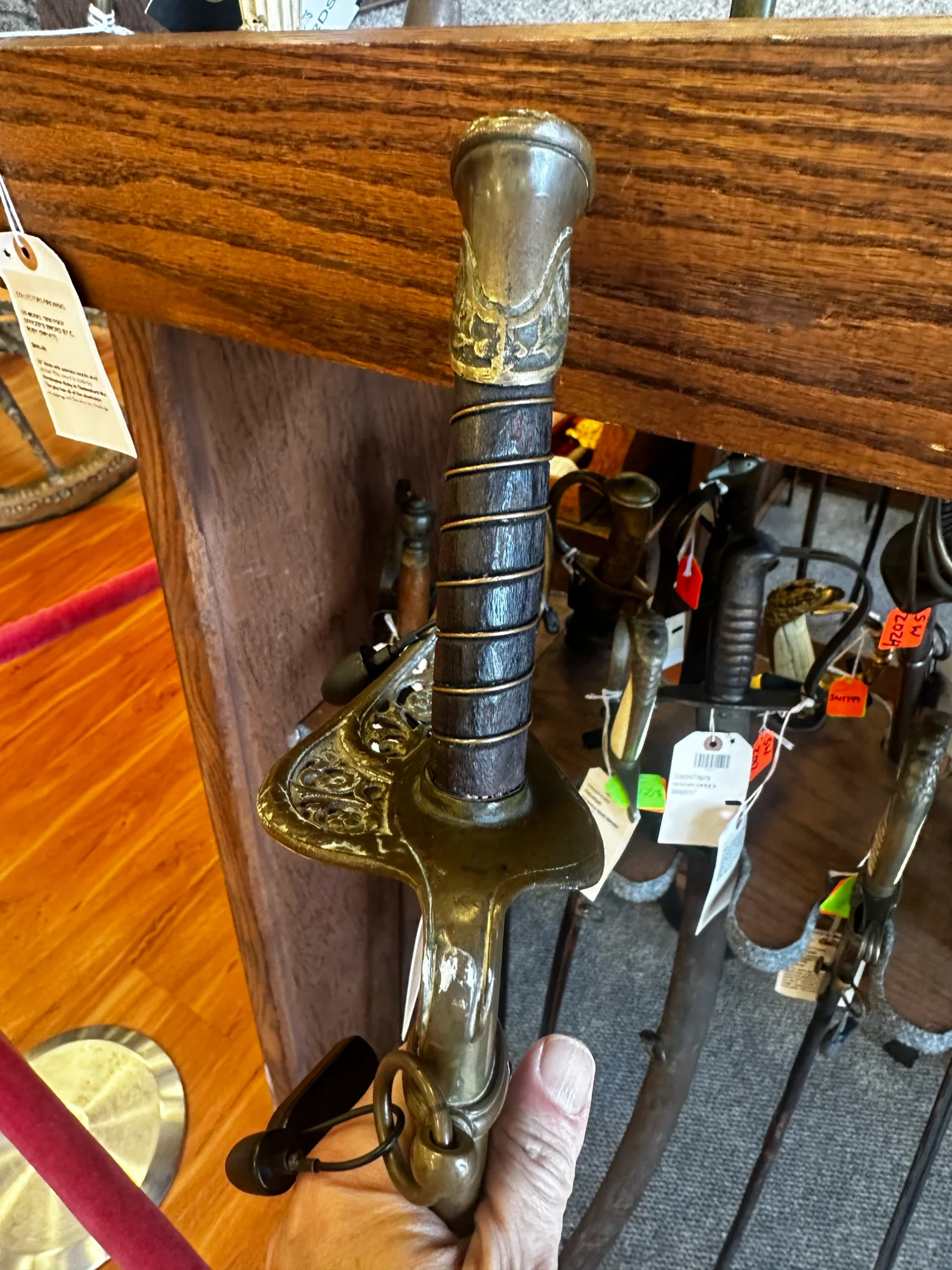

Looks correct to me, too. The scabbard in the first photo does not look like a B&G product.
