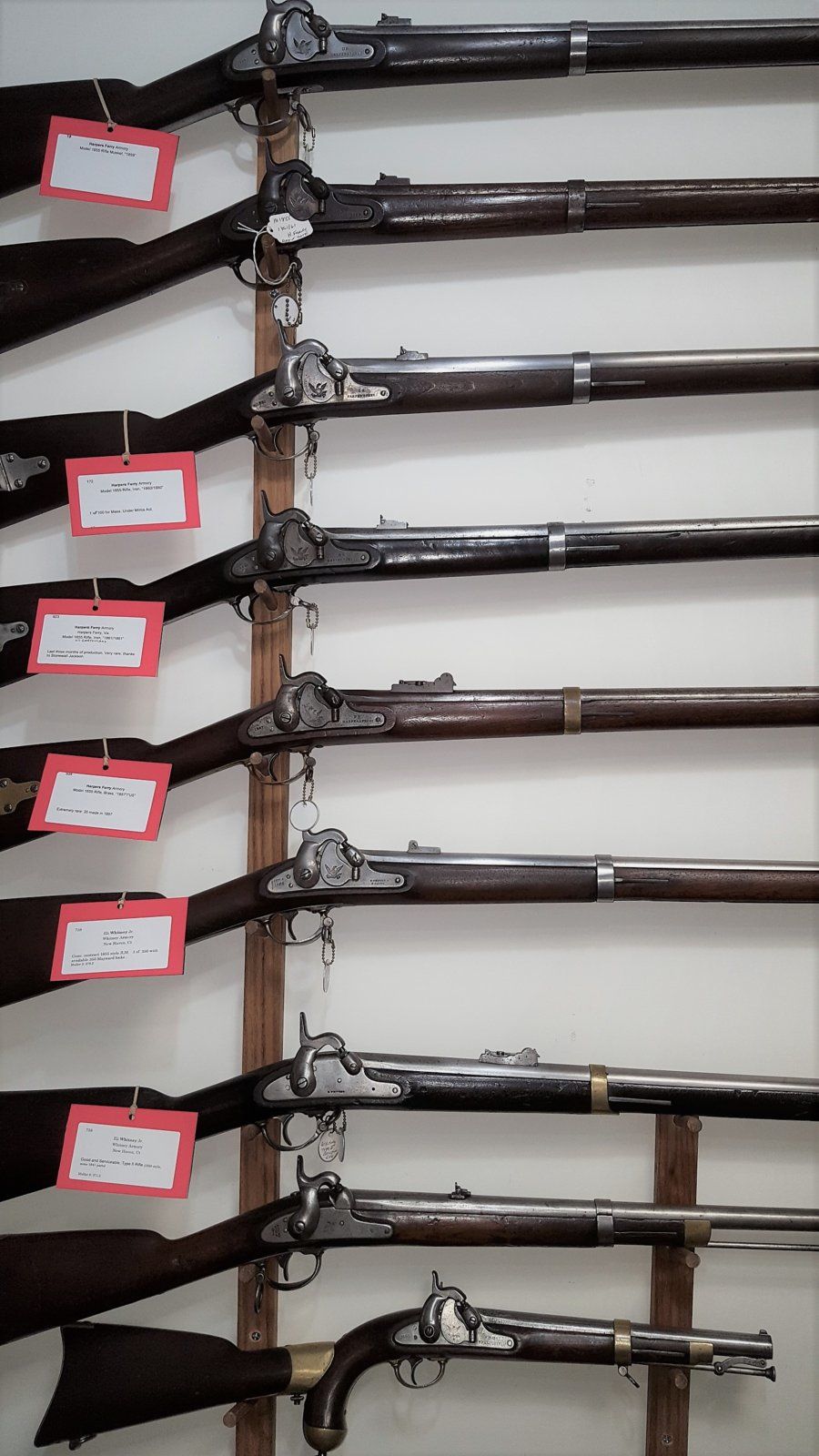

There are at least this many variations, and I'm still searching for more.
